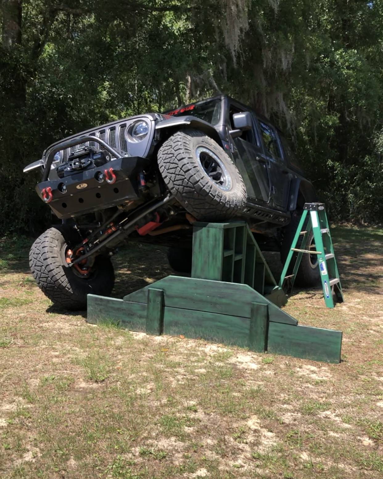

I want to share what I know about the oem rear sway bar……it does not reduce or stop flex in any way. On mine it hits the track bar frame brace and makes a hell of clunk when passenger stuffs, on driver stuff it hits the frame. Here I’m twisted up and I’m doing my best Bronco impression, hanging a wheel, to show my point. The shock is the limiting factor here. The factory sway bar will hit the frame and stop, but it will continue to twist, not limiting anything……….this is what I know for a fact on my rig, OMMV…….
Of course I’m always looking for a better mouse trap, but so far this is it for me. I finally rode in a Jeep with a rear anti rock but didn’t like it in curvy highways we have here. So the search continues………..
"in any way" likely doesn't apply when the jeep is at a decline and the rear is light. If someone has access to an RTI ramp and wants to test backing up with the rear connected vs disconnected, i'd love to see it
also, you've got a rear wheel in the air in your pics. Is it possible that rear wheel would be touching the ground if the rear bar was disconnected?

that hasn't been my experience from wheeling multiple jeeps and a land rover discovery with the front and rear disconnected. Disconnecting any sway bar reduces body roll resistance, but like zandcwhite said, none of them magically flopped over from not having a rear bar connected, and you will get more flex with the rear disconnected when the jeep is at a decline. When all the weight is on the front, you'll run out of front spring stiffness before the rear does, and the rear will be pushing your light back end over. I'd like to see a comparison of rear connected versus rear disconnected backing up an RTI ramp, simulating flex for stability going down a technical trail
You aren’t fighting for traction going down anywhere near as much as you are going up. But you do you man.

No, it’s hanging in the shock.

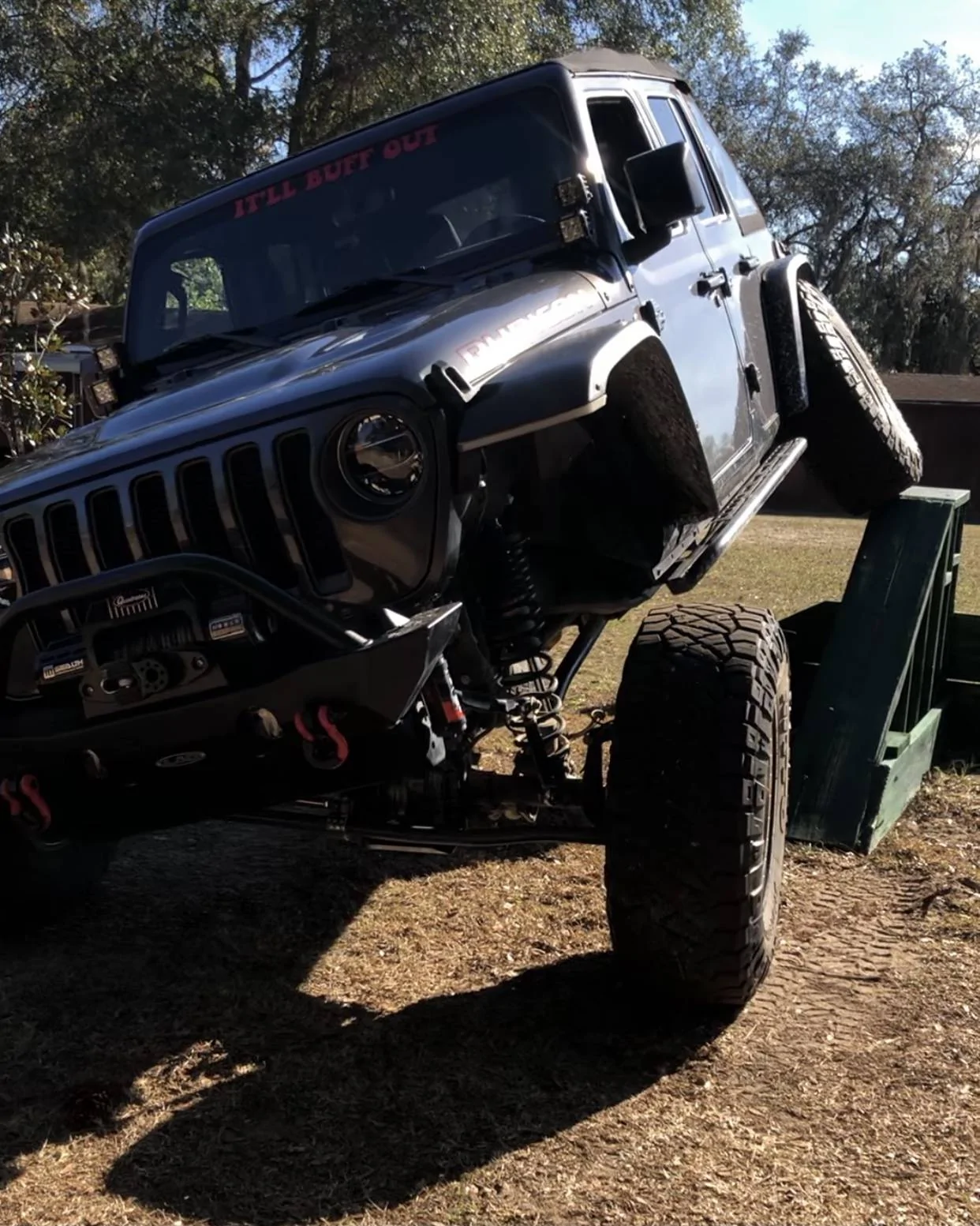

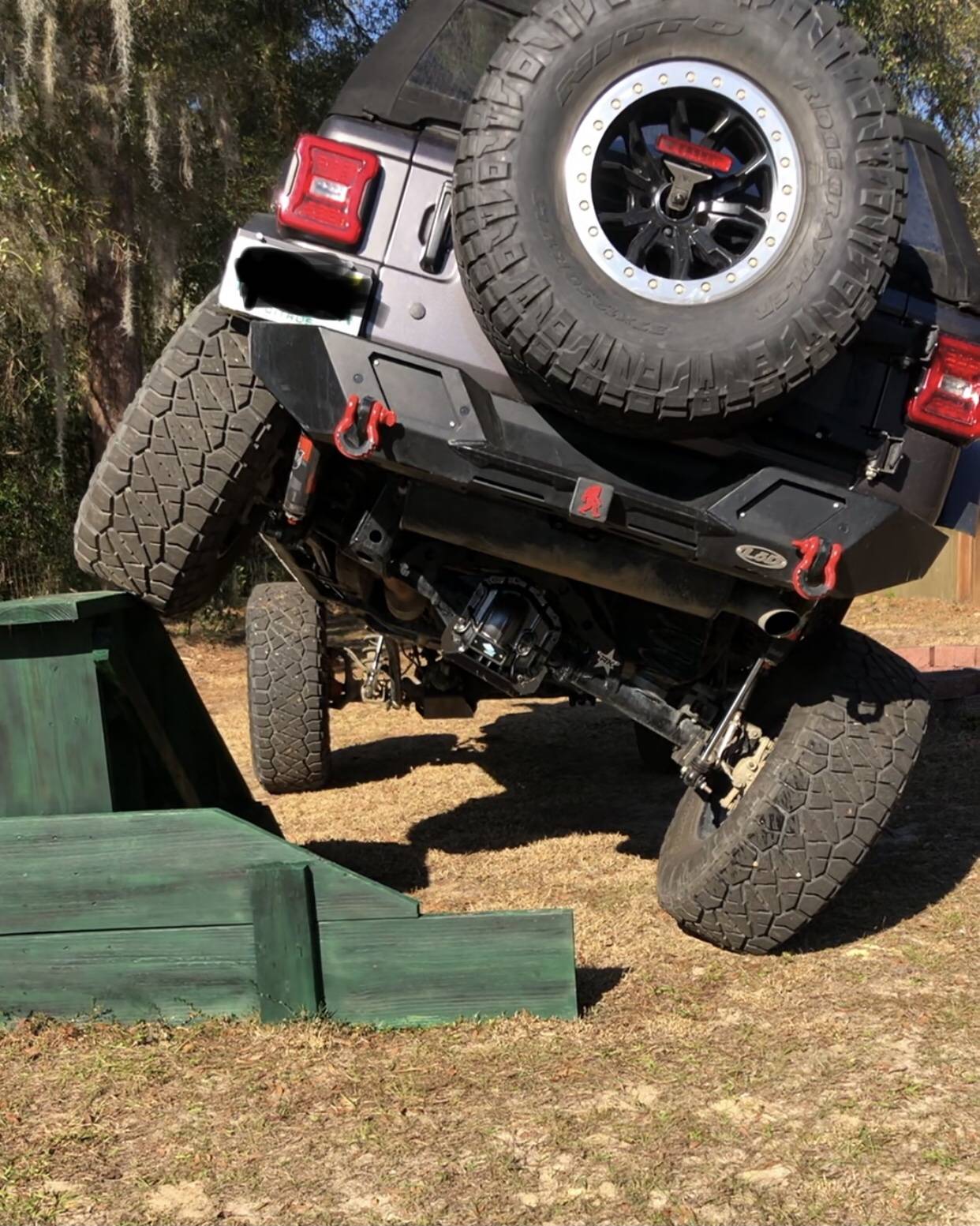

Hooked ……..
Jeep Wrangler JL Hellwig sway bar and offroad... Disappointing. 63663D08-CE4B-4929-90A3-28FFC1ADCF6C
unhooked……
Jeep Wrangler JL Hellwig sway bar and offroad... Disappointing. 17C65577-B9C2-4BF5-8DFE-59580D749C49

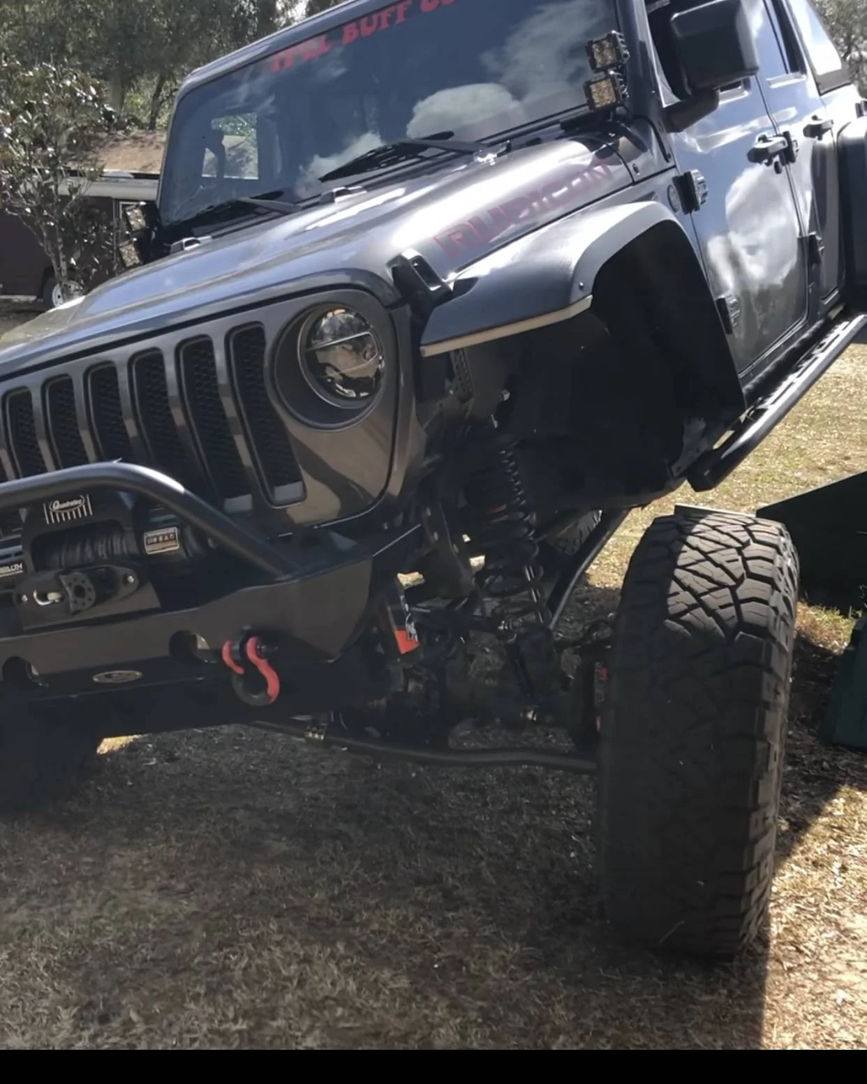

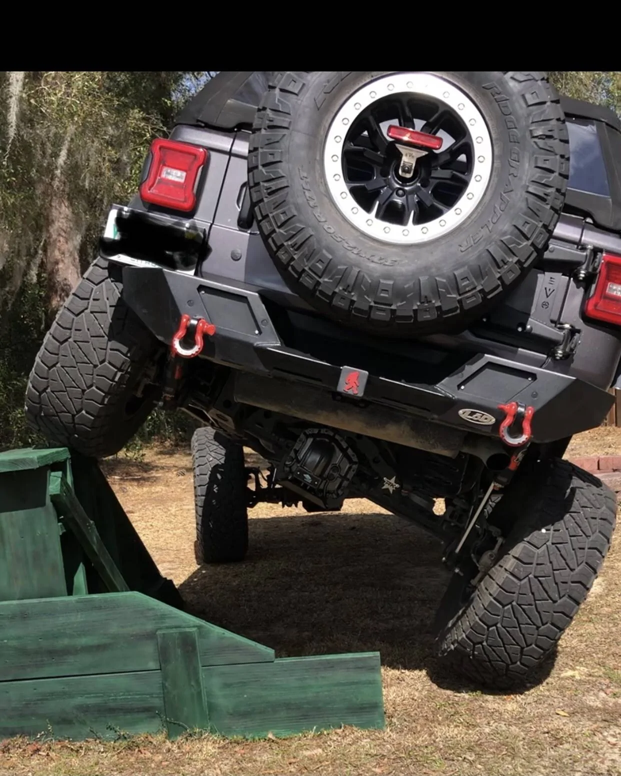

Hooked ……..
Jeep Wrangler JL Hellwig sway bar and offroad... Disappointing. 8E167655-F374-4752-B732-B2844E89C4DF
unhooked……
Jeep Wrangler JL Hellwig sway bar and offroad... Disappointing. 871A1795-7074-4707-8C0C-1FBE337EB35E
If there’s a difference, it sure as hell not worth disconnecting for, IMO…….

With it unhooked is it even close to lining up when under flex? That will be the interesting point.
