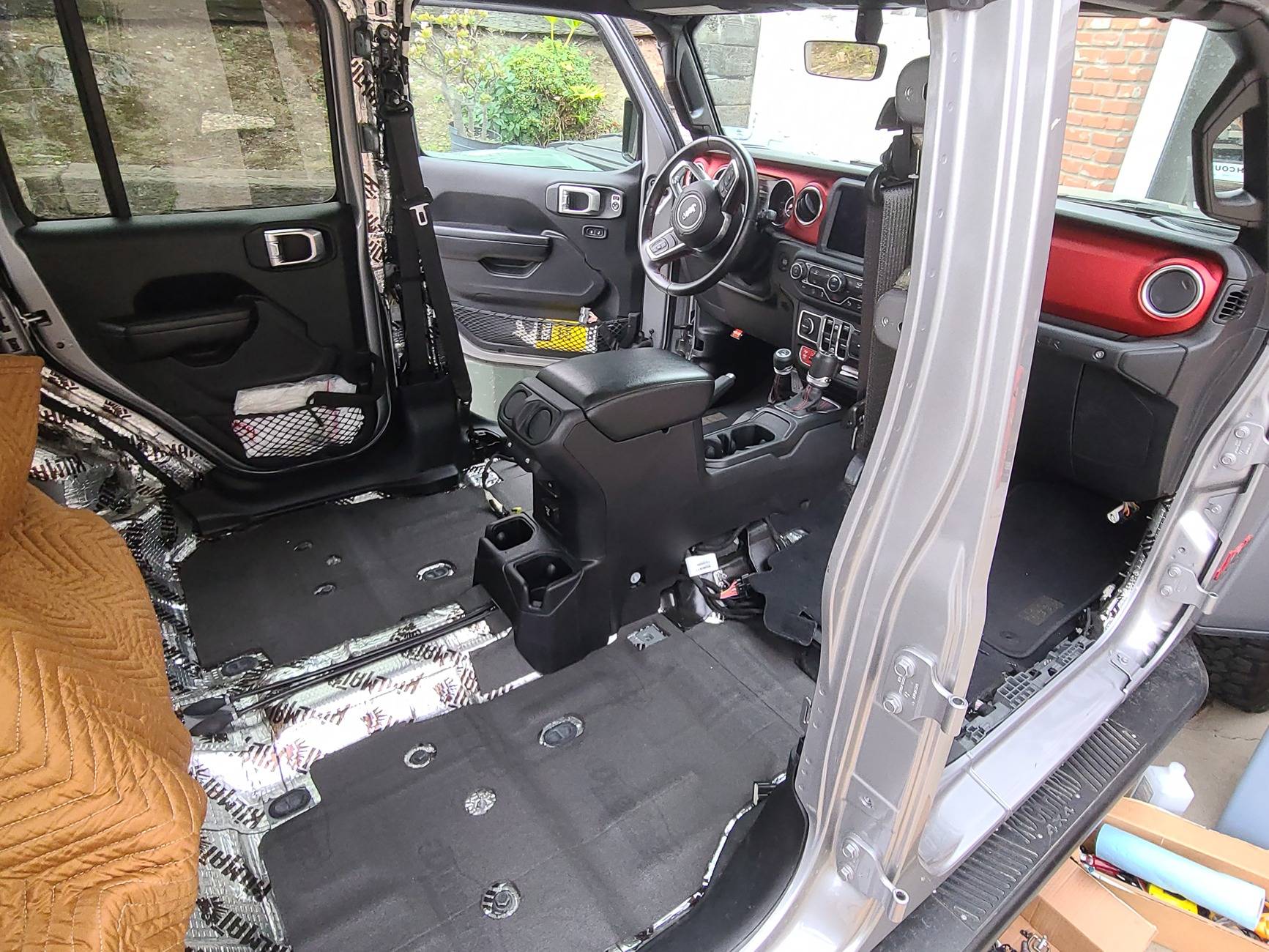

I did the tub of my JLUR back in 2020. Kilmat throughout the tub, then Dynaliner on some larger areas. I did one door. Need to get back to it and do the other three. The doors matter.
Jeep Wrangler JL Headliner Sound Deadening 20210112_105258[1]
Jeep Wrangler JL Headliner Sound Deadening 20210119_155840[1]
Looks like that would help a lot but looks like a big job!
