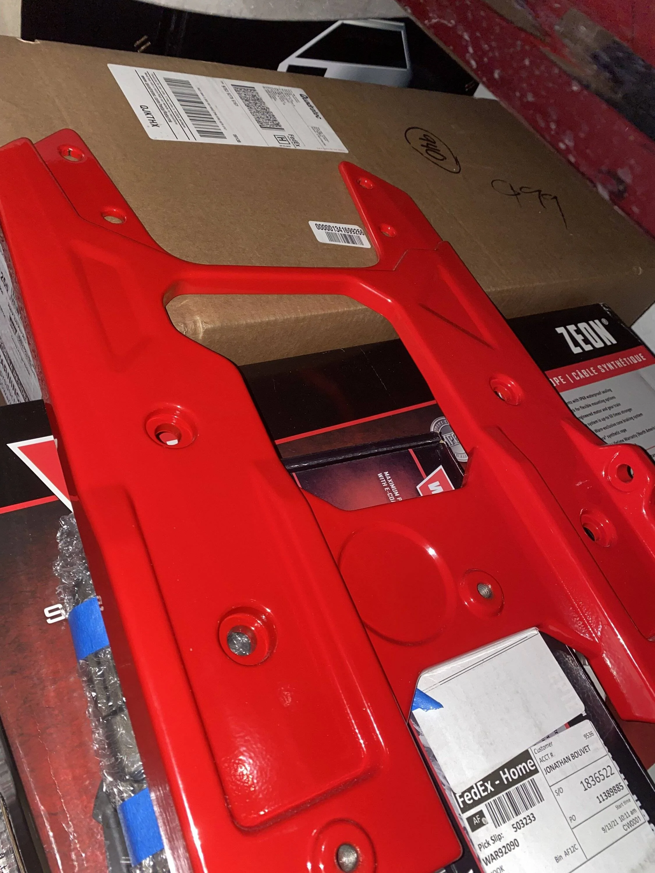

Had my mopar tailgate reinforcement powder coated to match the firecracker paint on my Jeep, highly recommend it. When I sold the 4xe I removed and plan to install on my 392.

Any pictures of this installed?
Not that I could find. I can say the color wasn’t a perfect match, but it was very close that I didn’t even notice it. Once I put it on my 392 I’ll post a pic.
