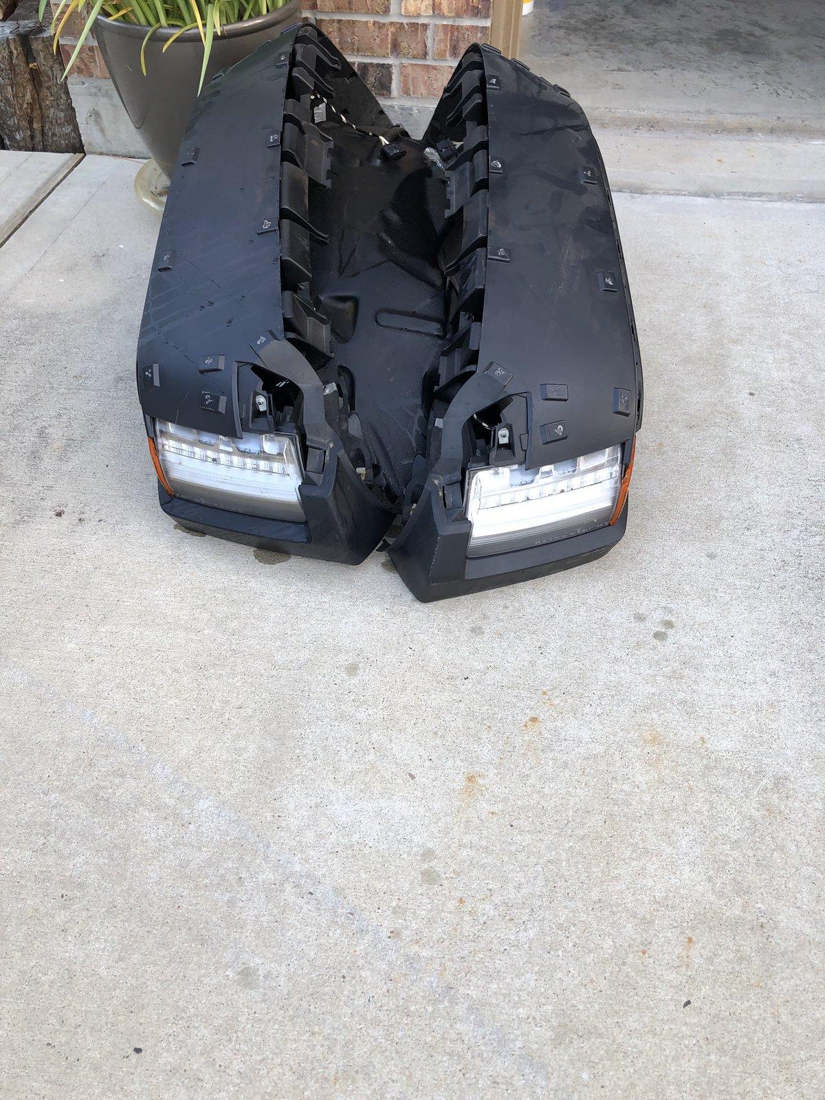

Sad to say they are not designed to come off the base as they are sonic welded together. Painting will involve tape! [GALLERY=][/GALLERY]
That is an image I got off this forum with the tops removed. Those square pads with the weird white mark is where they are welded together.

Thanks .
The method is a bit agressive if i want to keep both parts in good condition.
So the only way to paint these wings is to tape the textured part ?
