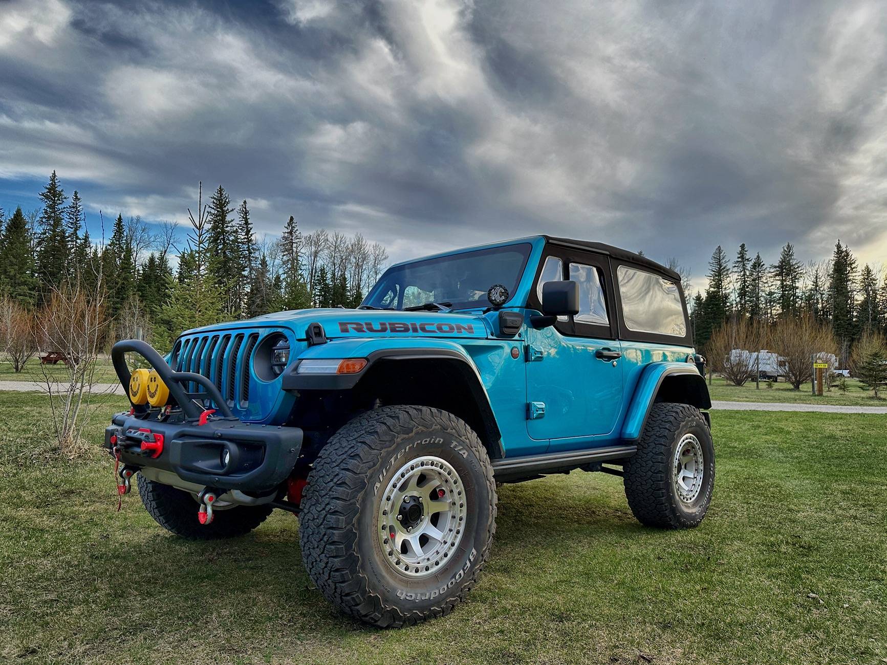

No such issues with the half doors on mine.
Granted, it doesn't live outside but has been on multi thousand km road trips and through all sorts of weather conditions.
If the OP has factory half doors I cannot see how they would leak anywhere near the extent he says (obviously a foot or two is an exaggeration as that would be over the seat). Maybe someone is sticking a hosepipe in your Jeep and using the rain as a cover story??
