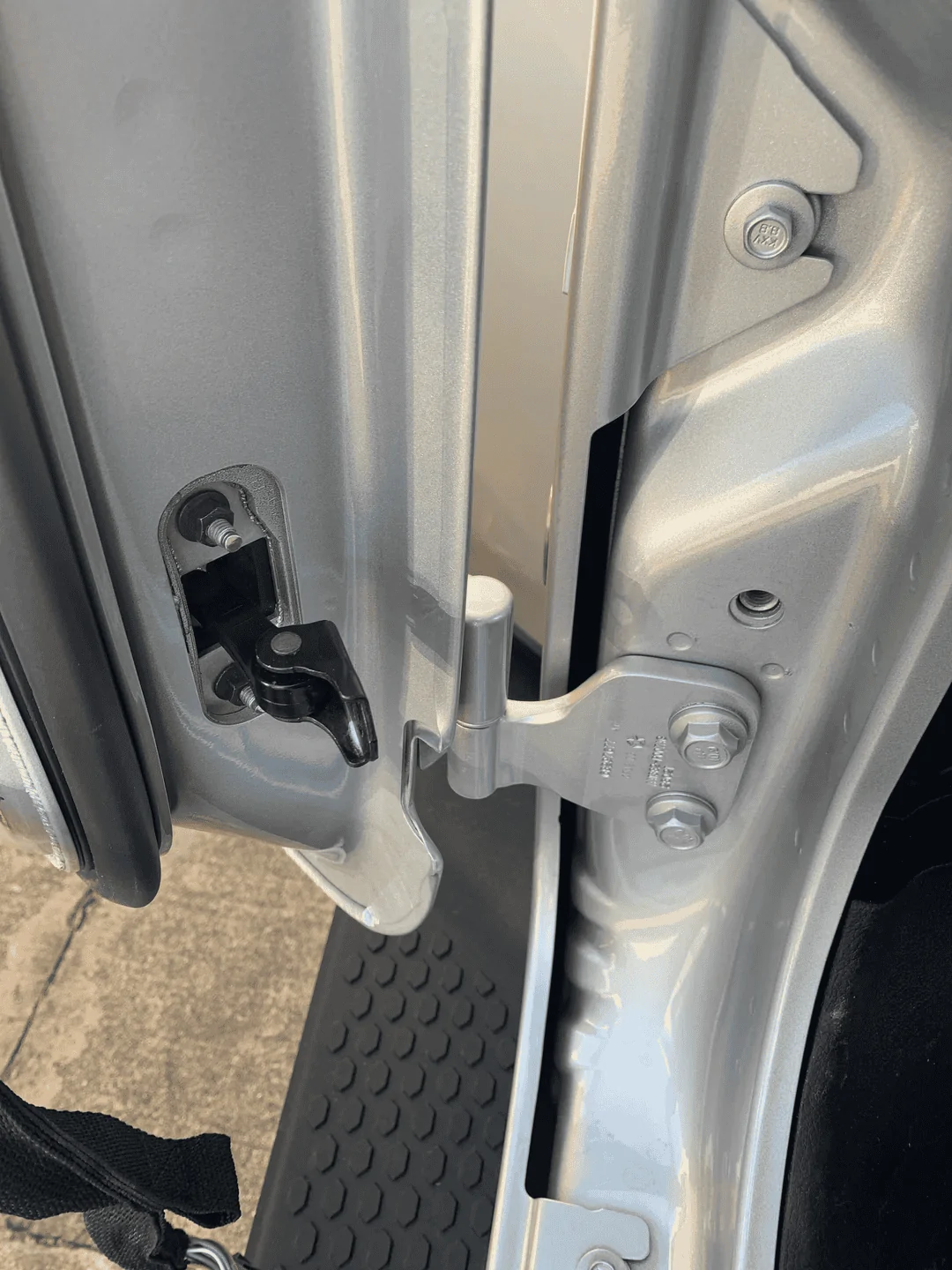

Hello everyone,
Took my doors off and when I went to reattach the right, rear passenger ran into an issue with the hinge arm.
I started screwing in the long bolt when the door swung inwards a little. This put enough pressure on the tiny screw plate inside the B panel, which caused the screw plate to disattach itself inside the B panel.
Essentially, I cannot screw the bolt any further, nor remove it. The door opens and closes, but because it isn't fully fastened, the hinge arm pops. Also I'm stuck with a door I cannot remove anymore.
I tried metal adhesives but couldn't get them two to stick.
Has anyone ran into this problem? And what did you do about it?
Any recommendations?

So the screw is partially screwed into the receptacle, which has popped loose inside the panel?

I thought about that too, but was concerned about the arm scratching the paint on opening and closing the door.
Either way, I'm going to very careful with that bolt/arm from now on.

Thanks for all the replies so far.
Hopefully you can see the reception inside the panel that receives the bolt has come loose. I can't tighten or loosen the bolt anymore. So the door check arm is actually attached to the bolt still. Permanently, until I get this bolt free.
