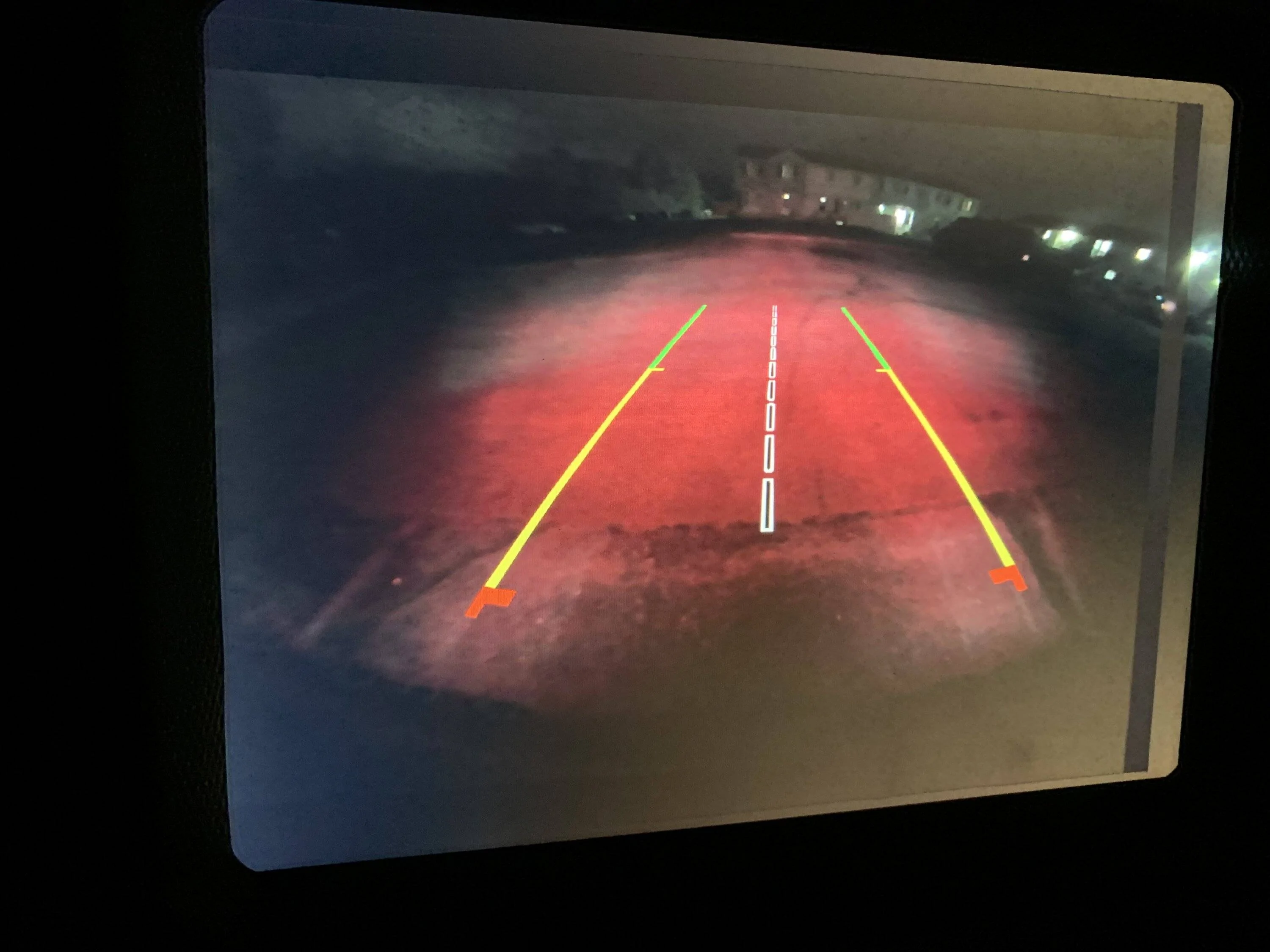

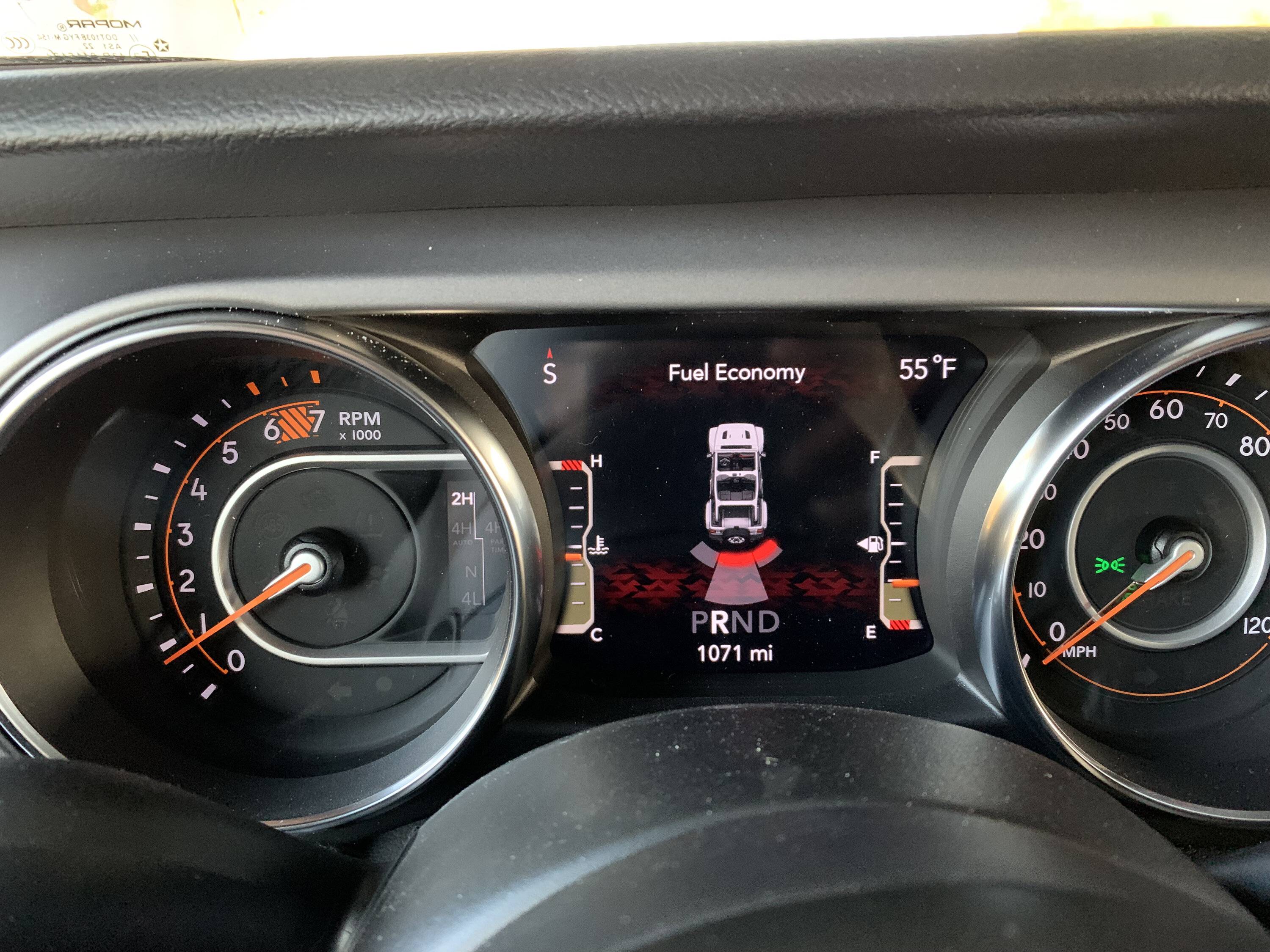

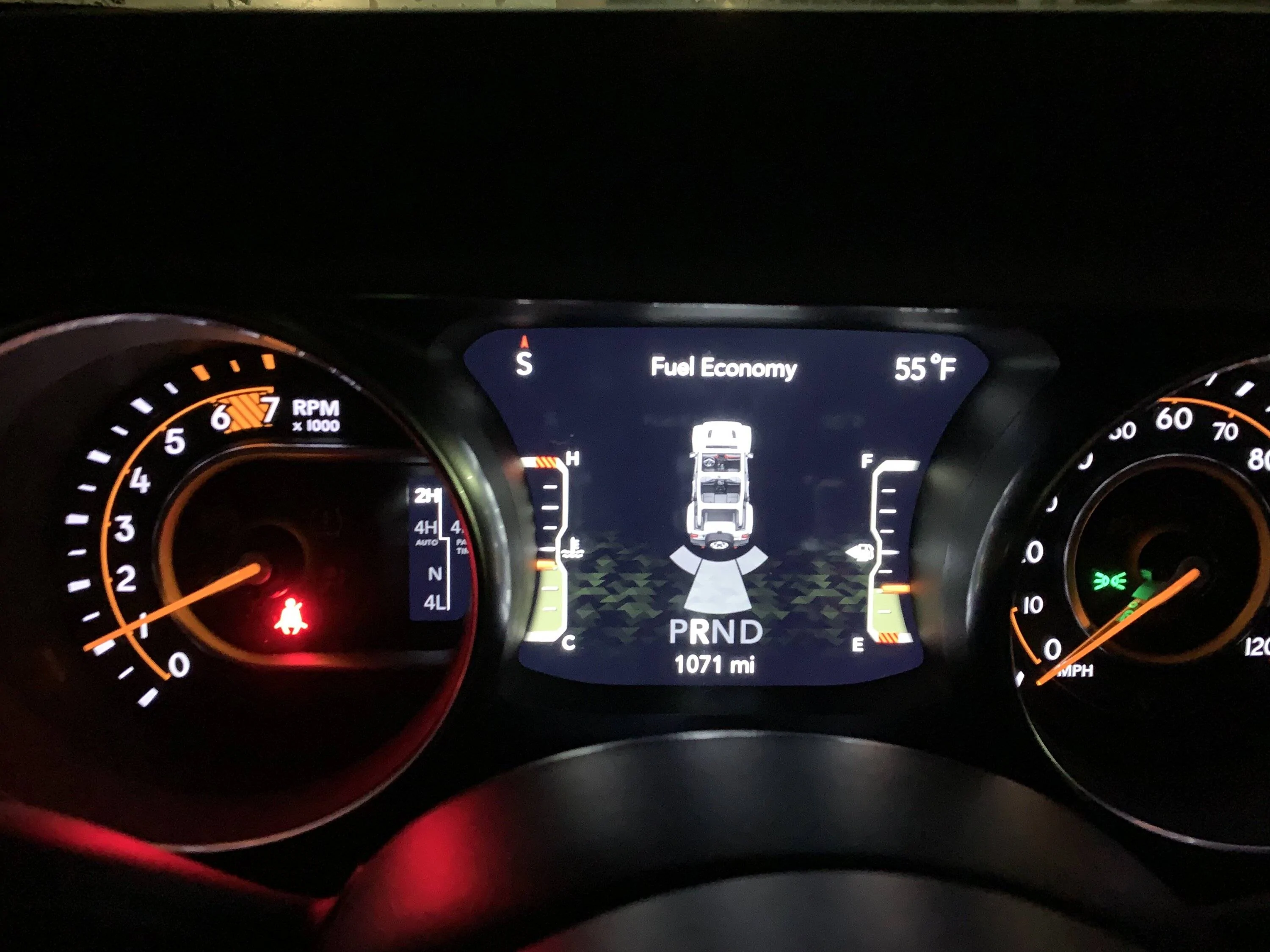

Hey all,
The rear park sense literally started going crazy as if there were a ghost when I got out of work today.
No objects, no sidewalk, no human walking across….
The sensor beeping literally does not stop.
it was fine when I left home for work in the AM today.
The only difference between all these days and today is that I added a soft vinyl cover for the spare last night. Who knew that could create electrical gremlins LOL!!
I toggled the park sense on and off a couple of times. Also shut the Jeep off and on, when I had to stop by the gas station and another place on my way home. The off/on key cycle did not reset anything and the glitch still exists.
please offer your thoughts. Pics attached.
What do I do next?

You all won’t believe this.
I took the tire cover off, secured the camera helmet back on, voila.
I set the Jeep in reverse and sat there for 10 seconds and the sensors didn’t beep.
I went to D, then back to R. No problems!
I can’t believe how finicky the system is.
I will try and put the cover on and off tomorrow to see if the issue comes back, or I’ll have to send the cover back unfortunately.
