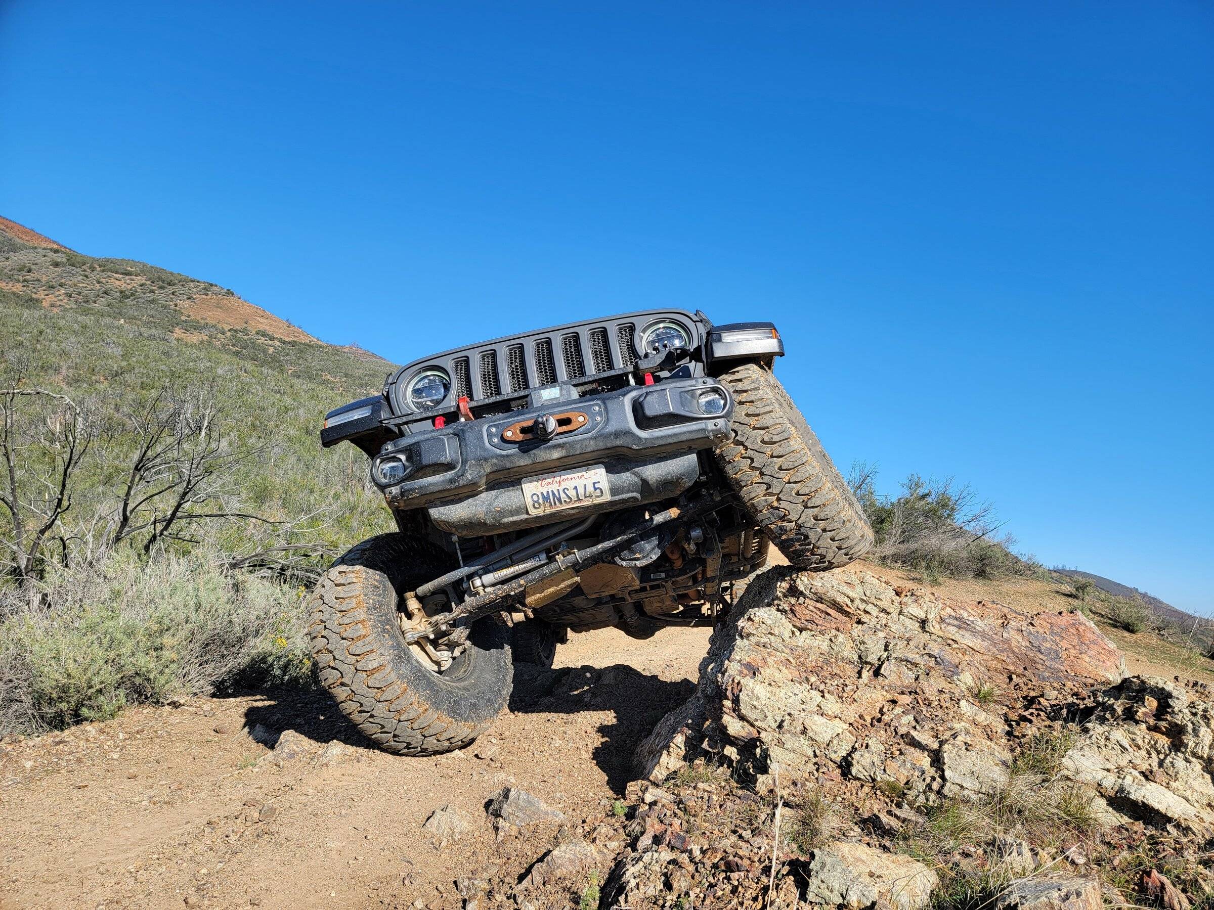

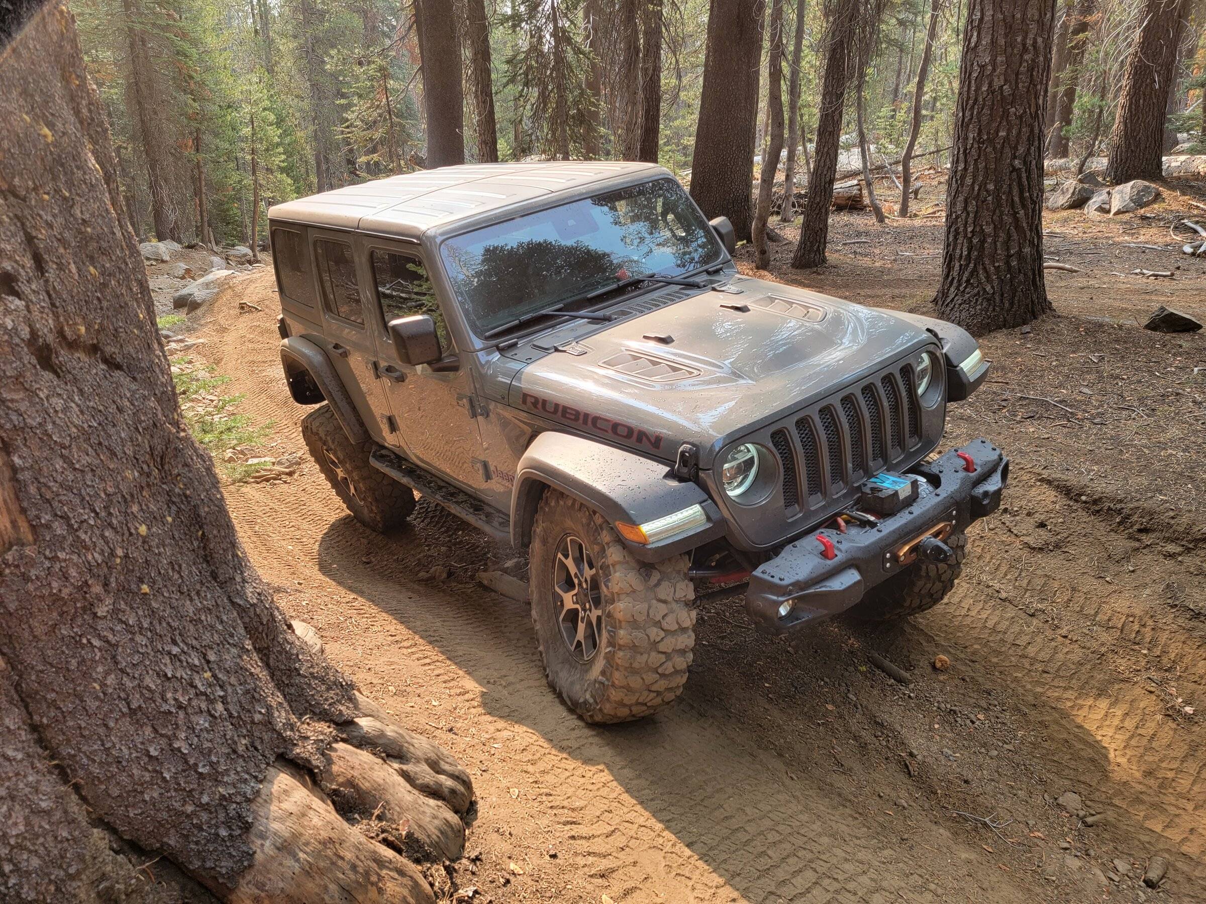

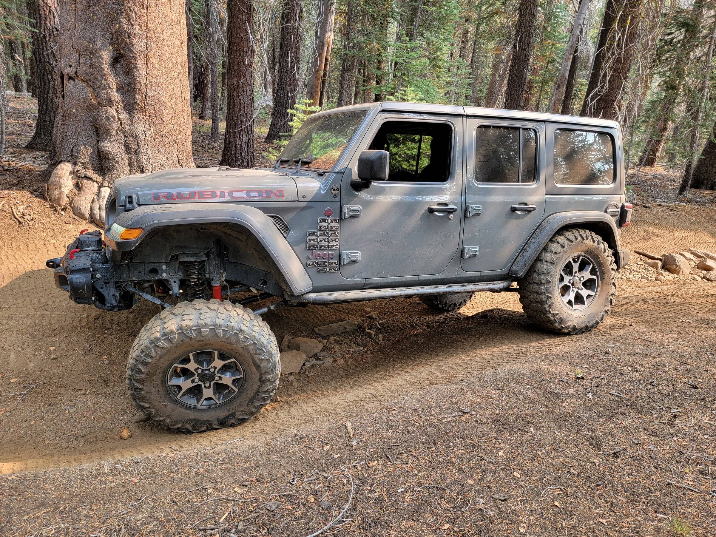

4.56 will be good with 37's. We have run 37's and now 38's all over the western states for over 30k miles. No problem with mountain driving or freeway passing at 85mph+. Granted we have the 2.0t which seems less concerned with gearing than the v6 according to hundreds of posters on this forum. We see 8th often. Crawling with the 4-1 tcase gearing really doesn't matter. People have been running wide tires on narrow wheels for decades, makes it less likely to lose a bead when aired down. Here's ours with stock 7.5" wide wheels and 37Ă—12.50's.
Jeep Wrangler JL Gearing and Tire Selection 20211003_105236
Jeep Wrangler JL Gearing and Tire Selection 20211003_105216
Jeep Wrangler JL Gearing and Tire Selection 20211003_105246
And now with 38x13.50's
Jeep Wrangler JL Gearing and Tire Selection 20220220_140417
Jeep Wrangler JL Gearing and Tire Selection 20220130_133436
Jeep Wrangler JL Gearing and Tire Selection 20220130_133421

And now with 38X13.50's, Wow.
On 7. 5" wheels, did you use wheel spacers?
Zandcwhite
Zach
Sep 4, 2019
8,351
14,278
Patterson, ca
2019 jlur
1.5", the tires rubbed the swaybar and lower control arms up front and the inside of the fender in the rear when stuffed without them. We initially did a 2.5" spacer lift, shock extensions, and 37's on stock wheels with no wheel spacers the week before our 1st moab trip 2.5 years ago. Ran top of the world, Fins, Hell's Revenge, poison spider, golden spike, and gold bar rim with no issues. I think we only used the lockers twice and she walked right up the waterfall on gold bar rim. We've made several changes since then, but a set of tires costs about what I have in the suspension at this point. Rock krawler 4.5" springs in the rear, icon springs in the front with a 3/4" spacer, metalcloak rock sport shocks, stabilizer relocation bracket, and fad skid, Rubicon express front lower control arms and track bar, lowered frame side rear track bar bracket, and a synergy drag link with track bar bracket/flip kit. It's a hodge podge but works amazingly well. If I had it to do over again I'd probably go icon stage 7 as we do take a few trips to the desert every year where we put in hundreds of high speed miles. Did 200+ miles in the dirt just 2 days ago at speeds as high as 95mph.
