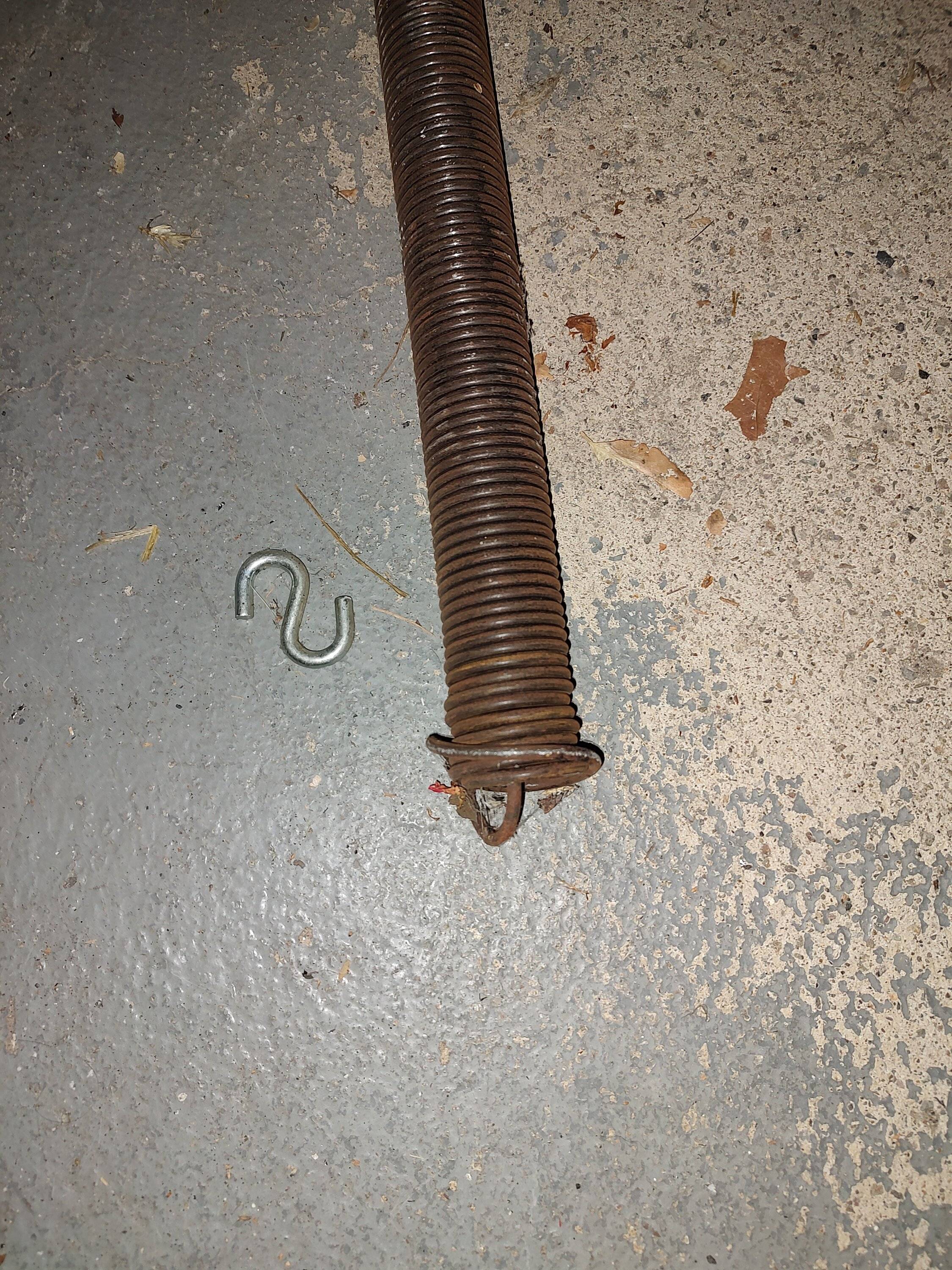

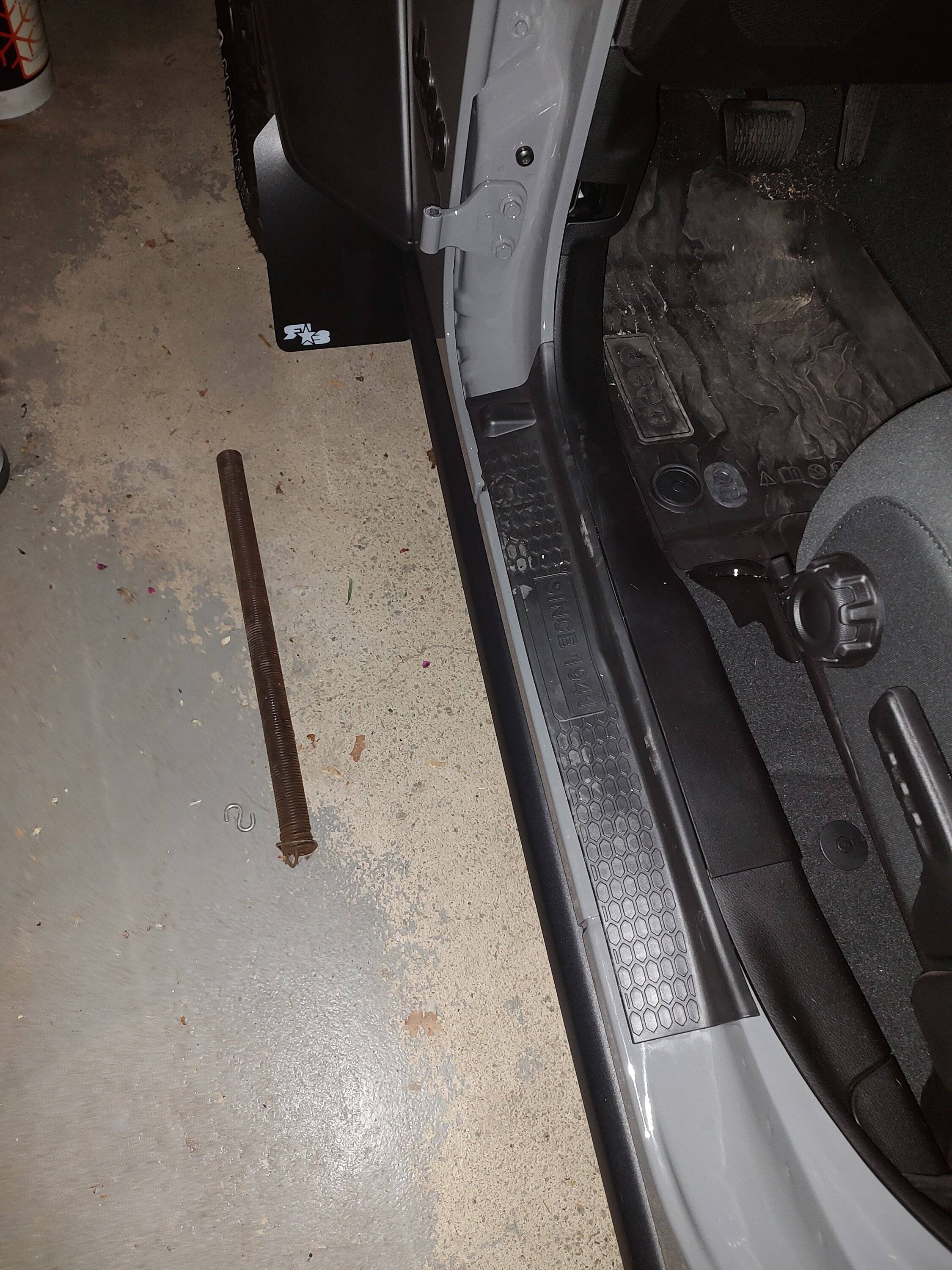

OMG... So I picked up my new wrangler about 2 weeks ago after a 4 month wait. I absolutely love it. I have the doors off, added a few small mods, I still drive around and can't believe that she is really mine.
I parked in the garage tonight, and my son and I were admiring the jeep and standing around looking at a way to run a wire for a flashlight charger. We went into the basement, shut the door, and BOOM! We hear this explosion. My wife is yelling from upstairs all scared, I didn't know what the hell happened. We go back into the garage and the door spring had snapped. The safety cable that runs thru the spring to keep it safe in case this happens also snapped. Right over the jeep. We had been standing right there about two minutes earlier.
I was afraid to walk around and see damage, I came around the back and the giant heavy spring is on the floor right alongside the jeep, the cable snapped back and was hanging a few feet away. There was sheetrock dust all over the hood. And ZERO damage. I can't believe that spring managed to fly off and avoid smashing anything. My adrenaline is still pumping and I feel so lucky right now. Here I park in the garage to keep the thing safe, right?? So we had the doors put in 20 years ago and I have never even thought about it, but just a heads up if your door opener springs are old you may want to think about changing them out. Off to buy the kit (both new springs and cables) tomorrow. WHEW!!!

The large torsion springs are the dangerous ones. This spring is easily replaced. It is only pulled when the door closes.

How did it come off the rod/pipe? Mine goes through the center of the coil spring and when it broke both halves were still captured on the rod.
Yeah, there is a cable running thru each spring, and this cable actually snapped! Yikes.
I have not seen that arrangement before. Most I have seen have a 1" pipe running across the top with pulleys on the end and a spring in the middle. When the spring fails the pipe captures it.
