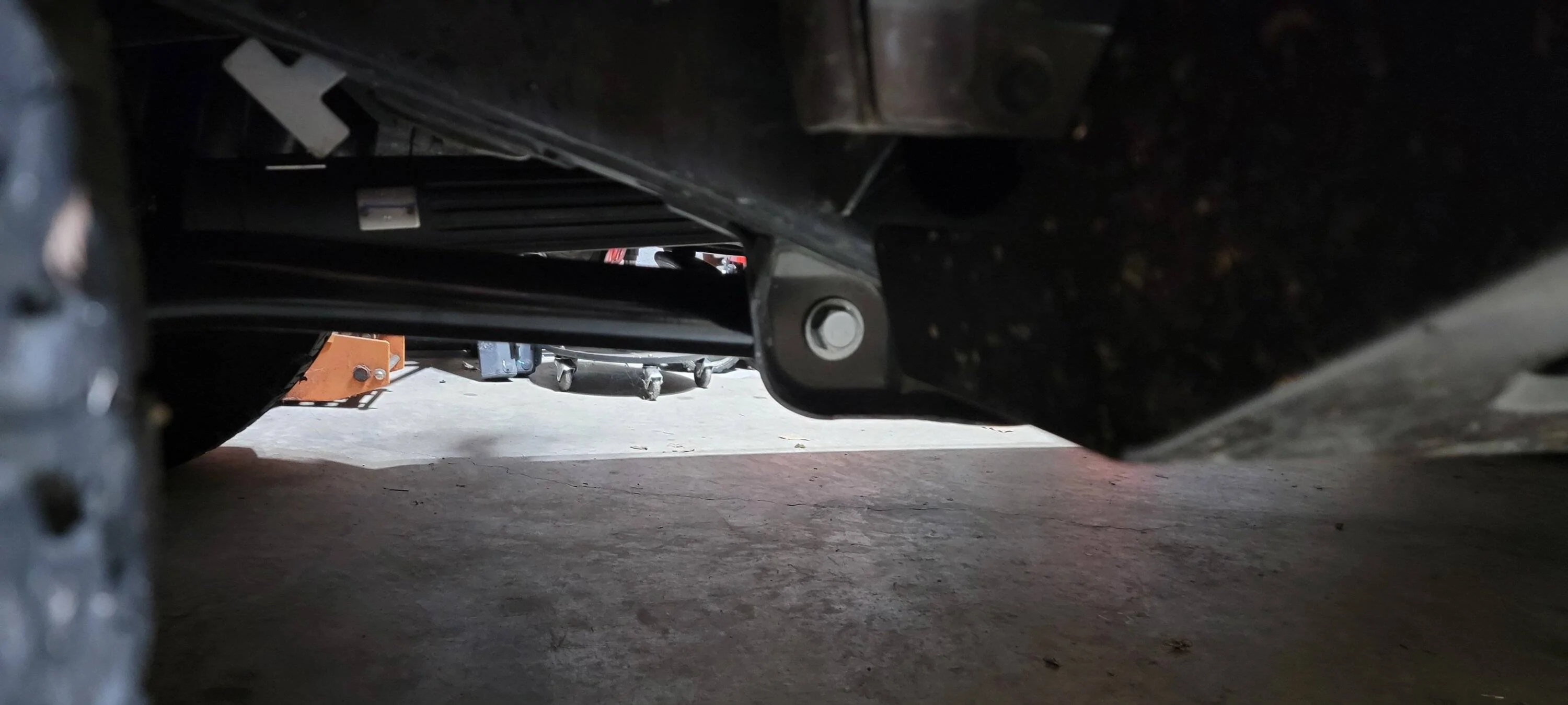

Love to see a pic of this. I rolled around a bunch trying to figure out a better way. And couldn’t figure one out.
Just put a bolt through the frame bracket and drop the control arm to the ground. If you mock the control arm up and get the jam nut close you can even get super close in getting the joints in phase.

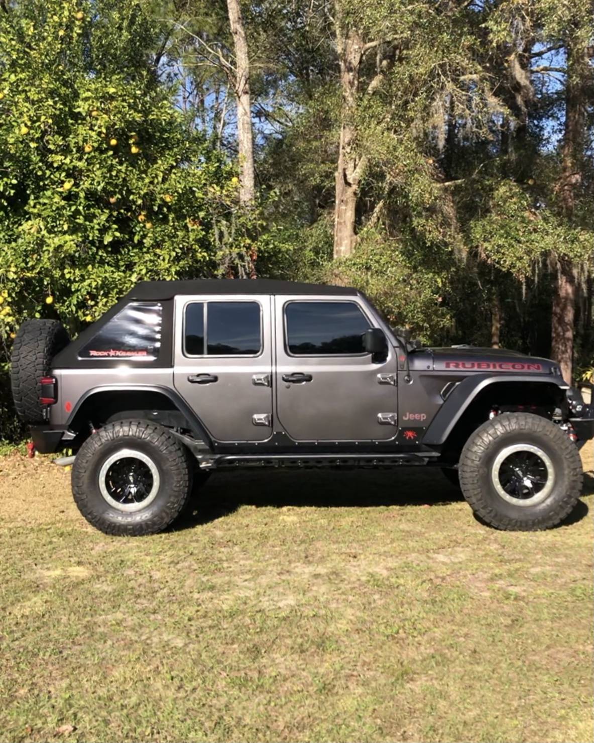

Here’s the measurements I used for 3.5” on 37s to get 6.3 caster and center the rear wheels in the wheel well, and set rear pinion at 2 degrees down to keep rear springs straight…….. and yes you can set caster with lcas…… here’s side shot to see wheels in wells……

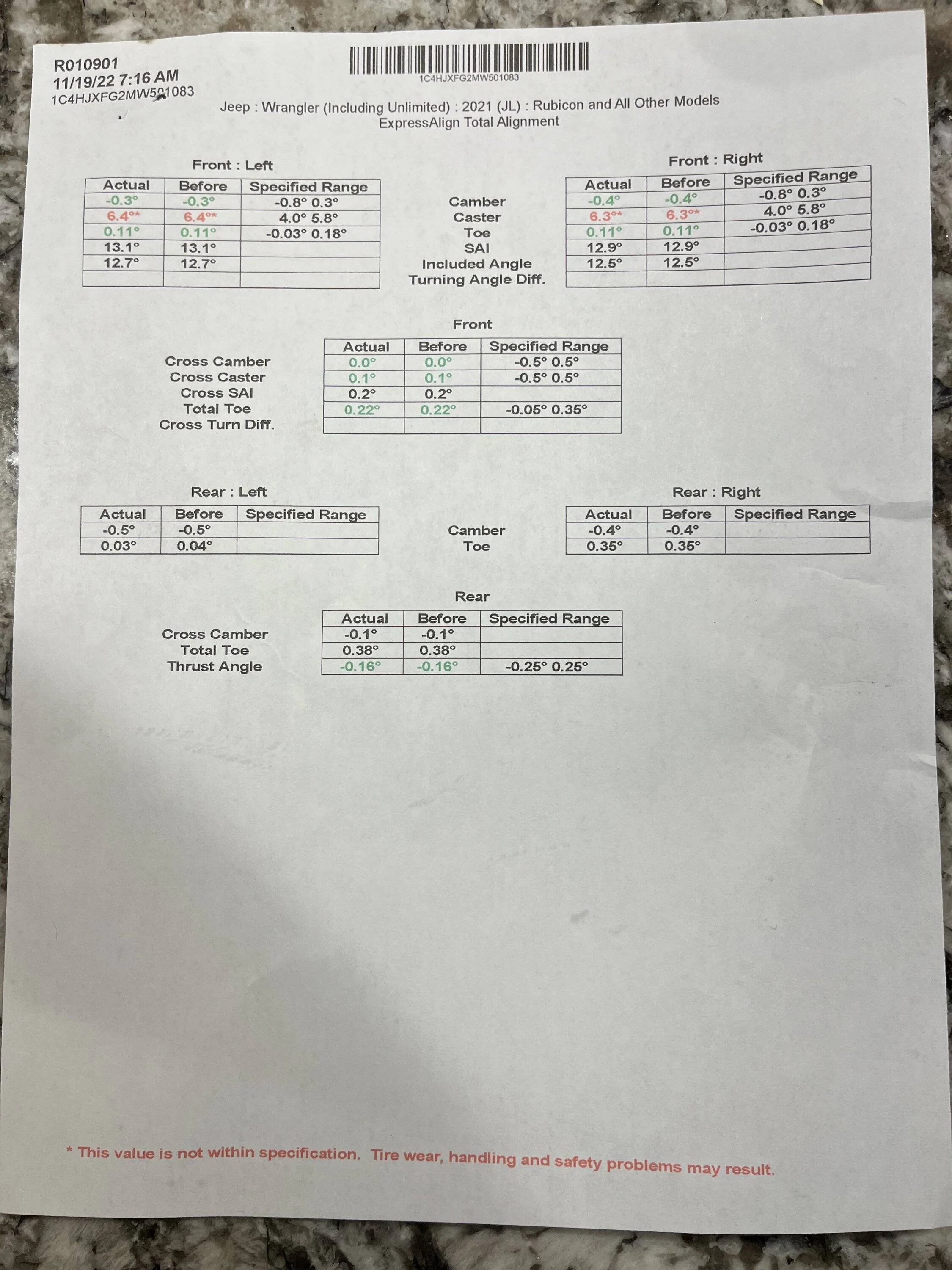

Got everything lined up. Thanks again for the measurements. Here is my alignment print out. Aside from a right pull everything seems good.
Jeep Wrangler JL Front LCA installation help 09767145-B4C6-4057-BCDF-9F908E218C6E
Roky
Roky
Oct 4, 2018
10,778
29,705
Sure brother , anytime ……. Alignment looks good!
