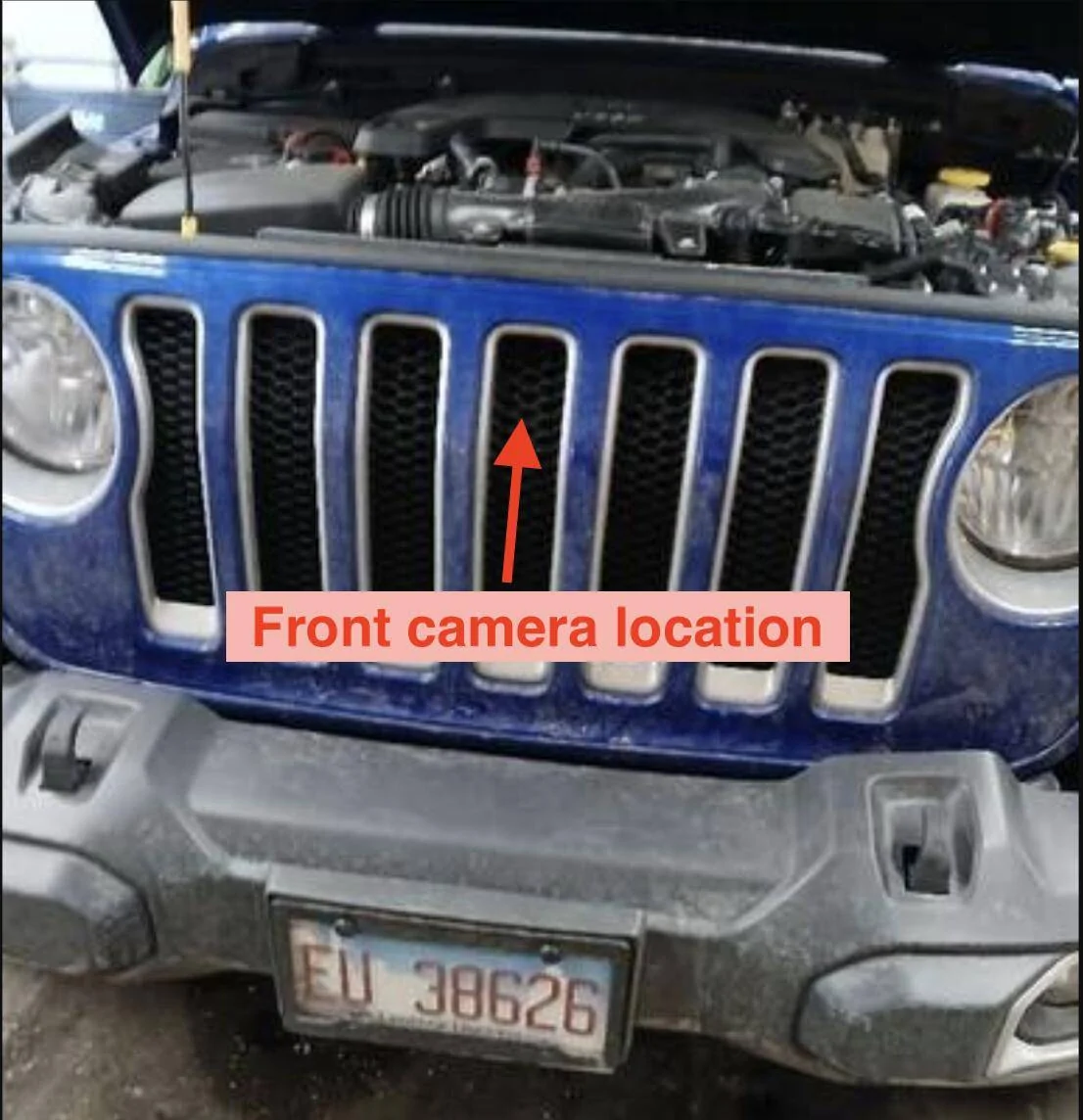

You do not have a front camera.
Jeep Wrangler JL Front Camera Screenshot 2025-03-04 at 10.39.14
Honestly don't know if the 7" UCONNECT4 radio supports the trail cam, but regardless it requires more than the camera and might require the 8.4" radio. For the factory trail camera, it also requires an input processor/switcher (CVPM). For details, click here.
Edit: For a non-OEM front camera, you can use this one from ZAutomotive (the company that makes the tazer). It requires the 8.4" radio (or one of many aftermarket radios) if you don't have that and a tazer (if you're using the OEM 8.4" radio).

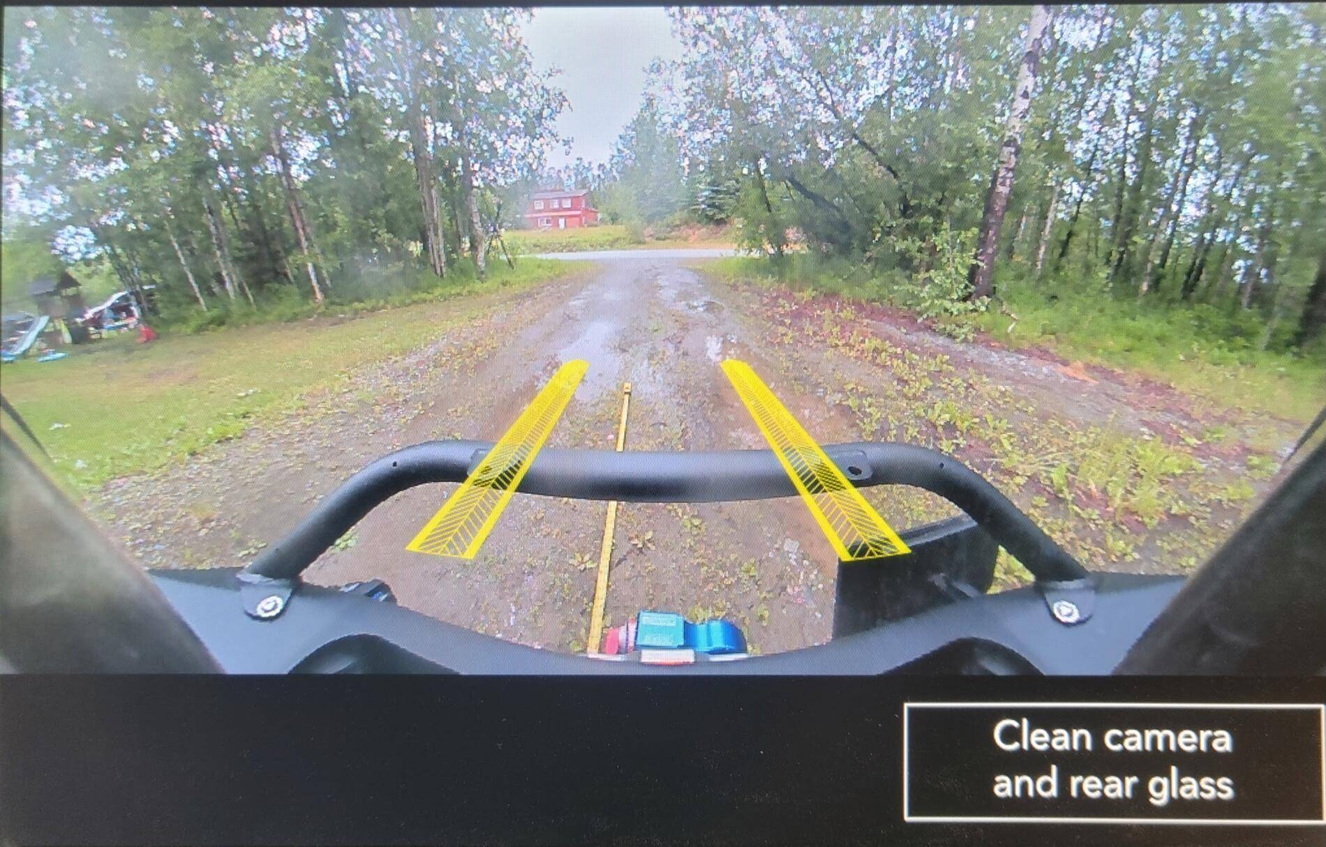

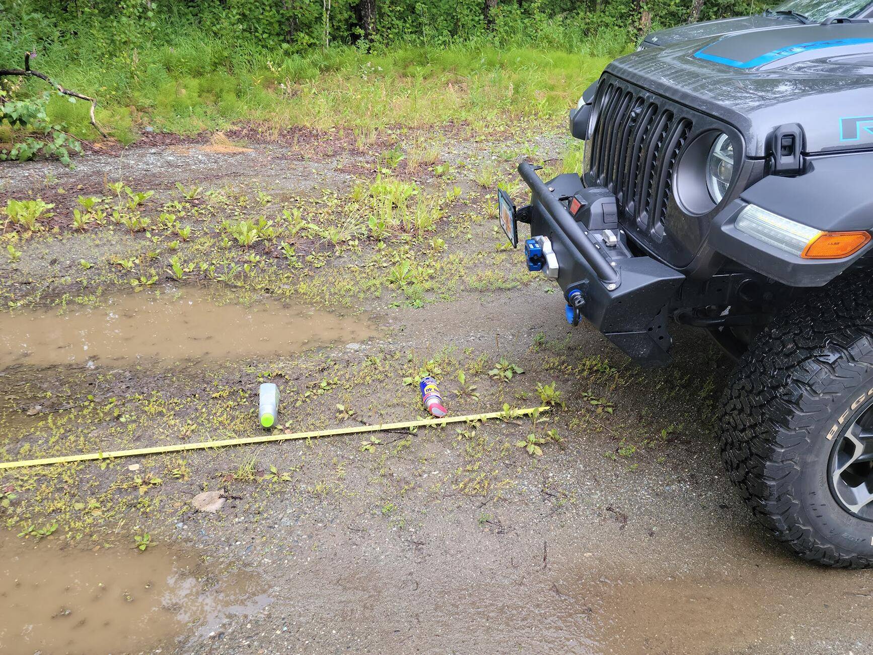

Hmm, the image quality on mine is great. I have also added a "shortcut" to it on the "taskbar". So it is exactly one tap to launch.
My bumper has a light mounting bar on it, so I took this picture to check that the view is still useful. It is. I use it frequently to see over the crown of a trail, to see obstacles, and for close-quarters parking.
Jeep Wrangler JL Front Camera 1741205672072-q8
The WD-40 can is the nearest visible with my winch bumper, and the oil can is obscured by the bar. The factory bumper gives even better angles.
