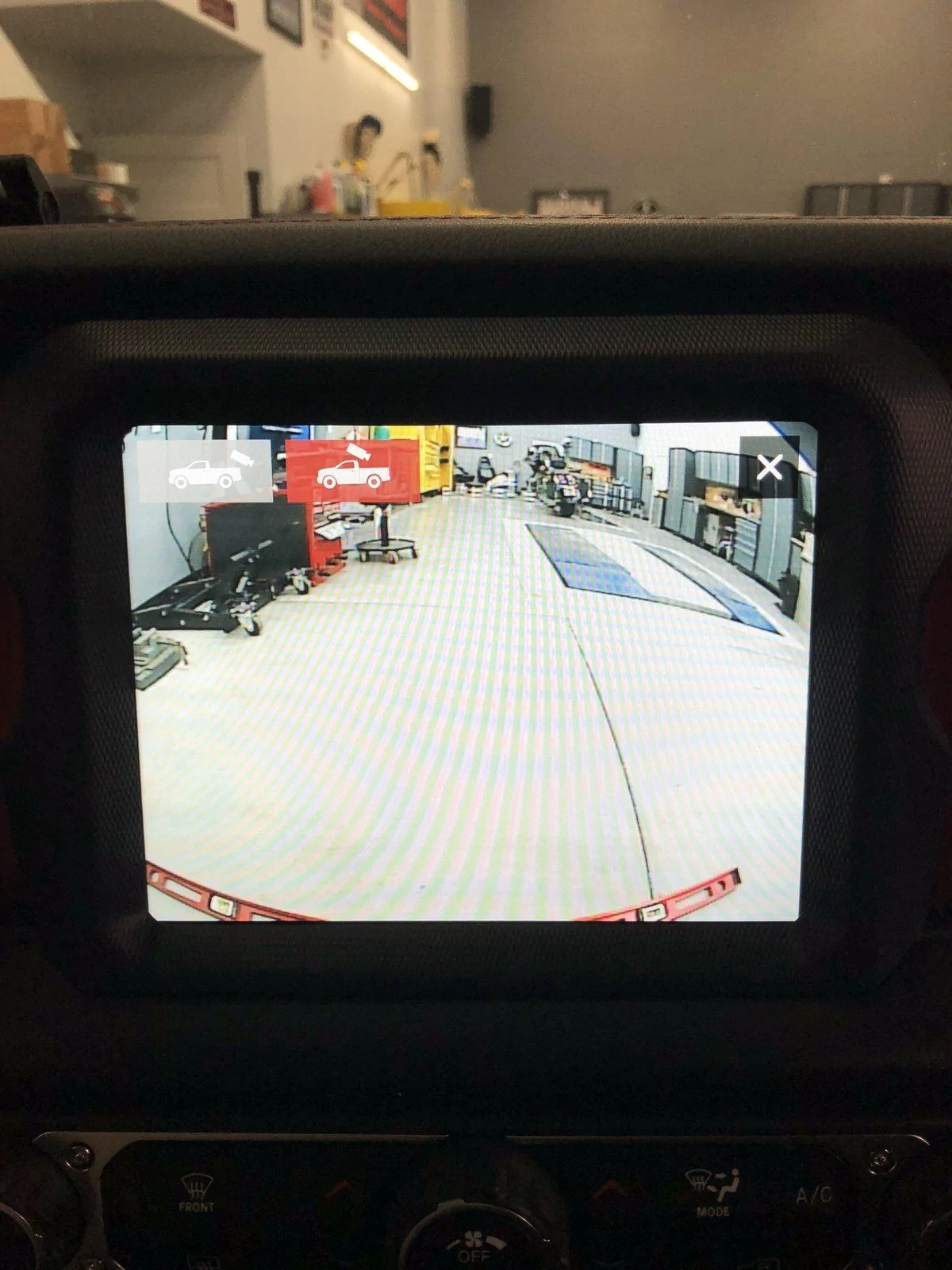

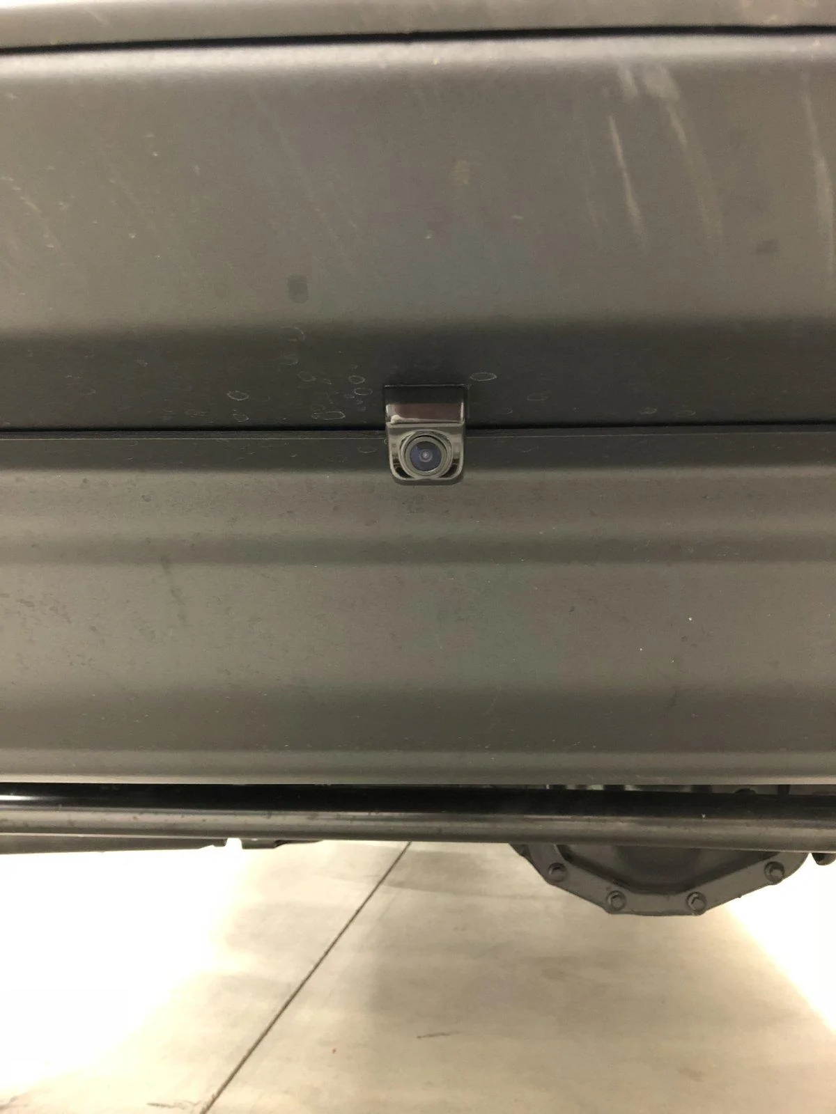

Just completed an install of this front facing camera. Went relatively smooth. I used the following camera that I purchased off Amazon.com and mounted it on the flat section on the bottom of the bumper. Overall difficulty is roughly a 4/10. Not too hard, just tedious and awkward.

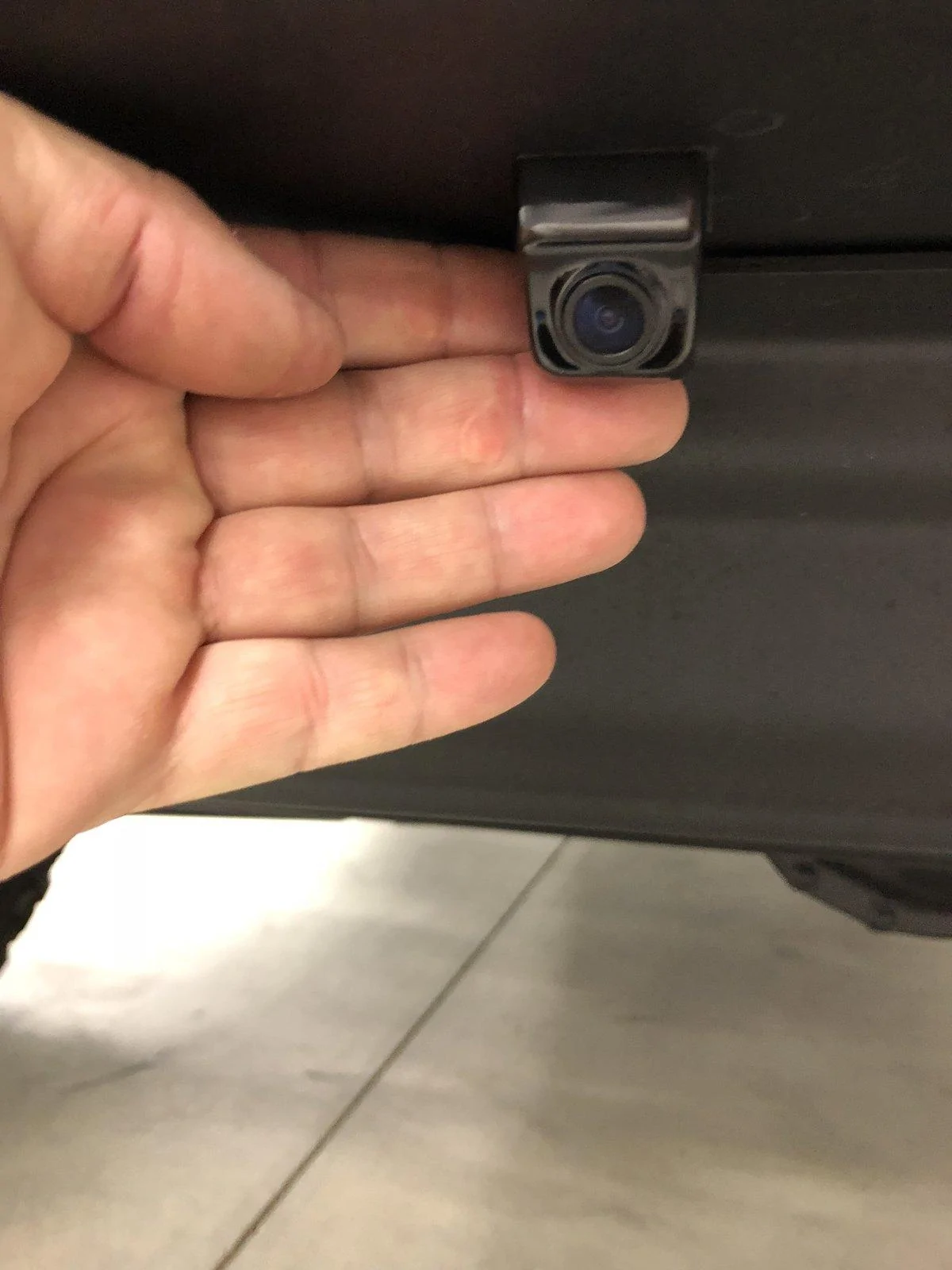

The camera is really small. Roughly 3/4”wide x 1”deep x 3/4”tall. It might be a little vulnerable if I smash the bumper against a rock, however it does sit back and out of the way. I bought this camera over several others that I saw for two reasons, glass lense and metal housing. Overall it’s pretty good quality. Not quite as clear as the rear camera, however I’d attribute that to the composite connection. The level in the picture was placed roughly 2” in front of the bumper.

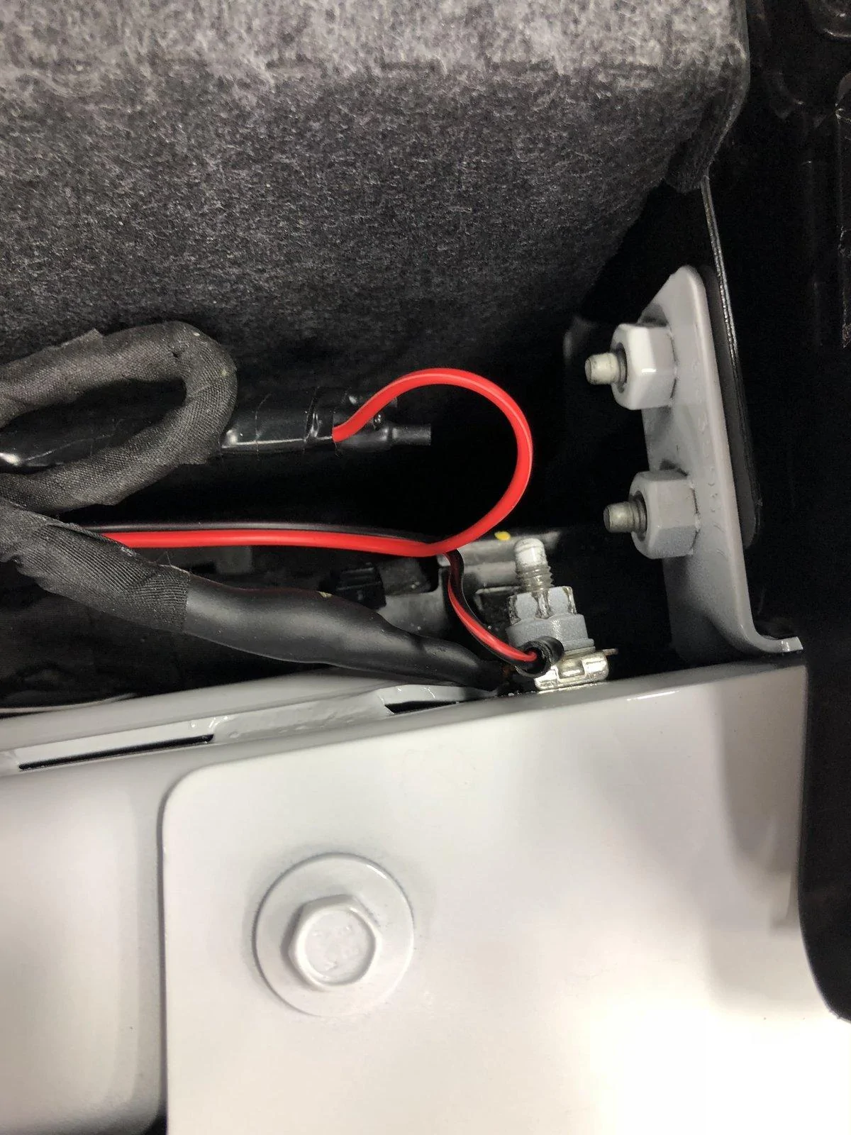

I pulled power from my aux4 connection under the hood. It was an unused circuit and if I ever need to use it I’ll just reconnect to a different power source. I chose to use the aux4 connection also because I don’t see the need to constantly run power to the camera if it’ll only be used sparingly. I soldered the power connection and heat shrinked it, soldered the ground ring to the wiring, and used dielectric grease on the composite camera and wiring connections.
