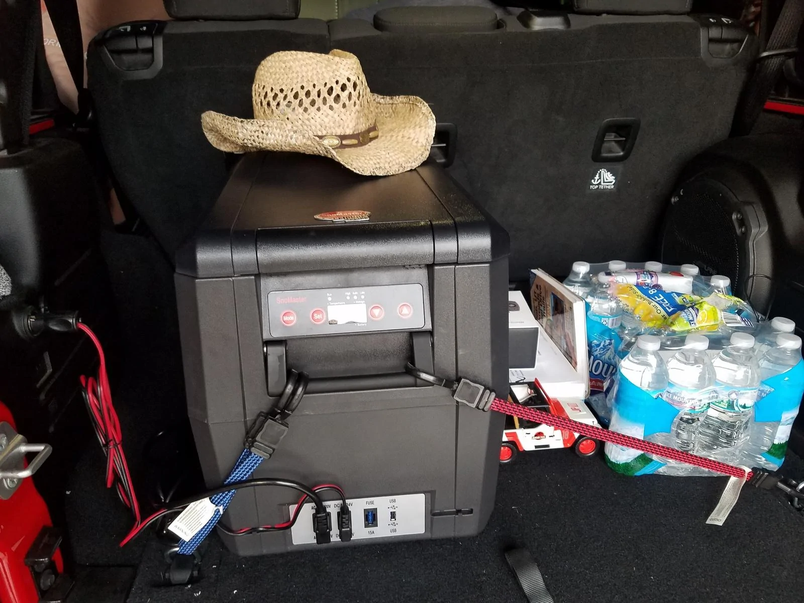

Well, I got a Snowmaster LS35 and for two days have run it off the aux 12v in the back of the JL. I found that the high setting on battery protection does exactly what was said earlier...It shuts off after a few hours. So, I ran it on low (or medium, I can't remember) and it ran just fine while parked for about 12 hours on a hot day, with soft top and windows buttoned up. The Jeep started up with no issue, although the fridge was showing the voltage had come down a bit. My habits won't include 2 or 3 days sitting with the fridge running. It would be 12 hours, at most. I keep the AC plug in it, too, so in my garage at night, I just plug it into the wall and AC takes over.
I agree that pre-cooling on AC is the way to go. It keeps the Jeep's battery from doing the heavy lifting.

OP here, with update on the solution I chose: Purchased a Goal Zero Yeti 400 (NOT the lithium version, as GZ is having problems with their lithium batteries not playing nicely with 12v car charging. They actually warn you not to do it).
Here’s the configuration I chose:
  1. Yeti input is always plugged in to 12v ARB harness wired direct to battery for charging (8mm plug, blue color code). I couldn’t get the GZ cig adapter to work. So I cut in half the Dometic 12v fridge cord. Then cut the GZ 8mm cig adapter in half. Spliced the 8mm connector to the side of the fridge cord that is compatible with the ARB screw-on connection at ARB fridge wiring harness.
  2. Dometic CFX50W fridge is always plugged in to Yeti output for power (6mm plug, green color code). I’m using the “Low” voltage sensitivity setting on the fridge, which - according to the manual - switches fridge off when voltage drops below 10.1 volts. I cut the cig adapter off a 6mm GZ cig adapter. Then spliced the 6mm plug to the leftover half of the fridge cord from step one above.
  3. OEM 12v cig plug in rear of Jeep is unused and available for other uses.
I tried plugging the Yeti into the OEM 12v plug for charging, but could only get 35-39 watts max input to Yeti while Jeep was running. With the ARB 10 AWG harness, I’m getting 65-69 watts while Jeep is running.
To put the wattage in perspective, the fridge uses 1-2 watts when compressor is off, and 60-62 watts when fridge compressor is on. So a steady 65-69 watts input while driving should be a net positive in terms of charging the Yeti - even if the compressor ran continuously, which it does not.
For trips where we travel to a new location each night, this config SHOULD work well. I’ll confirm when I get back from next trip.
For trips where we don’t start Jeep for several days, a solar panel could be used to charge the Yeti during the day. Note to self: need to buy a solar panel!
