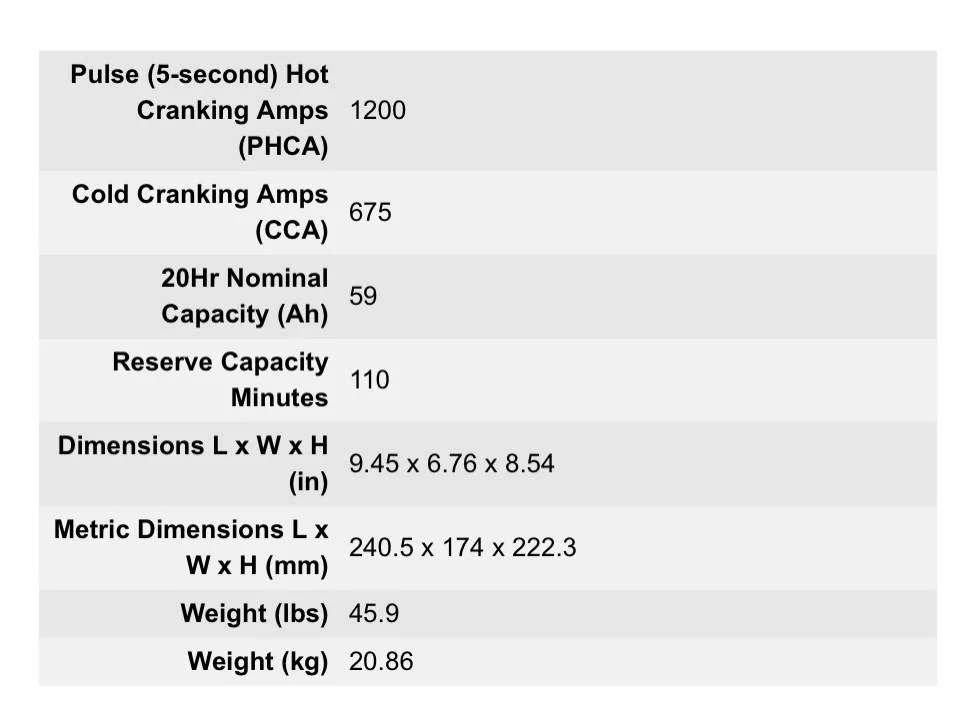

Odyssey extreme batteries. Can handle cranking (higher than most traditional cranking batts) and survive 400 charge/discharge cycles to 80% depth of discharge. I believe the Full River batts operate about the same as well. I think having an isolated deep cycle batt is just as functional though.
