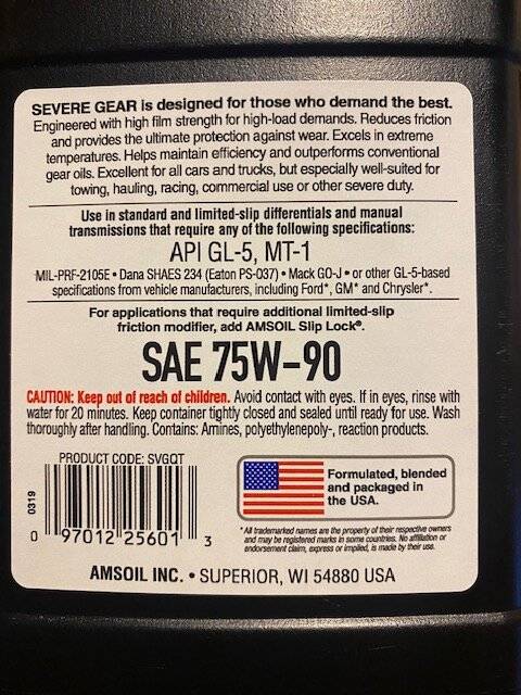

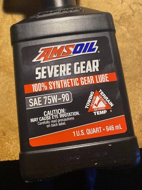

I have the Amsoil pictured below - on the website it says:
Jeep Wrangler JL Friction Modifier or no? Amsoil 1706967289336
but on the bottle it says:
Jeep Wrangler JL Friction Modifier or no? Amsoil 1706967217682
I have the LSD in the rear. Thoughts/experience?
Jeep Wrangler JL Friction Modifier or no? Amsoil Amsoil 1
Jeep Wrangler JL Friction Modifier or no? Amsoil Amsoil 2

Drive in tight circles and see if you hear chattering from the differential. Odds are you won’t because of the friction modifier already In the oil. If you do hear chatter, add the Slip Lock in small amounts until the chatter is gone.
The real problem, and @CarbonSteel will no doubt be along shortly to point this out, is most of us would run 75w140 in the rear per Dana‘s recommendation and for the increased heat that these axles generate. But 75w90 is adequate (do you really want to be only adequate?).

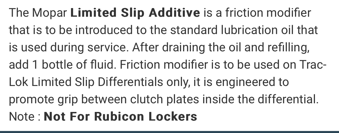

Jeep Wrangler JL Friction Modifier or no? Amsoil 1706967805674
This is a blurb from mopars diff fluid. I would guess it works the same way for the Amsoil fluid. To be certain I would contact Amsoil.

Nearly all synthetic gear oil has friction modifier in it (including Amsoil as you have noted) and rarely for an OEM LSD axle is additional friction modifier needed.
Drive in a slow figure eight pattern in a parking lot and listen for popping sounds after refilling the axle. If that type noise is experienced then additional FM is needed.
You will want to add in VERY small amounts because too much FM will cause the LSD to perform as an open axle. Again, I do not think that you will need it.
If you tow or run heavier loads, use 75W-140 (I would run it regardless as Dana specifies it).
Perfect - thank you and to all the others who took time to post about my question.
Also, The 75W-90 will go in the front/the 75W-140 for the rear.
