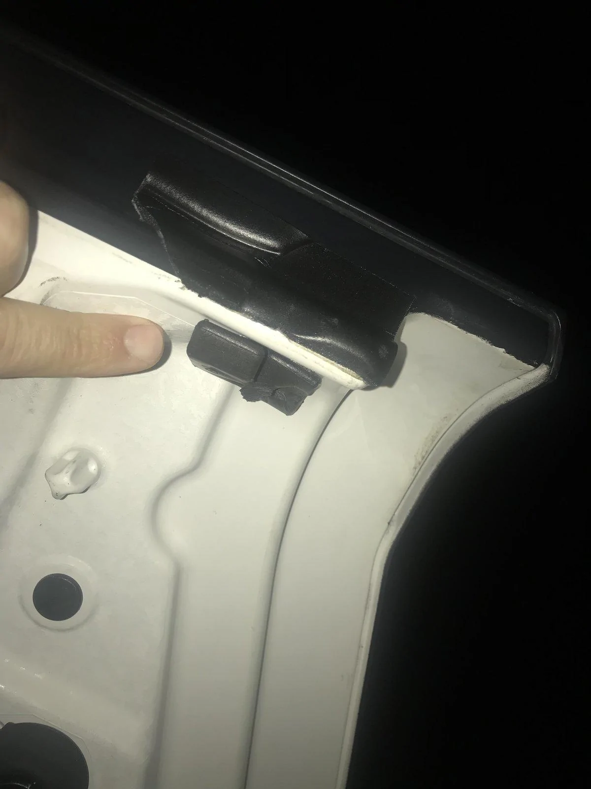

Would like to mention that I'm either bad at following directions or the pictures were difficult to process with such close-up context. I eventually got it, but here's another photo showing the same thing with a bit more context (man, I need to cut my fingernails!).

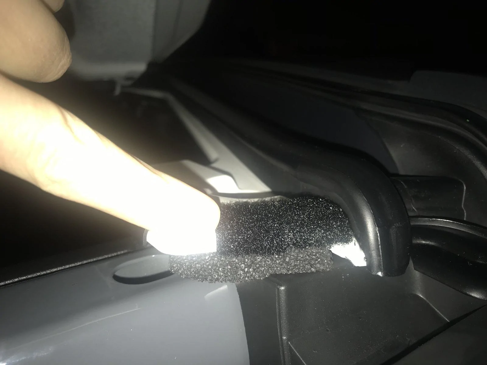

Amazing that a 2 dollar pack of velcro saved a life. The rattling was so bad I was about to drive this bitch off a cliff and just end it all... LOL.. I added Velcro and zero rattles now. Here is where I added the velcro, I did it on both the driver and passenger side.
