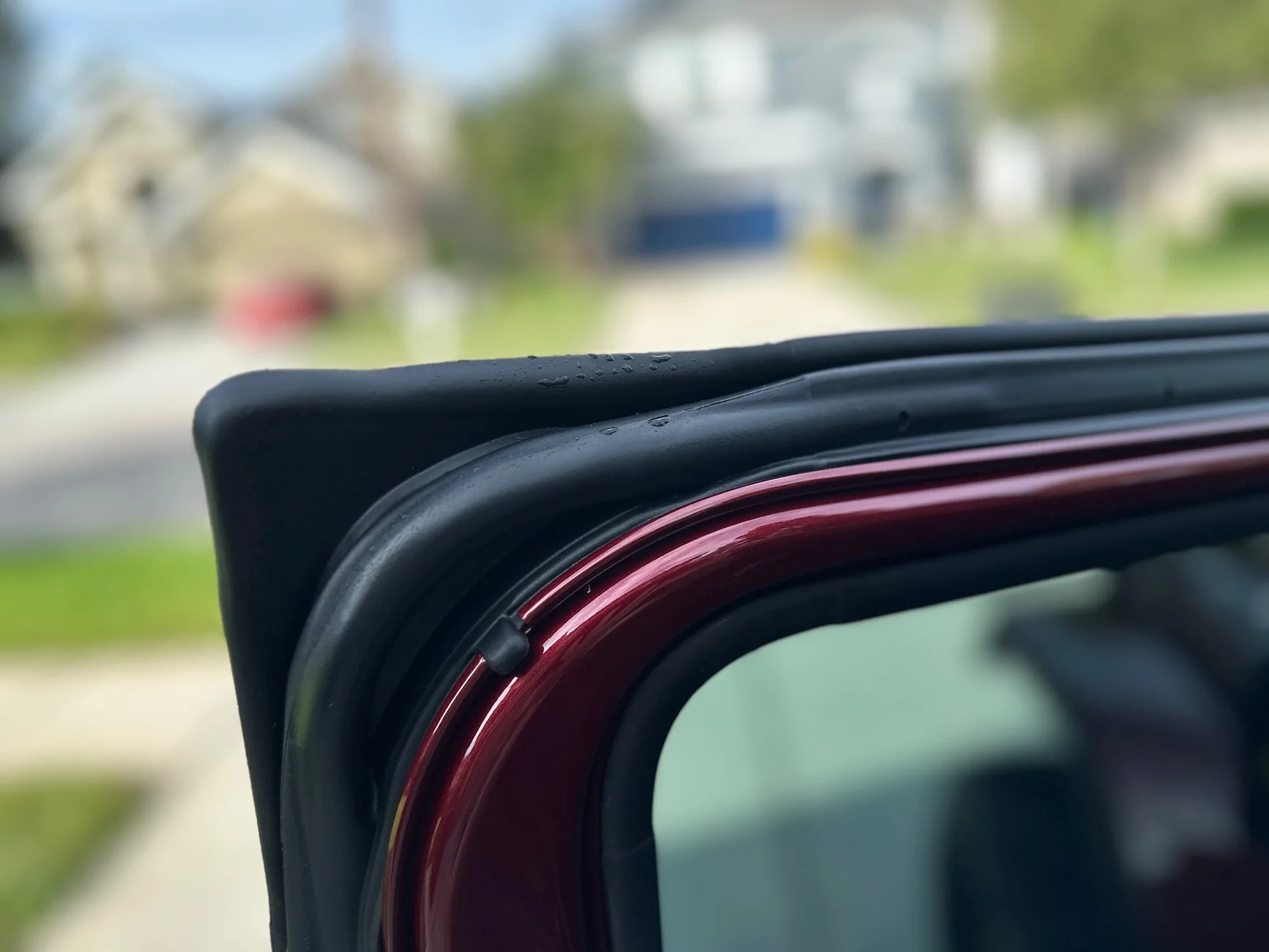

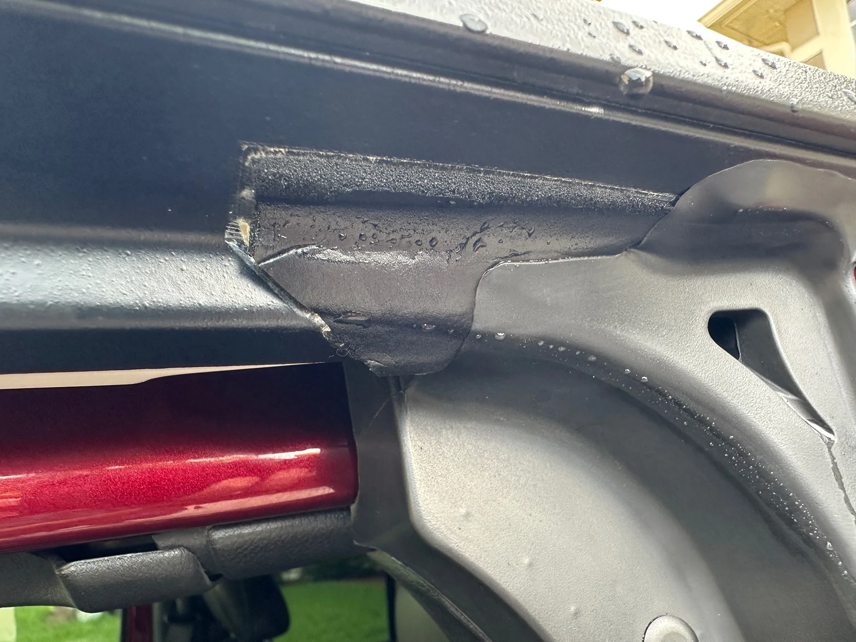

Hello
When it rains I get water coming in near my shoulder on the drivers and passenger door. It only seems to come in when driving.
I’ve read that the weather strip on the freedom panel can go bad causing water to seep.
Has anyone had this issue or fixed this issue? Not sure if I should pull the weatherstripping on the freedom panel and apply new or just add another layer.
either way anyone had this or have a fix?
thank you.

For me, It seems the issue is somewhere where the freedom panel weatherstripping meets the door jamb rubber (1st pic above). Not sure if shimming the freedom panel is it’s tighter will help me in this case. Has anyone replaced the weatherstripping on the freedom panel with positive results?

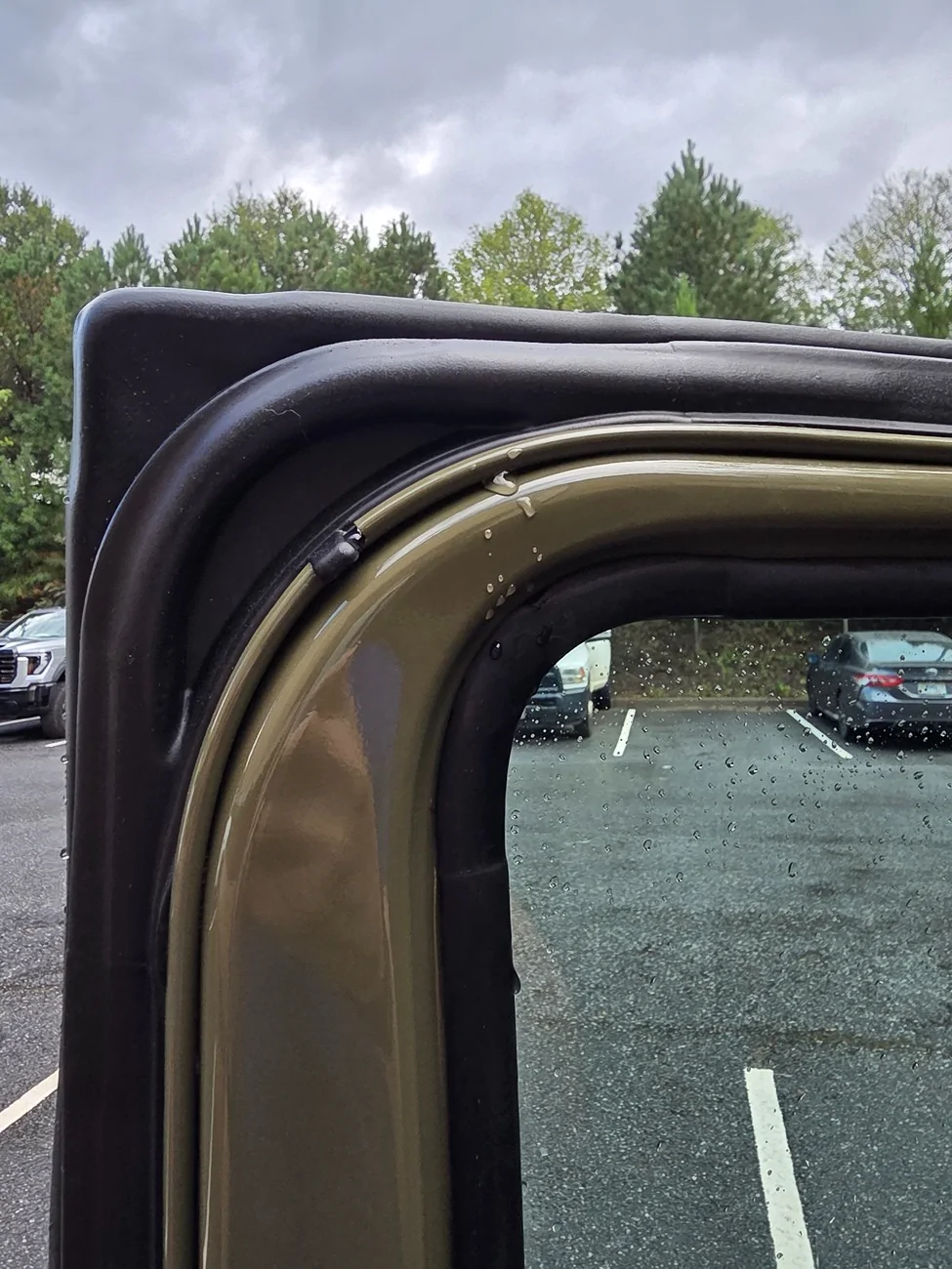

Jeep Wrangler JL Door/Freedom Panel Leak 7960
My 25 does the same exact thing as the OP.
