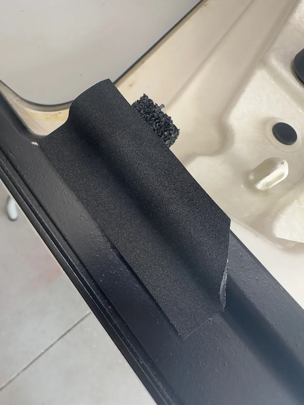

Ordered some 2”x1/8” weather stripping on ol Amazon. Cut it to match the old weatherstripping. Cleaned old adhesive and applied new pieces.
No rain in the forecast right now. Letting the adhesive cure so that helps.
We’ll see if this fixes it when the top goes back on.

Little late to the party, but bending the door is generally the fix. Old mechanic showed me that on my first car, it was not raining in yet but was getting some whistle.

Curious how do you bend a door? Would it have to be repainted?

No just roll down the windows, rest the door on your hip, put one hand on the down section of the far corner of the window frame and the other hand on the top side of the corner and pull towards you whit your torso / push with your hips. You can also pull with your arms to assist. Don't go crazy, you just need couple of mm. For long door you may also need to pull the center top windows frame in the same fashion. Door slamming have a tendency to push back on the far corner windows frame. So the point is to bend it back restoring it original position. I suspect the clearance issue is is even worse on Wrangler because the top panel also move, so you can loose up the pannel and try to push it more towards the side and reclamp it down.

When i have the doors off, the way they are on the hangers I made, they automatically hang in a position that puts a little inward pressure on them. Not enough to actually bend them but to keep them from bending outwards at the top of the window frame. So they in theory are being pulled in a direction that would keep them bent inwards.
Went through a car wash today and no drippage. Just waiting for a good rain for now.
We’ll see

My 24 has this exact leak but I bought the hard top used so it's not covered by warranty. My leak is clearly in the seal on the freedom panel where the foam has separated from the 90 degree corner of the panel. I can stick a small diameter rod (like a q tip shaft after you cut the cotton part off) in it which is the channel for water. Your posted fix in response #17 should fix it.
I've tried to order a replacement seal but they are on backorder according to my dealer. I've got the soft top on right now so this has fallen down my list of projects. Mine only leaks when it's raining pretty hard and either I brake or am going down a steep incline as the water has to be running toward the front of the wrangler.
