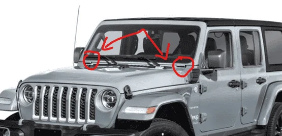

Hi
When you are talking about the 4 bolts that hold the windshield in place, are you referring at the one at the front, outside and below the windshield?
If so, they are perfectly tight on my jeep, I tried the silicone grease someone mentioned above but didn't work.
Jeep Wrangler JL Freedom panel noise-please help!! Pic3

Hi
No, these bolts are at the top of the windshield on the inside. The bolts are located in the plastic trim at the top of the windshield. To get to the innermost bolts (near the rear view mirror) you have to lower the sun visors. The outermost bolts are visible in the corner. I would suggest you use a flashlight to find them, everything up there is black. I used the Wrangler tool kit to tighten them. They are easy to find with flashlight..
