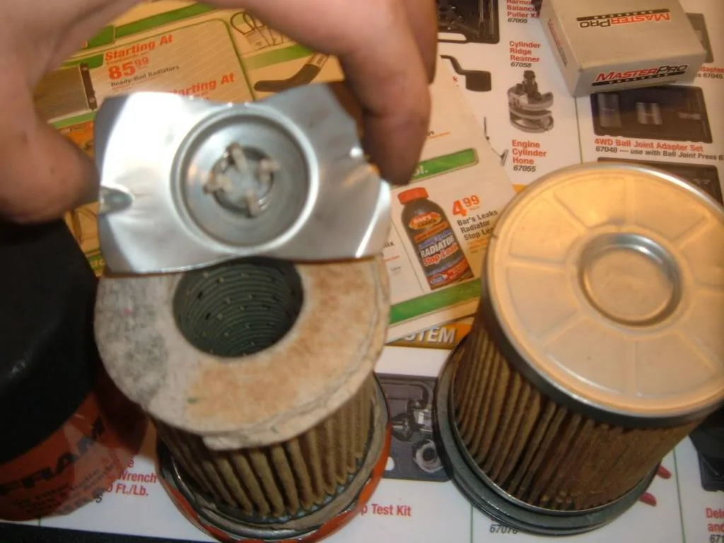

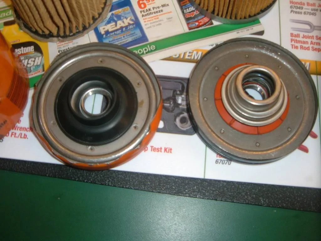

Fram filters always have and continue to be the bottom of the barrel crap filters.
See for yourself. Standard Wix on the right and moldy cardboard Fram on the left. Let the JL Wrangler members judge for themselves what they want to use. Both these filters are at the same price point around 5.00 each on amazon plus or minus a few bucks depending on vehicle.

Everyone associates the metal end cap with quality and the truth is they separate very easily--shown time and time again on BITOG and WIX's filtering efficiency is less than half that of FRAM across the entire WIX line which includes the XP.
Totally get it though, easy to stay with what you know...

I won't argue that their bottom end stuff is ... well bottom end. But the Ultra is a quality part, from what I've seen on the net.
