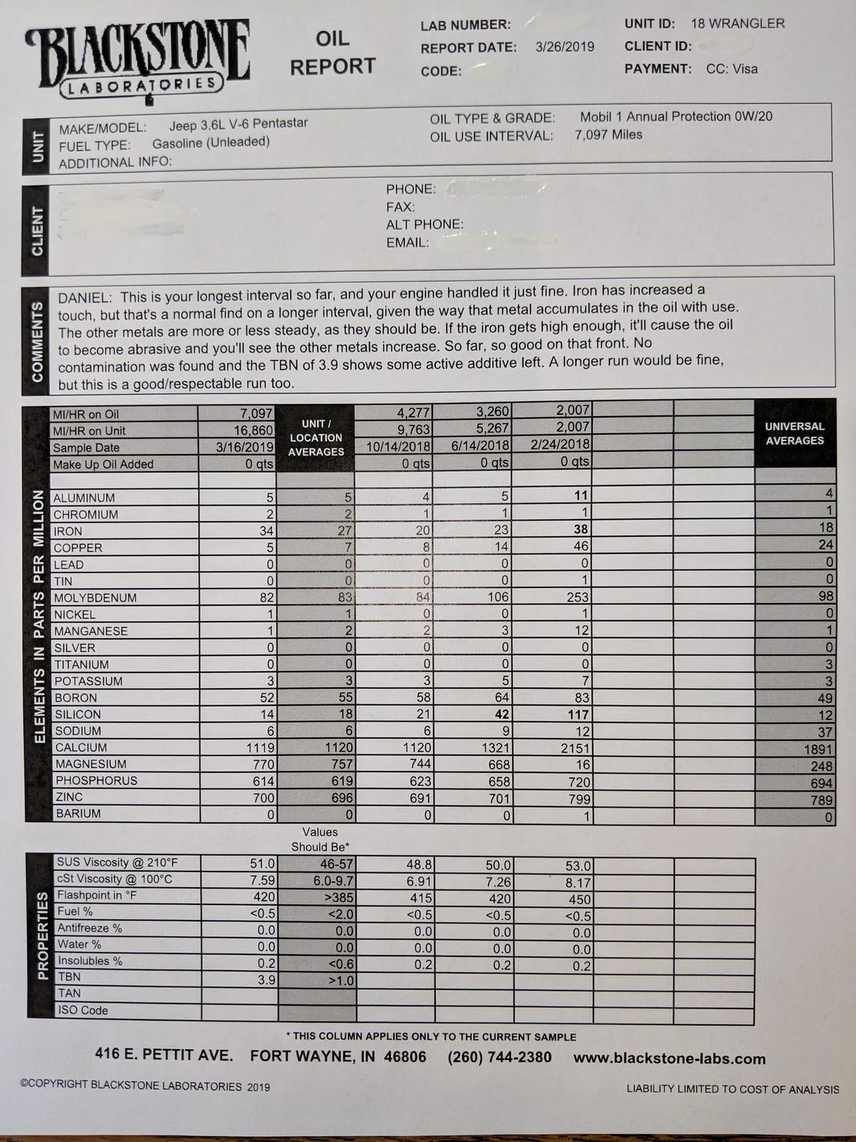

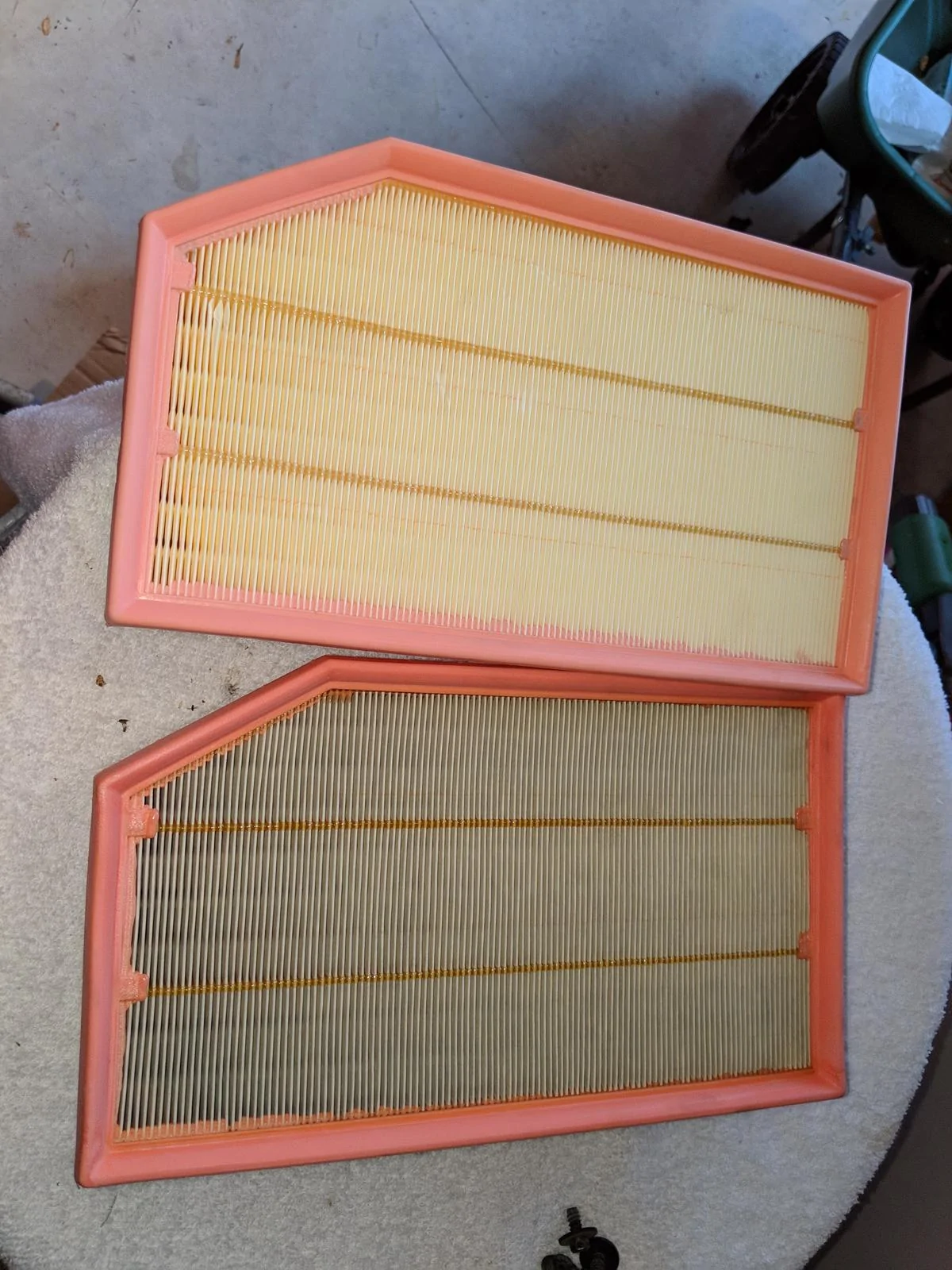

I'm sure you are right. The next couple of used oil analyses will tell the story. The first three had high silicon, but that was likely due to gasket sealers and such from assembly of the engine. It went from 117parts per million in the factory oil, (2007 miles on oil) to 42 in the second oil change (3260 miles on oil) and then to 21 (4277 miles on oil). The universal average for this engine is 12ppm. I'd like to get it down there or a little better. The next oil change might not tell the story as much, because I've seen some UOA's where silicon spiked a bit if the filter was changed. I vaccumed and wiped my air box clean as possible before installing the new filter, and dampened the new one's rubber seals with 303 protectant, so they should be sealed tight as a drum with no air leaks, at all.
I know I'm OCD with this stuff, but it is all for fun. I'll post the next oil analysis in the future. I've got about 5,300 miles on the oil with about 38% left on the oil life monitor. I'm going to change it next somewhere between 10% and zero, if the timing works out. I'll change it sooner if going on an off-road trip, though.
I've sometimes gone 30k on an air filter in my JK, but they look pretty ugly by then, so I've backed off to every 15k miles or so.

What oil analysis company do you use?
Sorry, I forgot to post it. I'll try and do that when I get home. It is Blackstone Labs out of Fort Wayne, Indiana.

Here it is! I also picked up 6 more Mobil 1 oil filters at a different Walmart. I've got about 65,000 to 96,000 miles of oil filters stocked up for this thing. Realistically, it will wind up around 70k, as I'll run 5k to 6k between changes. I may give a few of these away to friends, though, too.
