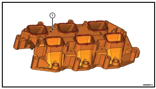

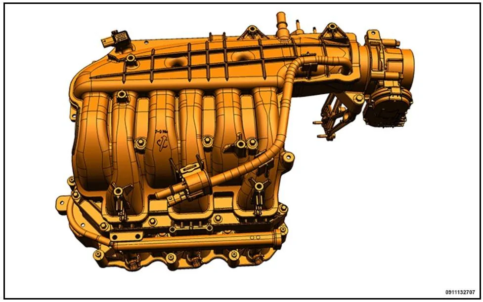

To remove and replace plugs on the 3.6L, just remove the plug wires and pull the plugs. They're in the center of the cam covers like an old hemi.
To get to the oil filter housing/precooler, these have to come off.
There are no plug wires, and one bank of plugs is under the intake plenum.
Yeah, I just watched a YouTube video and talked to a buddy who just changed his and it confirms what I thought. You've got to take the intake off. But it isn't too hard.
I missed that, you're right. Wow. The upper intake manifold indeed does have to be removed....seems like they could have done better. Thankfully we have 100,000 mile plugs.

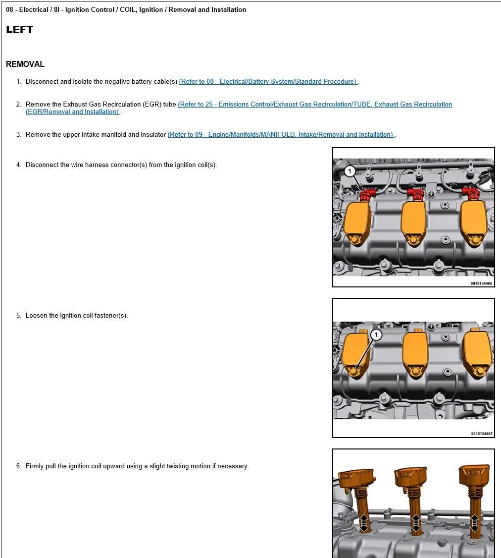

How many decades has it been since you changed spark plugs?

I found that step (hyperlink) to remove the upper intake manifold buried in the coil removal steps.
Looks like about 20 steps in the removal, mostly disconnecting hoses and wires, etc..
And don't forget to stuff rags in those intake holes. My big fear would be dropping something down in there! Lol!
