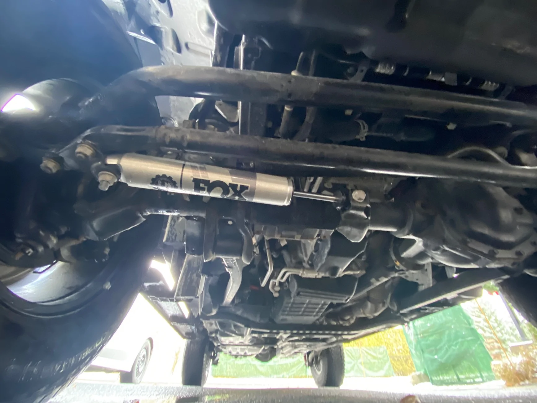

Fox IFP over here. Easy upgrade and it goes well with the Fox 2.0 shocks I installed last week also.
