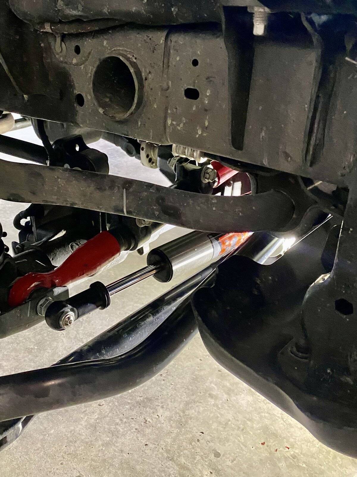

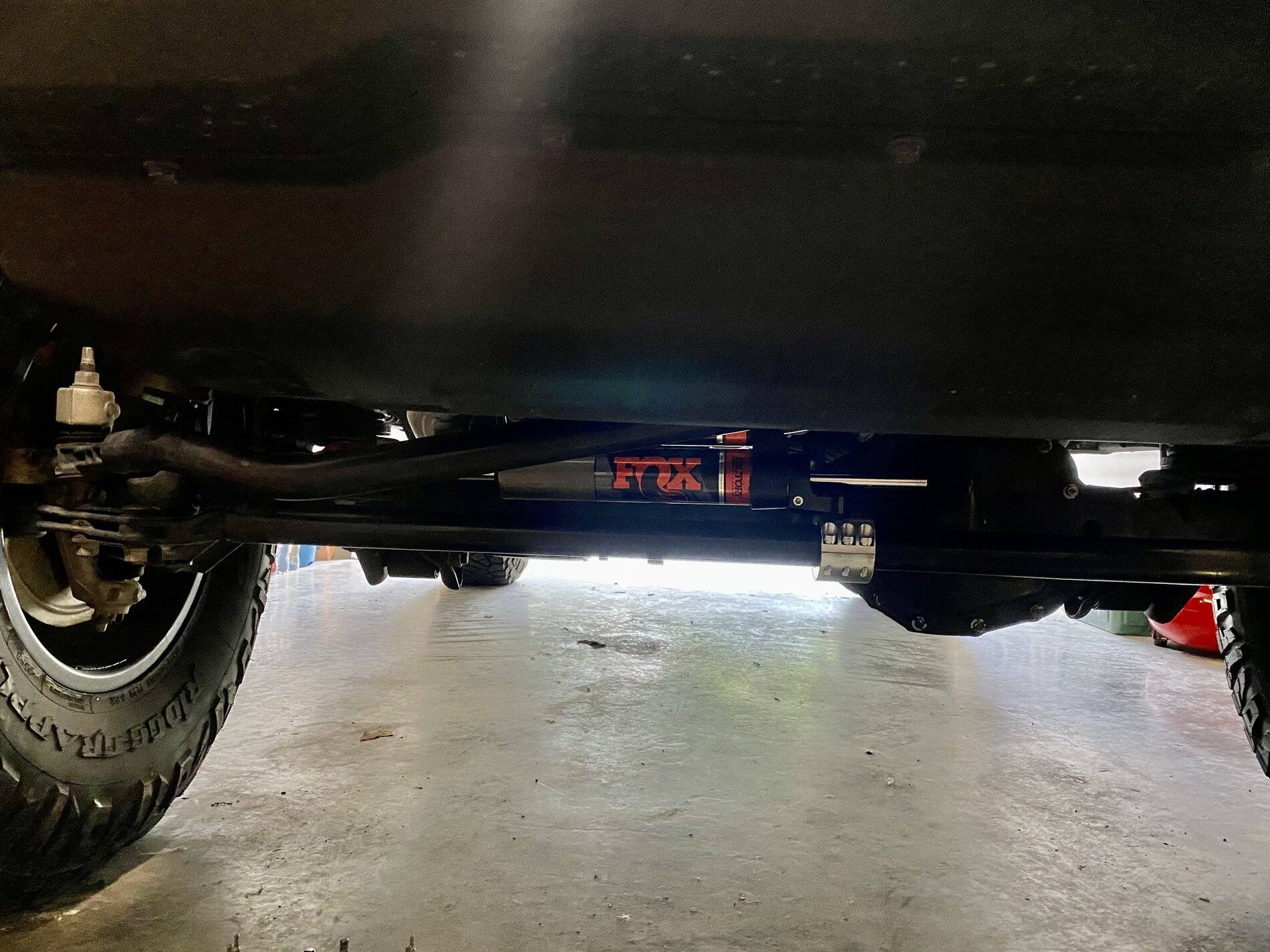

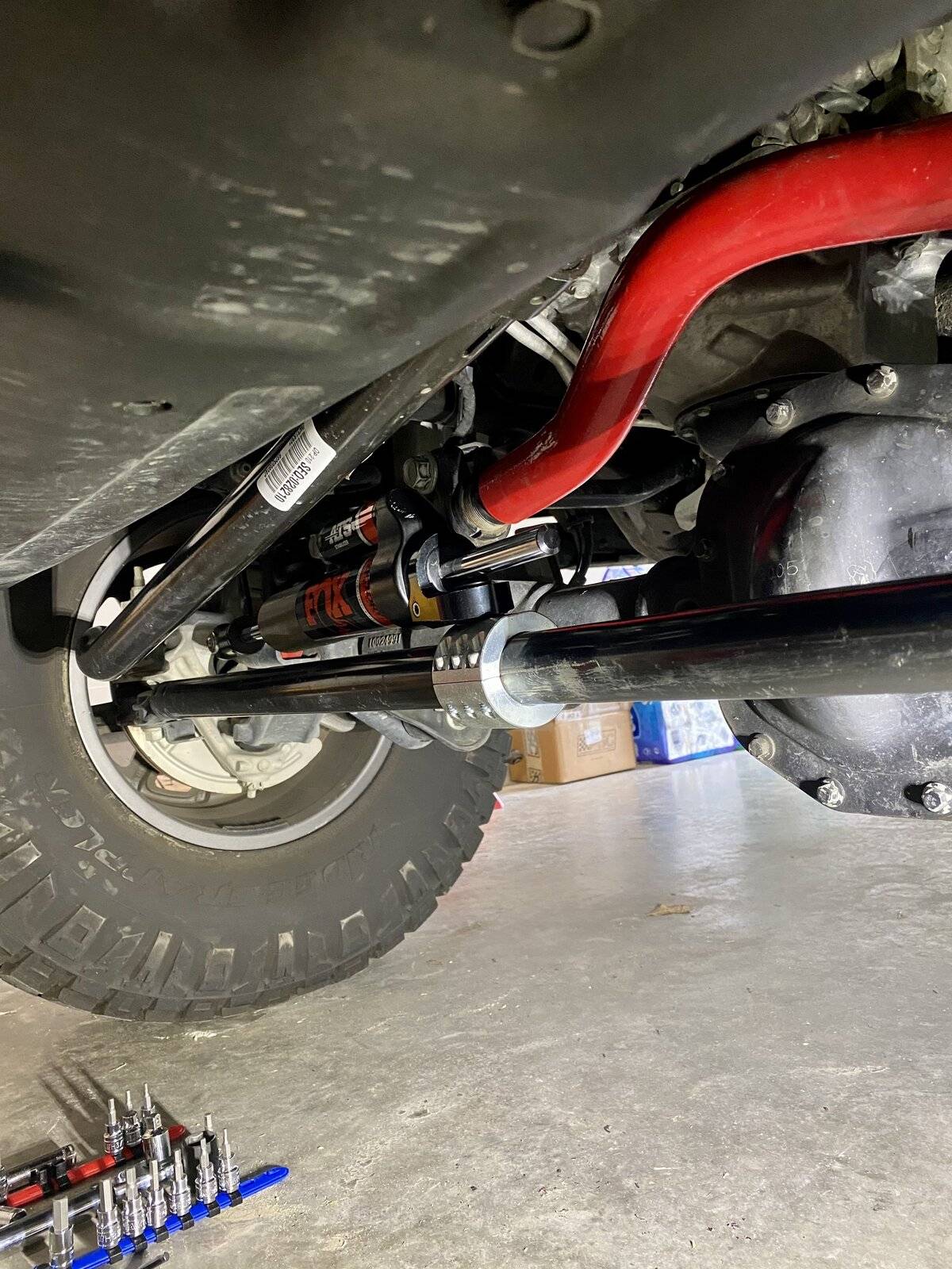

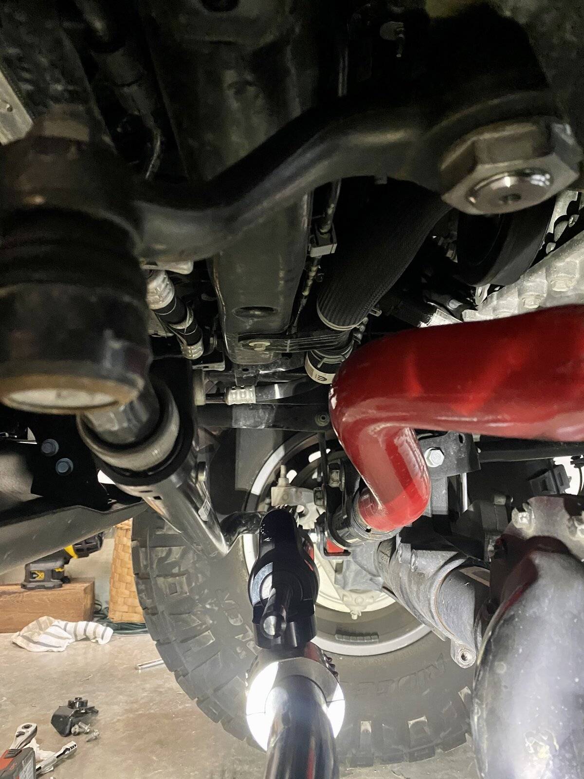

Hey Mike. I’m running basically same with exception of using Synergy Tie Rod clamp. My mistake was buying JL version and then had to go through eliminating axle bracket to switch for relocation ??‍♂. I have stock steering with SS Yeti Pro track bar. Everything fits fine just need to tilt a smidge forward. I am utilizing synergy stud that @Roky posted. Here’s a couple pics showing install. Great product, definitely helps running 37s.
Nice pics. I assume it is tilted forward to avoid contact with the track bar. Any issues with the stud coming loose? Did you use loctite?
I'm leaning towards the Falcon due to price and ease of adjustment.
Correct, leaning a bit to ensure no interference with TB. No issues with stud at all, used blue loctite. I understand dollar situation but ease of adjustment shouldn’t play a role. Very simple to adjust. You have more finite adjustment with ATS. You can tune to your preference. Good luck in your decision. ??
