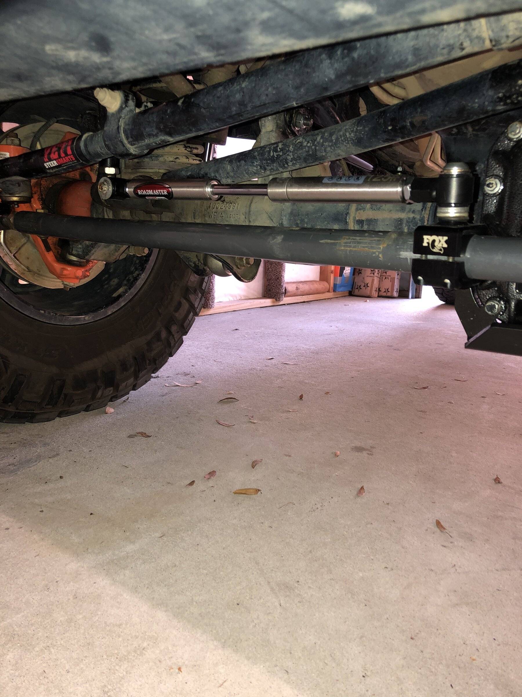

Ok just watched video and he used the Synergy Relocation Steering Stabilizer to move Fox SS up on the bar above it. It looked like he used a different bolt to attach it to the tie rod. He didn't use the same bolt he pulled from tie rod ??????? It was not the Fox 2.0 ATS it was just the normal Fox SS.
OK just watched 2nd one for the Fox 2.0 ATS and he put his on opposite the first guy. The first guy put the base (bottom) to the right and the 2nd 2.0 guy put base(bottom) to the left toward shock. Why the 2 different ways?????
I’m not sure, but it either goes like yours is which connects to the tie rod by the wheel, and connects to the axle in the middle. When you relocate it, now it’s connected to axle on a replacement track bar bolt and connects to the tie rod in the middle like this….
Did you hear that WHOOOSING sound. My head was under it. I see the Fox SS 2.0 ATS has its on bracket that moves it like you used it for the Roadmaster you have now. So when I do break down and get 37's I should get the Fox 2.0 ATS not the TS like this video?
