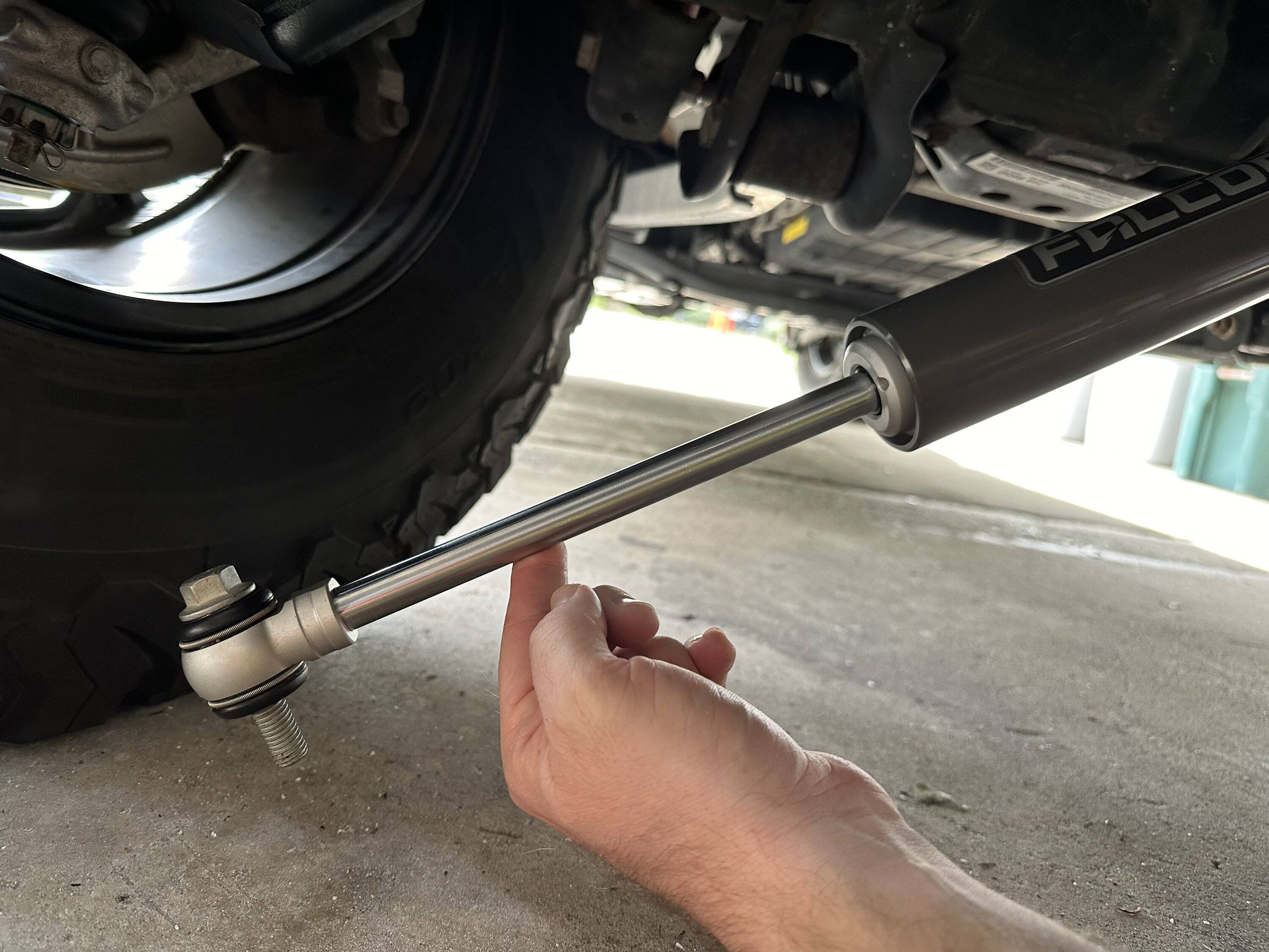

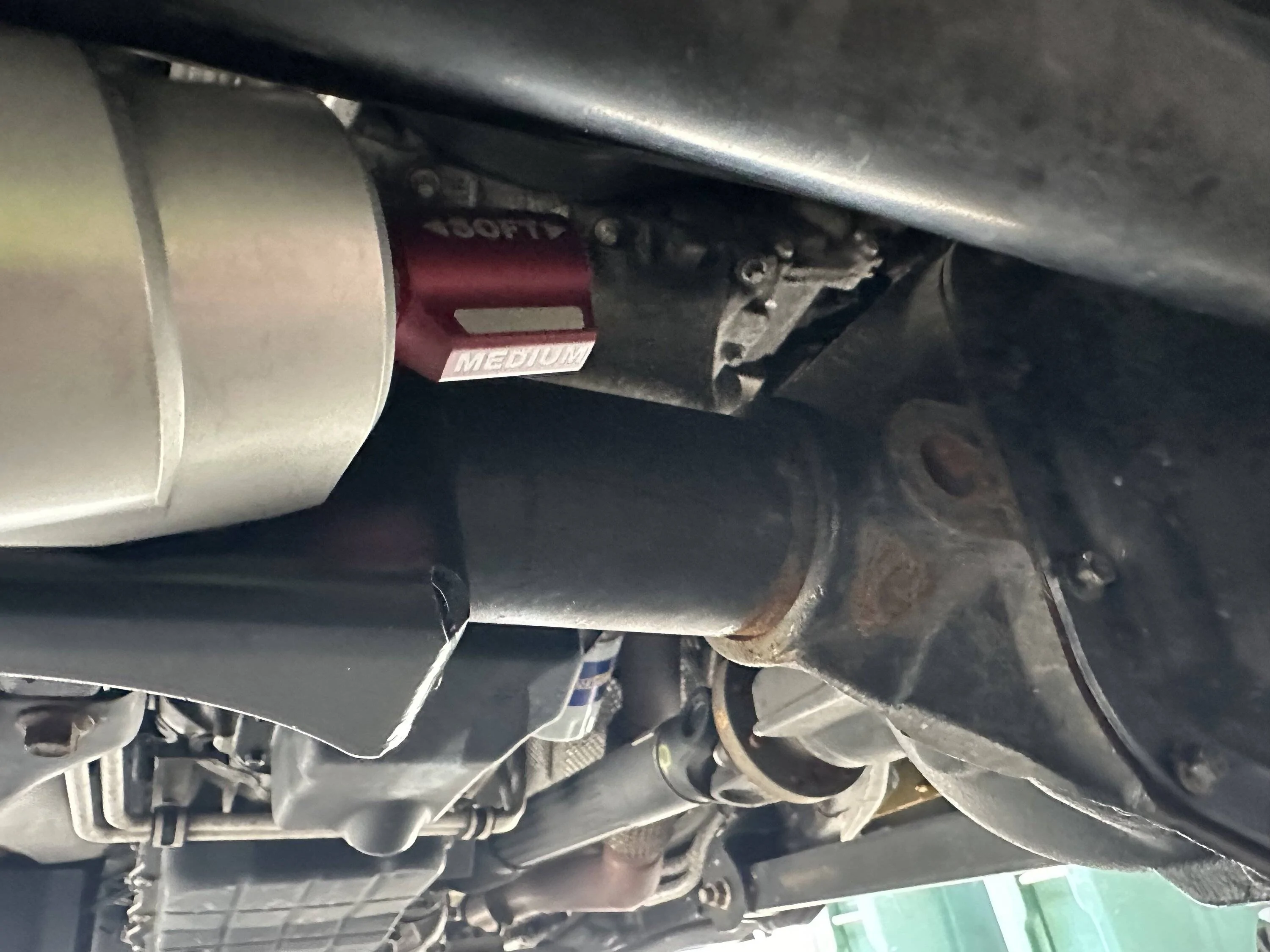

I’ve got a Teraflex Falcon 2.2 Steering Stabilizer I am attempting to install on my wife’s jeep. It’s currently mounted and ready to finish the install, but it seems like no amount of force in the world will get the piston to compress so I can line it up. I have turned the tires as far to the right as they will go to try and get it in the bracket, but it’s still not far enough.
If any have had this issue or something similar, please let me know. I’ve seen issues with the adjustment knob being incorrectly installed, but even trying all the settings makes no difference and I cannot get it to budge whatsoever.

Not sure if I can delete this, but problem solved. The shaft was rotated before delivery as others have experienced, but seems to have been rotated more than 180 degrees. Eventually got the right rotation of the shaft and it all started moving as it is supposed to. Thank goodness!
