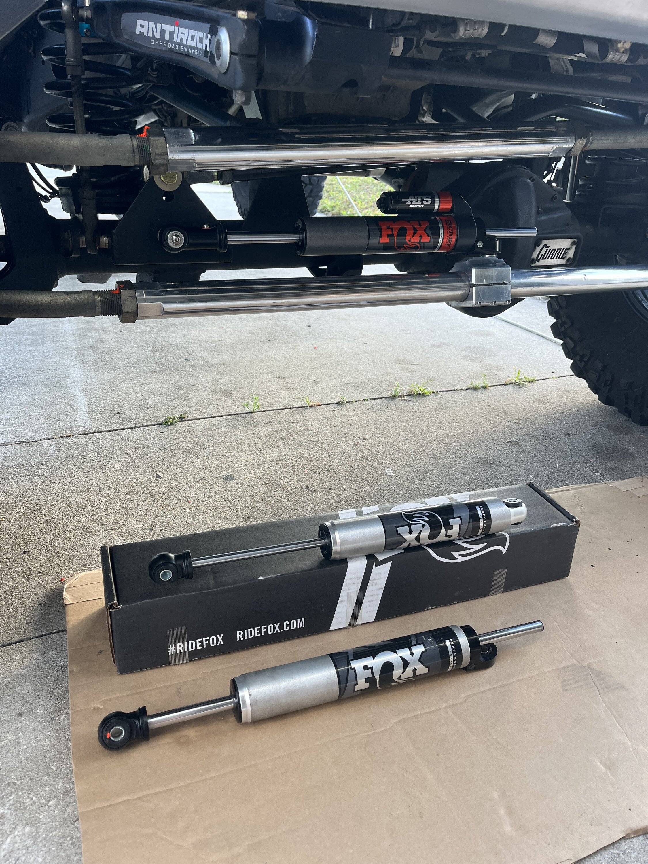

I’ve had all three Fox brand-my original TS got a dead spot that I only found after I took it off and cycled it by hand , then I borrowed a standard shock one while I waited for the ATS to arrive.
I’d 100% recommend getting the ATS.
I run it at 20 clicks for freeway w 40” tires, and softer for off-road.
It goes well w the Fox 2.5DSC shocks so I can make changes to everything depending on conditions.
