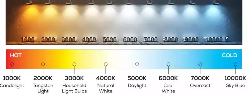

For the OP's needs, not ideal, but putting a warmer temperature (yellower) LED replacement bulb in the stock halogen housing might help a lot. Some of those cheap LEDs are just too bright. I'd stick with a replacement brand from Philips or Sylvania or another generic automotive headlamp brand to start. You can buy them at auto parts stores. The packages typically list the "temperature" and indicate whether they're bright white or farther down the color spectrum into almost yellowish.

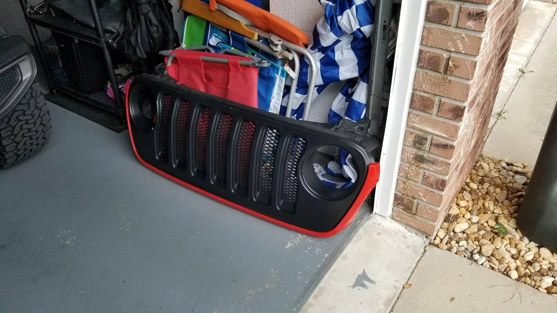

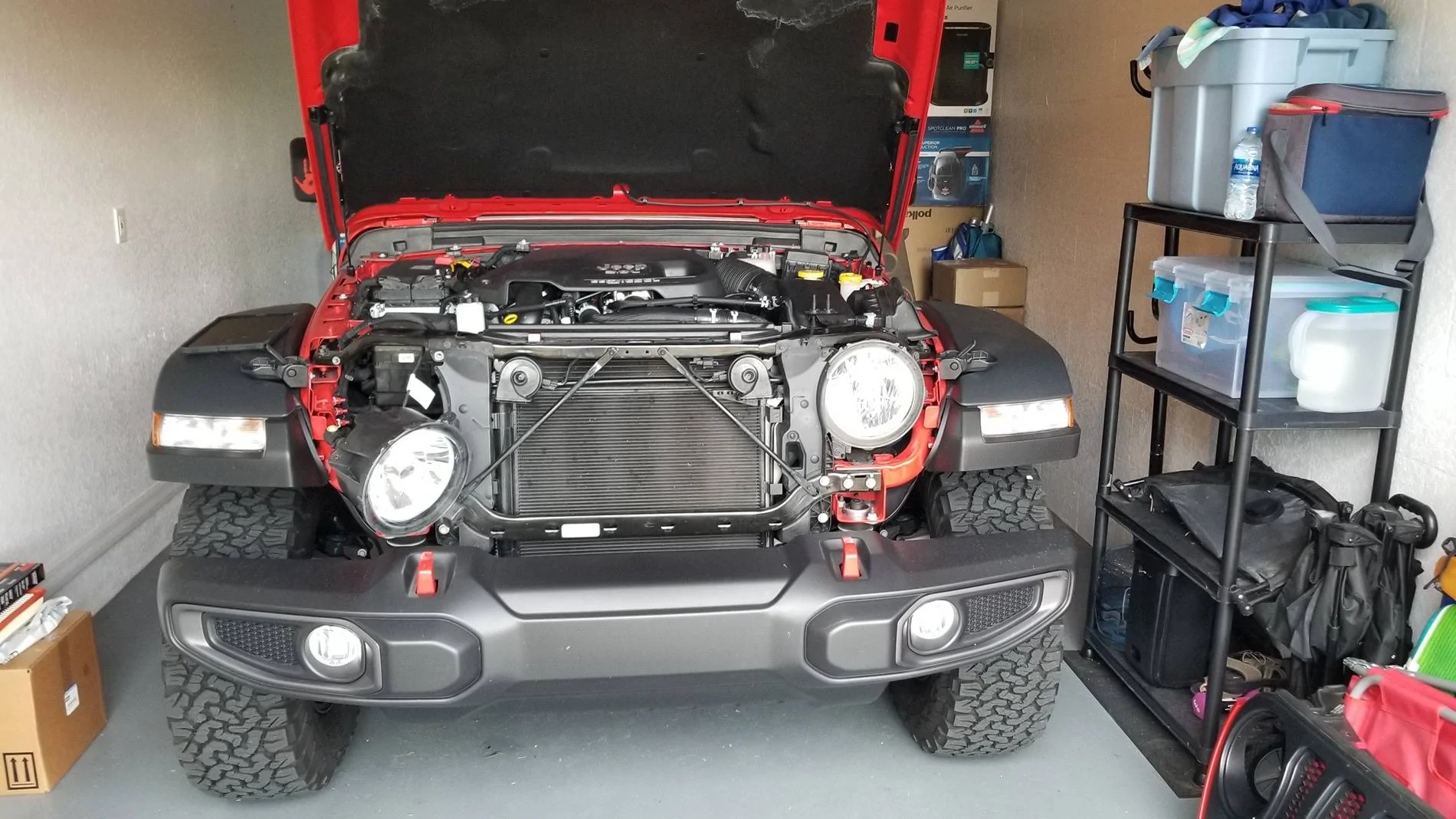

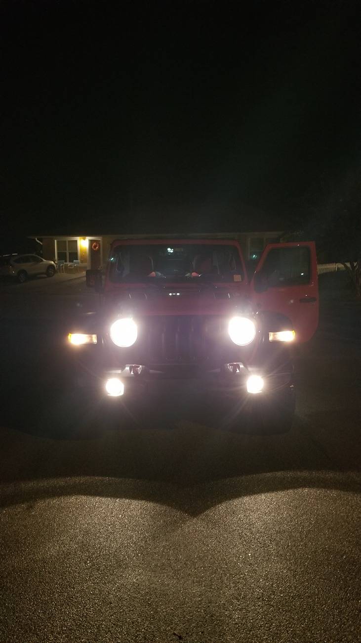

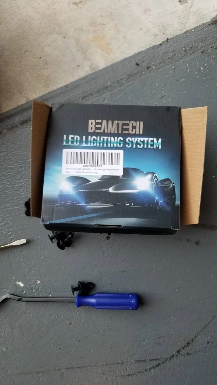

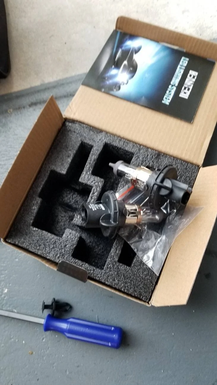

Hey đź‘‹
It's getting difficult the older I get to see at Nite.
I was shocked at how poorly these factory Halogen lights performed
I decided to try the similar option above @roaniecowpony suggest in video
I bought these on Amazon, install took 60 mins, because I'm careful, it was easy
Total $60 ish
Beamtech was the Brand, literally plug n play easy
I aimed these at a closed liquir store locally with a huge side wall & flat level hahaha
I specifically aimed DOWN towards road. It's been perfect 🥰
I have WAY better vision at Nite, without blinding other Drivers 👍
Pics of install below i think.
