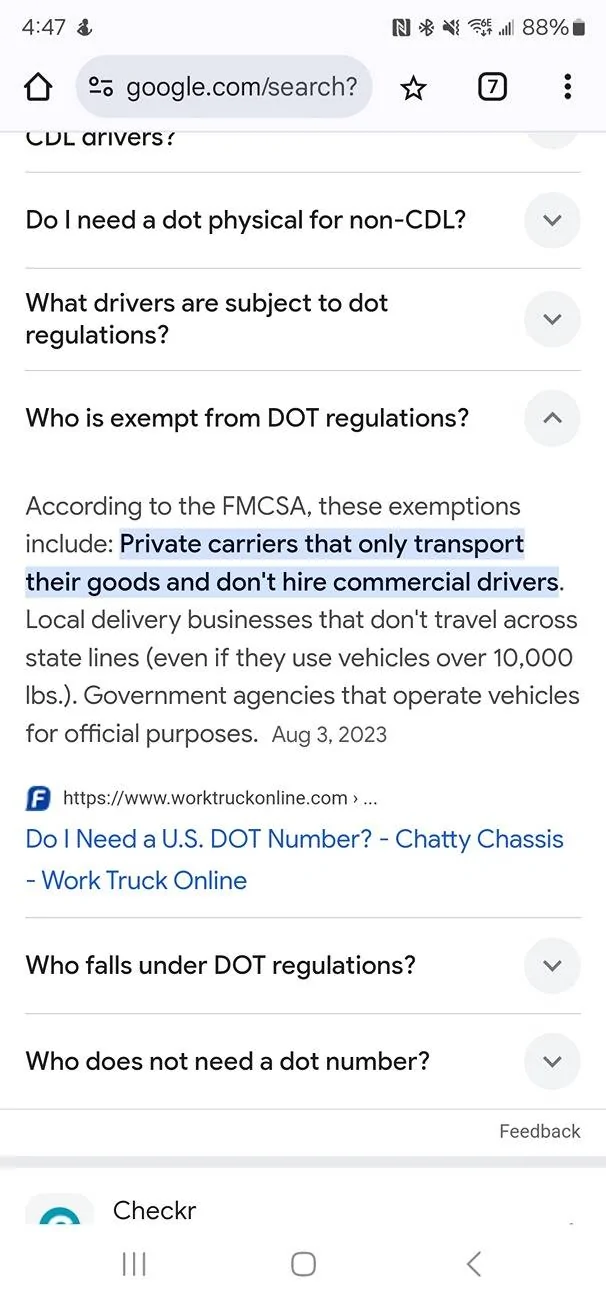

Actually vehicle headlamps are regulated by the US DOT. Unless the replacement bulb is DOT approved for use in the specific lamp / reflector it is installed in then it is illegal. You won’t get a ticket most likely because cops have a hard time being able to verify it’s an illegal bulb but it is illegal as per the DOT regs. It's not illegal for you to replace the bulbs unless it's a commercial vehicle.
DOT regs don't apply to non-commercial drivers. That is why you'll never get a ticket for changing your headlamp bulbs or beadlocks (unless your state has a ban on them).

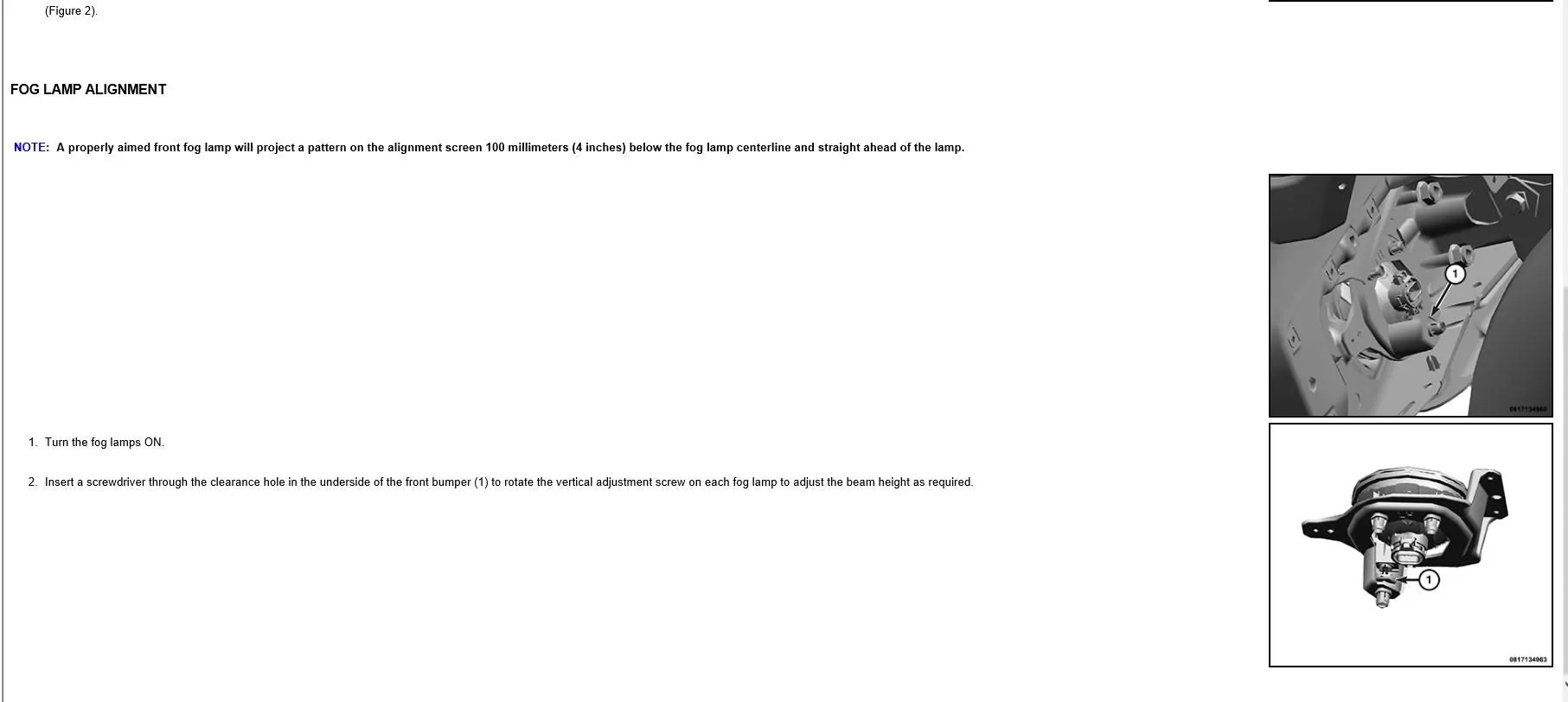

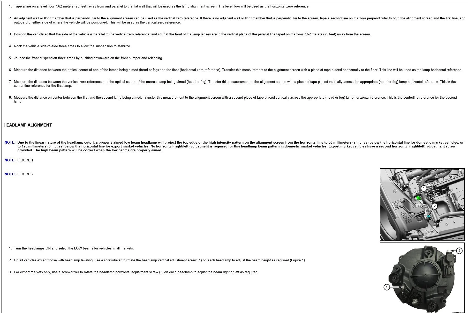

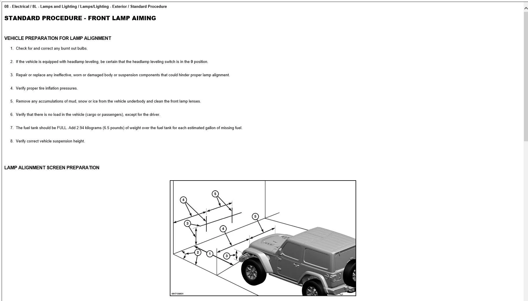

This is the headlight aiming procedure from the Jeep OEM Tech Authority Service Manual.
Seems dumb, especially with as soft as the stock springs are to suggest removing all cargo and passengers aside from the driver. My tools, recovery gear, and air compressor are always in the back of the Jeep. If I was still on stock springs and pulled everything out to aim the headlights they'd be at least a foot high at 25' when I put it all back in. I'd suggest aiming them in whatever you're usual driving condition is. What's worse, aiming empty and blinding people 99% of the time or having your headlights aimed too low on the off chance you clean everything out for some reason?
