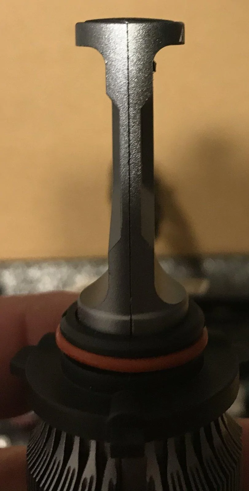

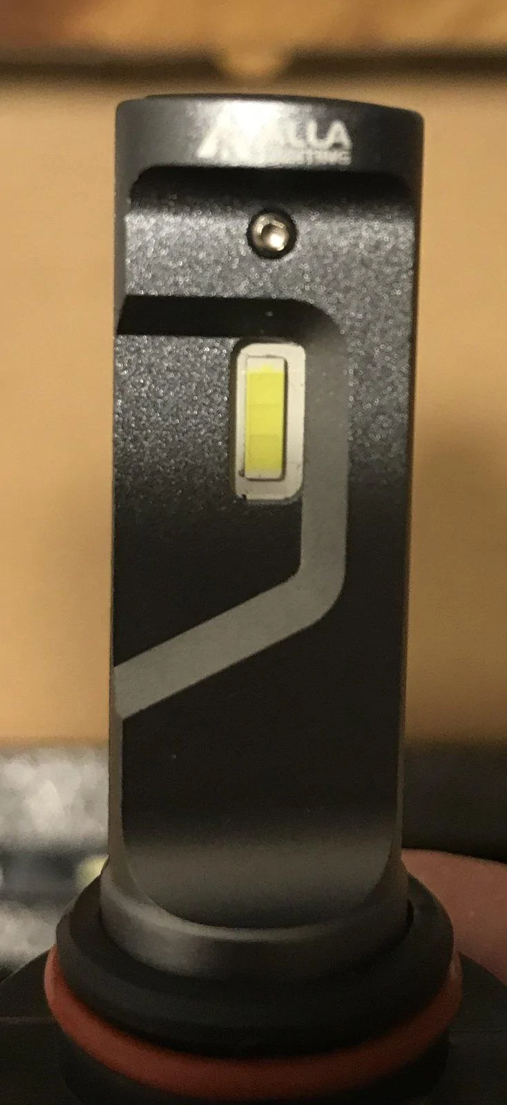

actually, I'm going to call BS on this post: after considerable research, there ARE LED bulbs that will work just fine with factory reflectors without excessive light scatter: I have them in my headlights (h13) and fogs (h8) in my pickup. they replaced aftermarket HID kits & there is a night and day difference between the amount of light scatter of the styles.
basically, I"ll let you know the style to avoid at all cost & the one that you should be looking for.
Primarily, and this goes for most led replacement bulbs, avoid at all costs, the ones with the diodes completely surrounding the bulb: this is where all the scatter comes from & with these type of bulbs, cannot be prevented.
the type to look for is the type that are more flat with led chips that are basically back-to-back: and the closer they are together, the better light pattern/less scatter. one of the reasons that this style works is that the chips are aligned consistent with the position of the factory bulb's filament (the filaments in each style of bulb are "tuned" per se to the reflector, so when you align the chips with the height of the filament & then direct the light from the chips to the sides, it creates a more factory style beam pattern with less scatter)
when I had my HID'S in, there wasn't a time that went by, even during the day that I didn't get flashed at least once: once I switched out to the proper led bulbs, I have yet to be flashed (unless I accidentally hit the switch for my 54" light bar & don't realize it :facepalm:).
I have had my led's in my truck for the past 3 years & they're still as bright as they ever were & without the scatter, far better than even my HID's). pics are of the style I'm running in my truck with absolutely zero scatter:
