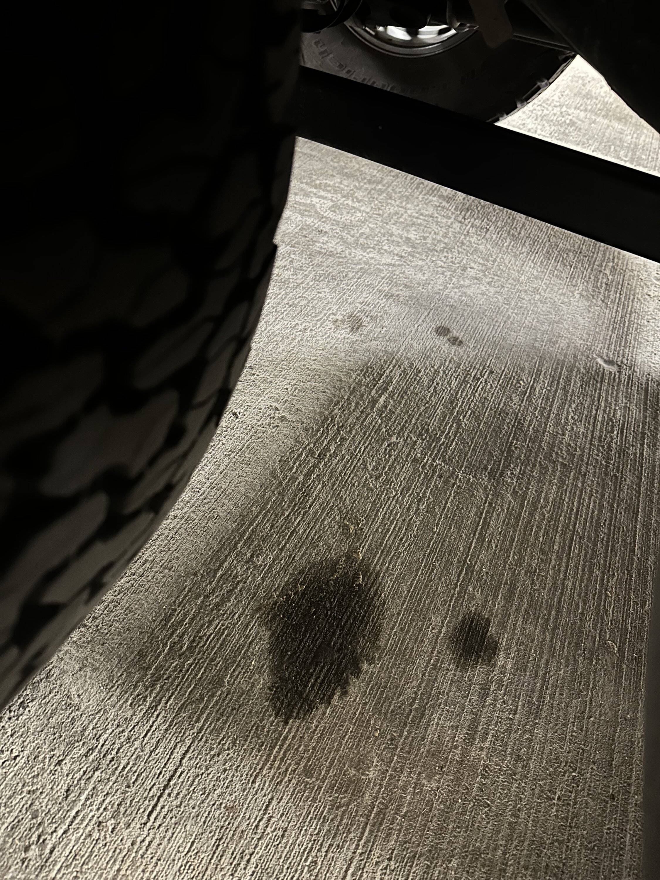

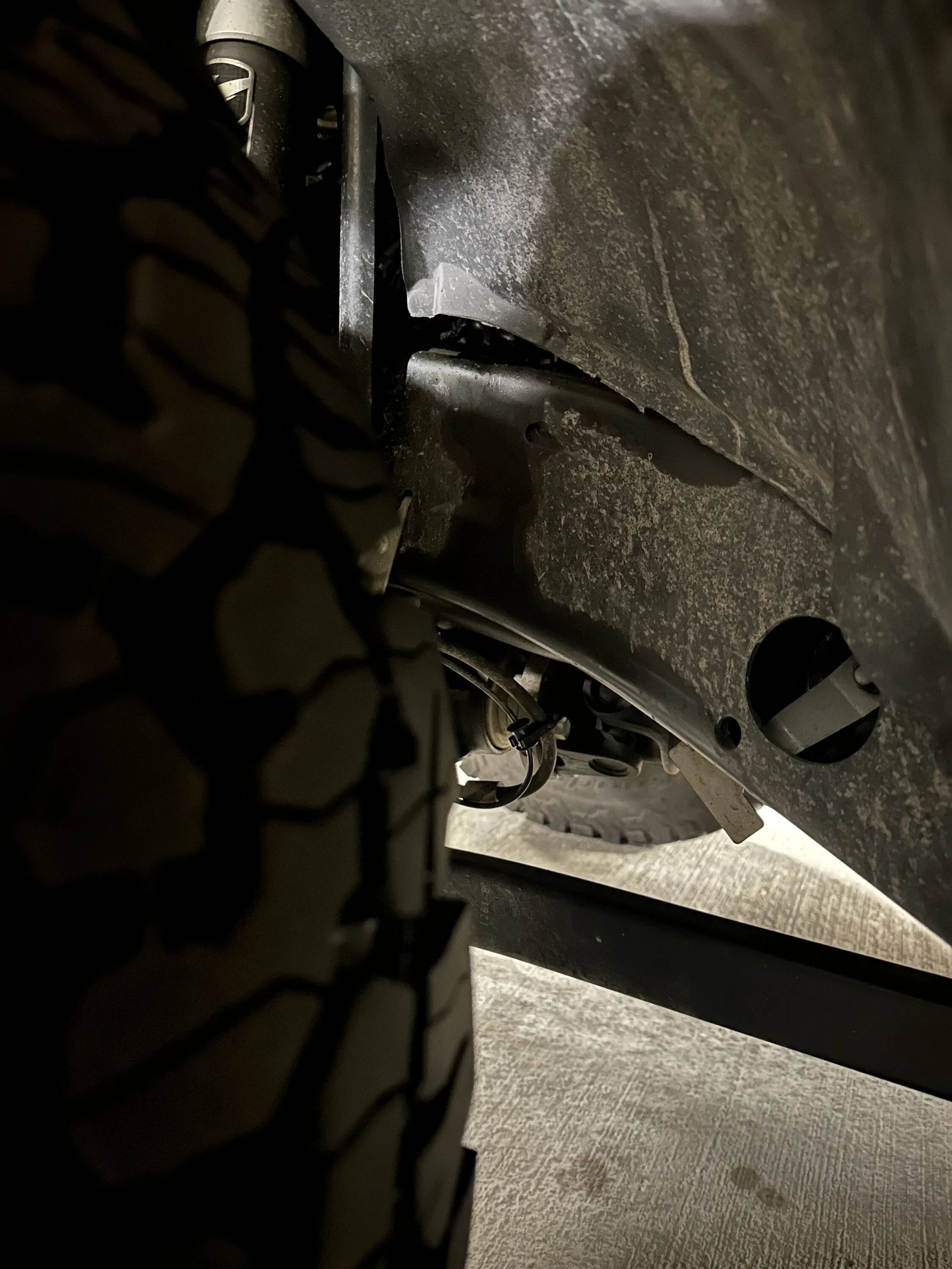

I've searched through the diesel forums to see if anyone else has had something like this, and I haven't seen anything similar. I've got some kind of fluid leak getting onto my driver's side frame. I don't see anything particularly wet around the engine or above where it's wet on the frame...

I did have an oil change done pretty recently so I'm hoping it's just a lazy tech that didn't clean up excess oil from changing the filter? Not sure... I sprayed it all down with brake cleaner and I'll take it to the dealer if it starts to get wet in that area again. Oil level was on the lower end of the dip stick, but I also checked it cold so I'm assuming that's normal. I've got 17k miles and haven't had any issues before.

Looks like oil to me. Don’t know much about the diesel; is the oil filter near that area? If so, based on your photo of the fender liner/frame it looks someone potentially made a huge mess when they changed it. No way you’d get all of that cleaned up enough to not have oil spots on the ground afterward.

Yeah the oil filter is right above it.. reeeallly banking on that being what it is because I've got a huge month long trip planned for Feb and cannot have this thing in the shop for weeks waiting for parts.

In that case I'd be almost 100% certain that someone probably just made a royal mess when they changed the oil and didn't clean it up or didn't clean it up well. Also, that looks like old oil to me. I wouldn't sweat it at all.

Waiting for oil to drain down into the filter housing means backing out the filter first and most techs start with draining the pan. They should at least know to stuff a rag underneath the housing before pulling the messy old filter out of the engine compartment.
All in all, I’d agree it doesn’t look like anything serious outside of a cosmetic mess issue.

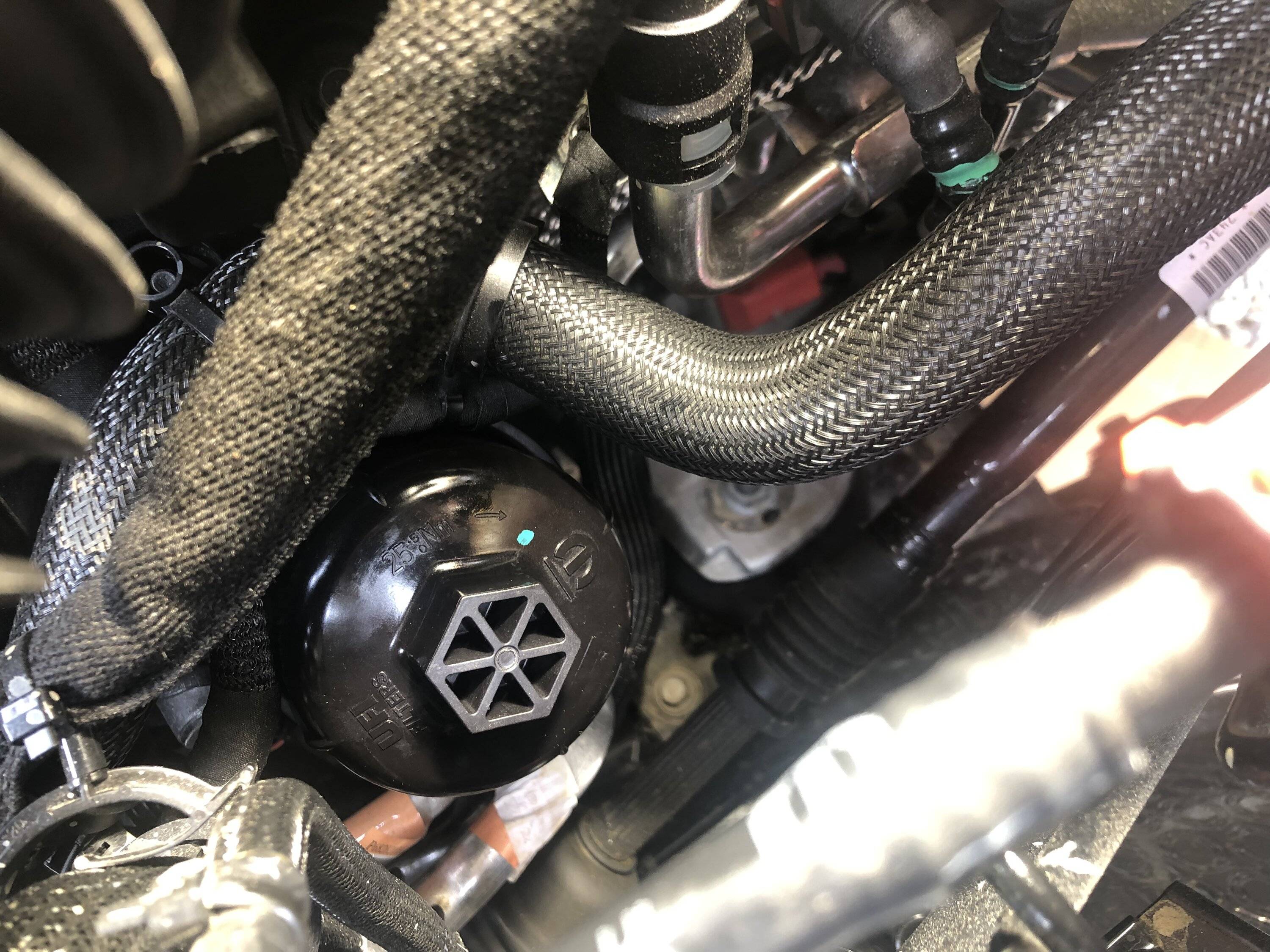

The way the 3.0 diesel filter housing is it sits on an angle, I’ve seen videos as suggested by other members to basically loosen up the filter but not to take it out completely, just leave it be to drain in the housing while you finish up other tasks, in our diesel case you can drain the water filter separator or even change the fuel filter during the time you wait to let the oil filter drain, keep in mind dealers are just looking to push out this quickly so they can move on to the next vehicle so it’s very likely to have some oil drain on the engine while taking out the filter if proper towels or something hasn’t been put in place prior to removing the filter
