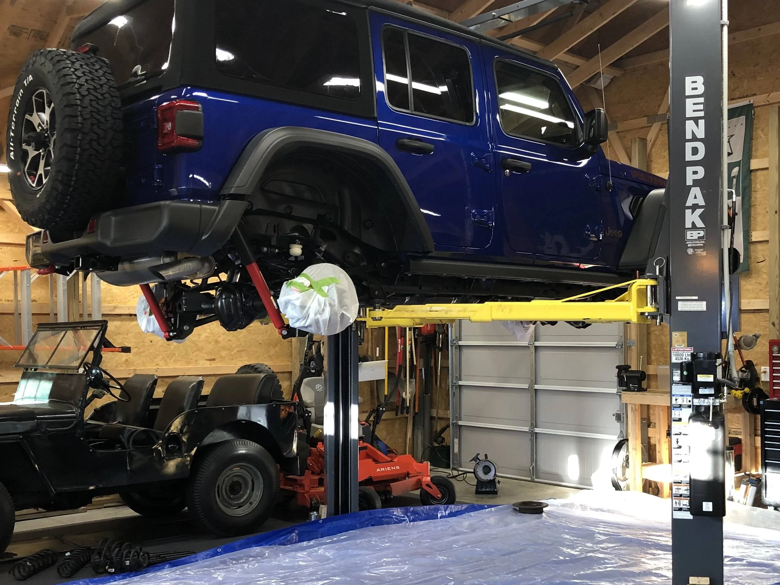

The only place I don't intentionally spray are the rotors. I don't spray the exhaust but it gets a lot of overspray so I just let it be. I end up using an entire gallon with a little bit leftover.
If you get it on the exhaust, it will smell and smoke but that's about it. I don't drive much, but I think after about three weeks, it's about gone from the exhaust. To my surprise, I saw it dripping from the pipes still after about the 4th trip to the stores. I would had thought it would for surely had melted off by then but nope.
I also use the original formula. Black costs more, and while I don't know, I have a feeling that it's just going to get covered in grime in a month or two anyways.
