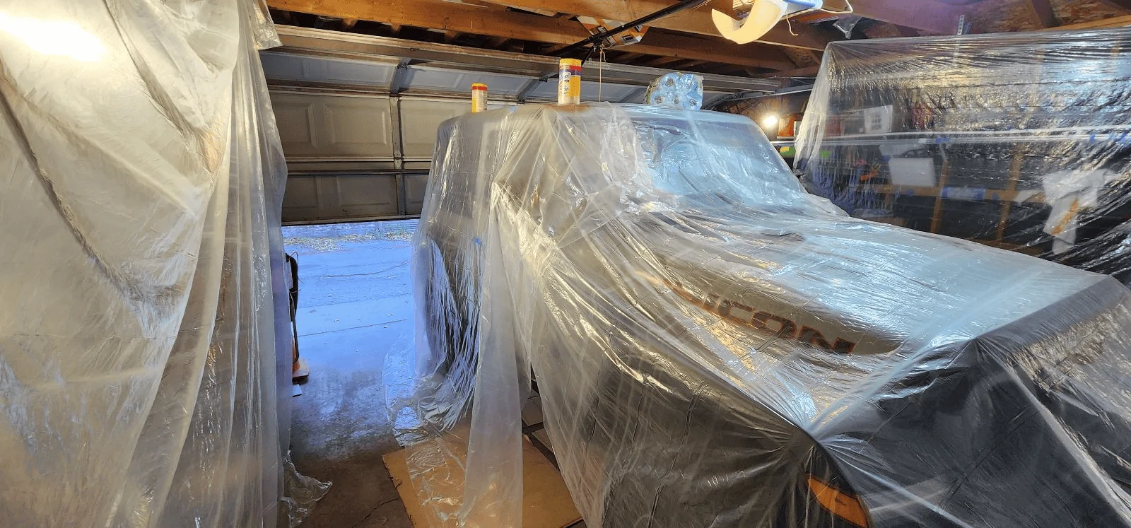

How is everyone applying it? Do you use the spray cans? If you buy bulk, what equipment is needed?
I ordered the kit from Woolwaxusa to use with compressor for about $150.... spray can, 2 extension wands wands and 4 bottles of woolwax.... I used 2 bottles on the first application last year and pretty much had setup like shown in this video minus the lift.... I have a small work space so the prep to keep the mess to a minimum took the most time
