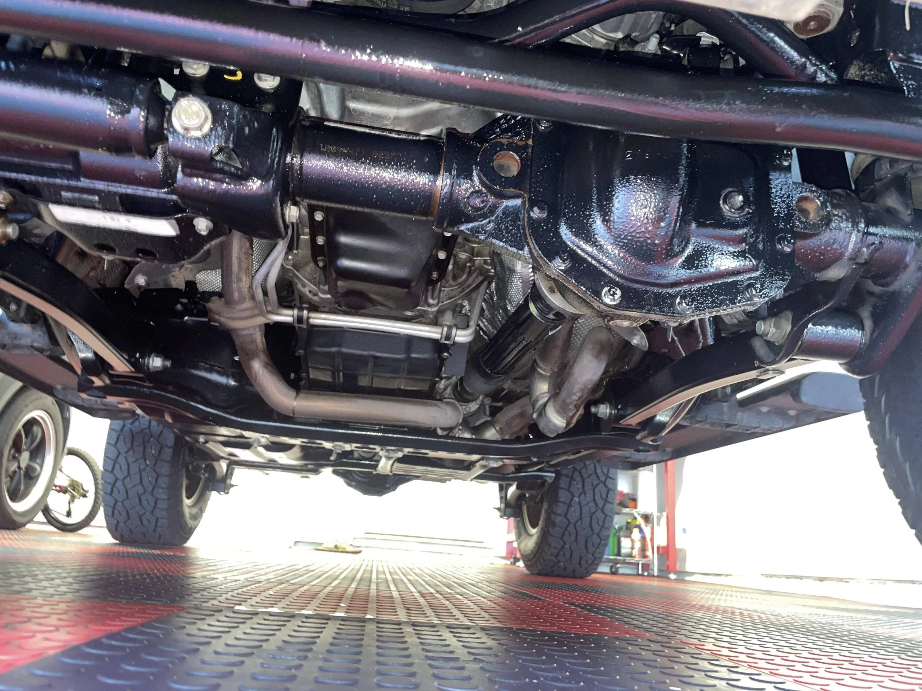

Cover brakes and rotors with trash bags and go to town with the film. I try to apply once a year before winter. My undercarriage is perfect 4 years into ownership.
Is that lift drilled into the concrete or free standing?

Any lanolin-based coating will work fine. I like B'laster Surface Shield, simple aerosol spray. Prior owner used it, and I reapply annually to both my vehicles. Looks like new at 80k miles.
Jeep Wrangler JL Fluid Film question 375702354_334535082359406_1877156533249697768_n
I think it is suspended from the rafters so you can swing your Jeep back and forth and stay in one position while you spray. Only joking with you, it would be insane to put up a two post lift without the correct anchoring. We even did special block pours for our Jib cranes.
