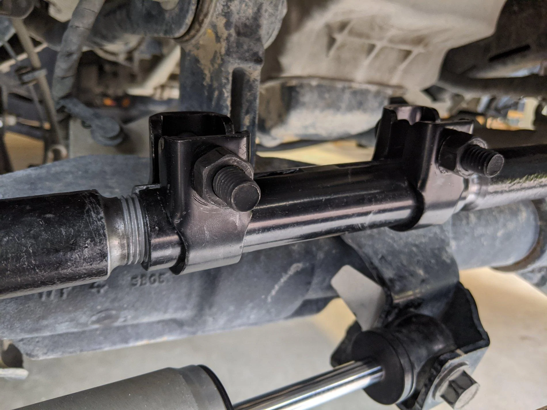

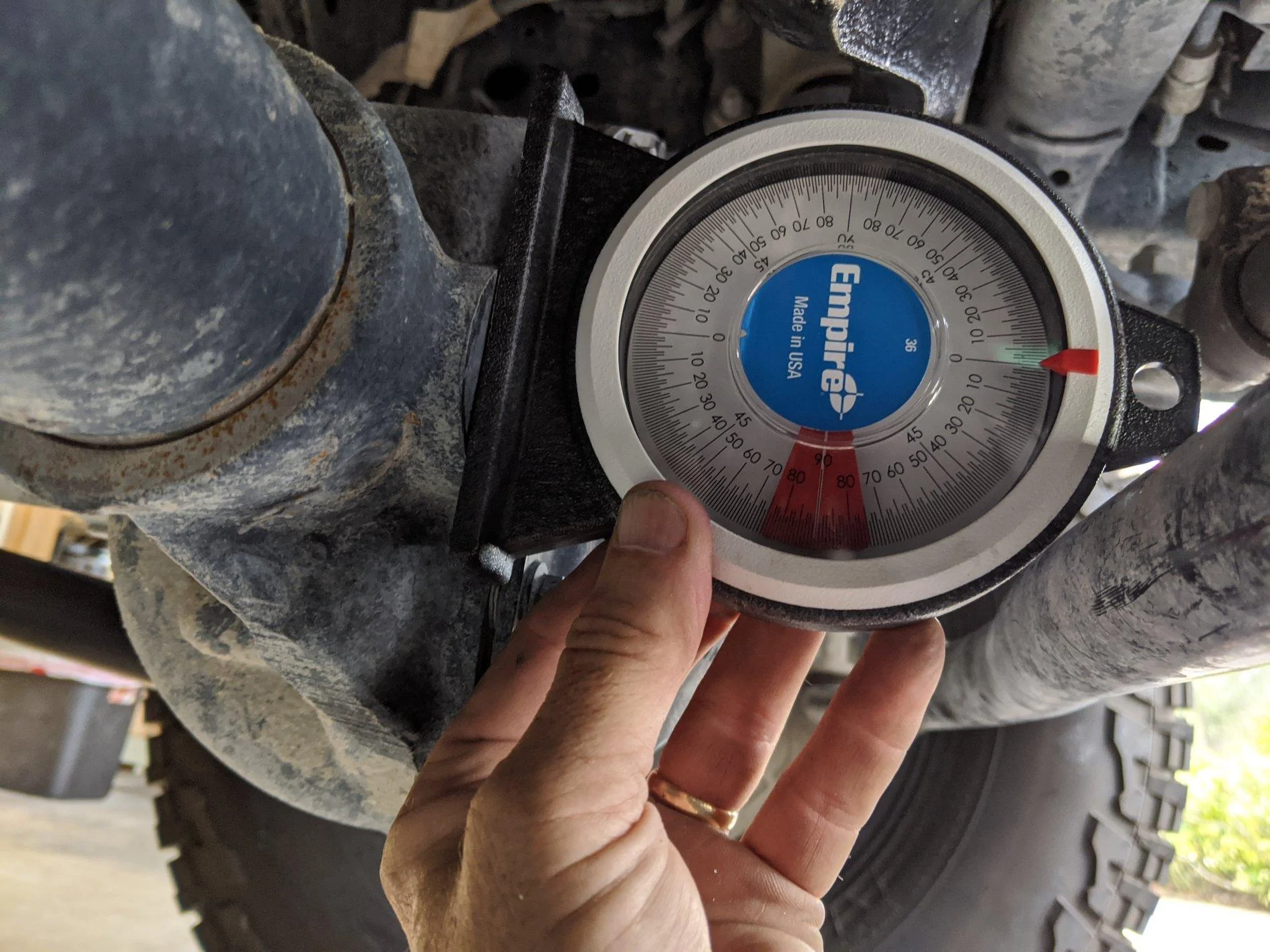

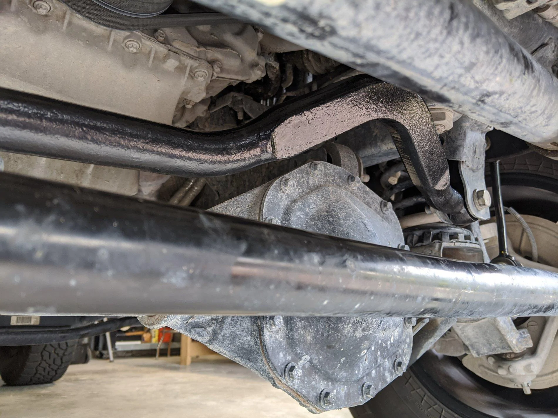

Today I installed Rough Country's front Adjustable Lower Control Arms and front Adjustable Track Bar. I had recently added an extra1/2" spacer lift all the way around (I already had 2" up front, and 1.5" out back), taller bump stops, and Teraflex shock extensions. With the taller amount of lift, I was starting to get concerned about the loss of caster, and my front axle was also off center about 1/2".
Everything is squared away now! The front axle is back where it belongs, and it looks like my caster is right around 6 degrees. I will say that the Jeep was tracking 'okay' before these latest upgrades, but its definitely better now. I purposely did one upgrade at a time so that I could gauge what mod made the most difference. In this particular case, the heavy duty RC front adjustable track bar really makes a difference. It's hard to describe, but the Jeep just feels more solid and grounded to the road.
A special shout out to @Roky for all his help. We must have exchanged 100 texts or more over the past week or two. Roky is The Jeep Suspension Whisperer...:). Thanks buddy!

no problem, anytime ......rigs looking good.

If you didn't during install, Check your clearance at full tuck. My yeti bar clamps needed to turned a bit to clear hoses and such. I have slept since the install so I can't remember what had me worried.
Your rig is looking great and I have no doubts more capable Have fun out there and stay safe.
