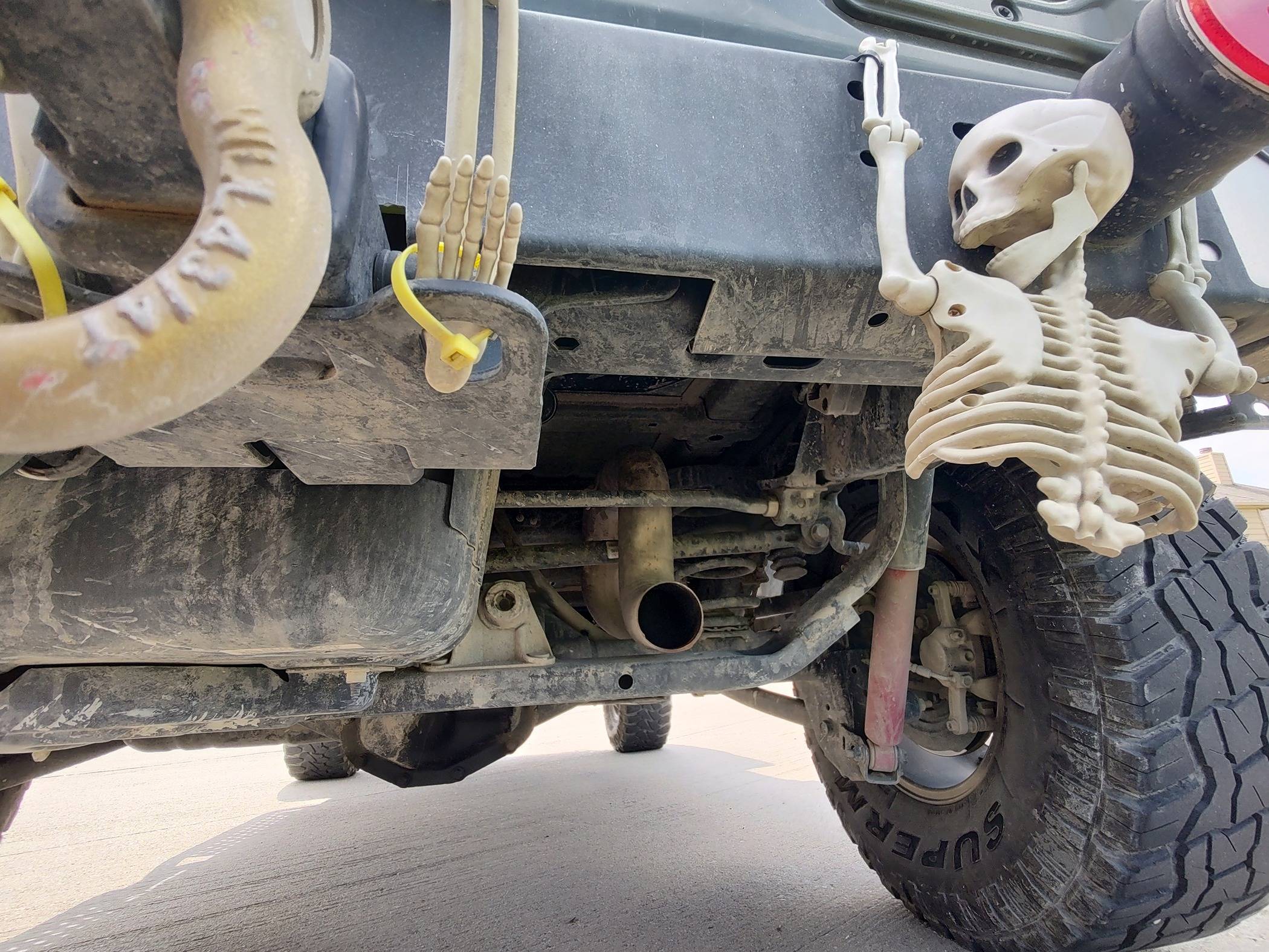

Jeep Wrangler JL First regen today. 35k miles. IMG_20240430_160847112_HDR

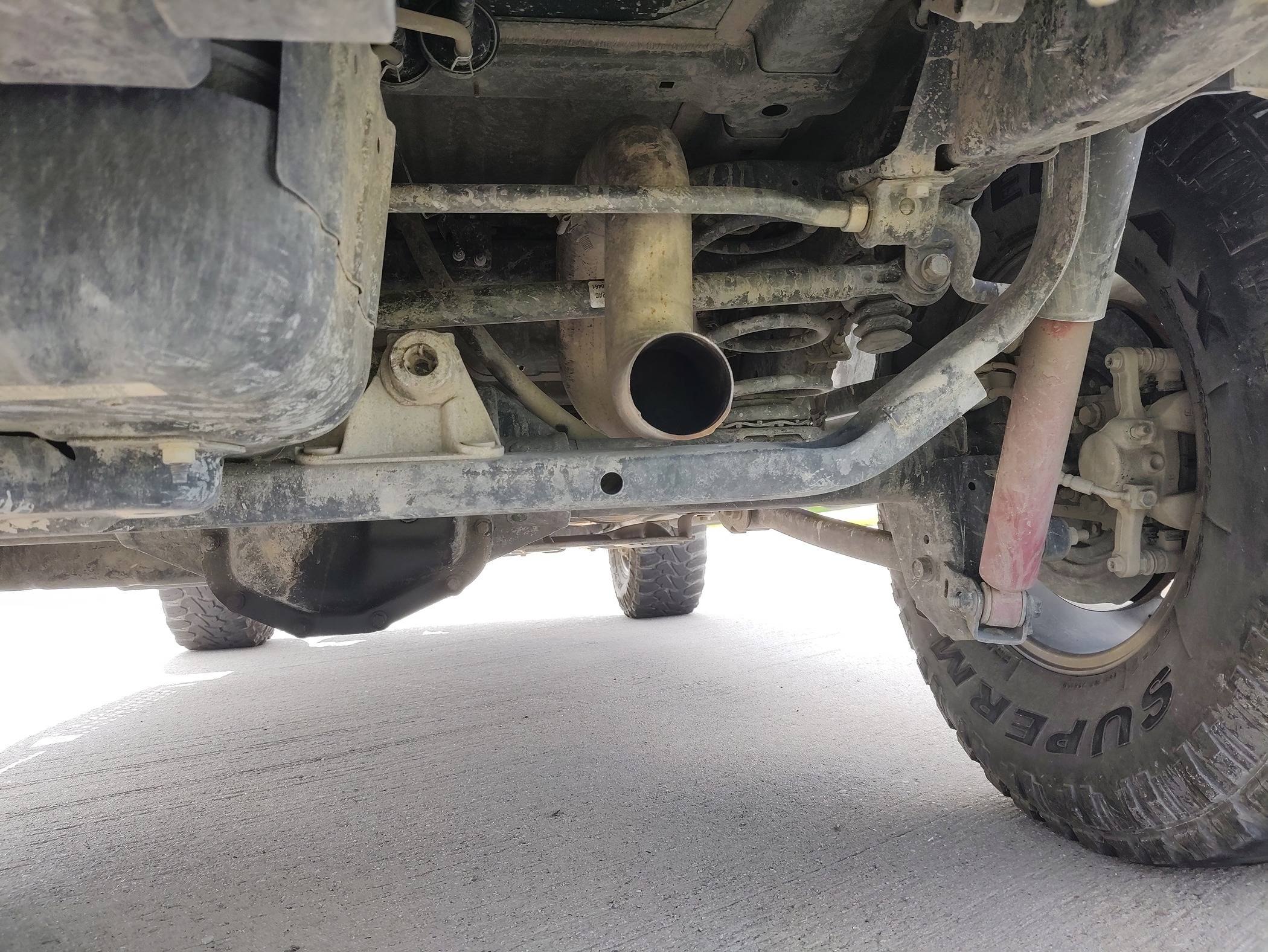

Jeep Wrangler JL First regen today. 35k miles. IMG_20240430_160833758
I pulled off my muffler two summers ago, and then two winters ago I was driving around in the snowy weather we had, and didn't even realize what a regen smells like. I didn't have my horse stall mat installed at that point, but I did have the tailgate removed along with all of the train plugs.
I'm going down this country road covered snow, sliding all over the place, then all of a sudden I have this feeling that I can't breathe, and all I can smell is bleach. I had all the windows closed but the tailgate was open. I opened the windows, and the smell wasn't going away. I was driving slow and I initially thought I had driven into an area that had some sort of chemical leak and I was going to die. Pretty quickly I went into fight or flight mode and that's when I realized that I was going through a regen, and my first thought was drive faster to get it out of the vehicle. Thankfully that worked and I'm here to tell the story too.
You might think that I went home and fixed up the Jeep so that the smell wouldn't come through the floor at all, but if you thought that, you really don't know me. All I did was inform the wife when she rode with me that if she starts feeling she can't breathe open the window.

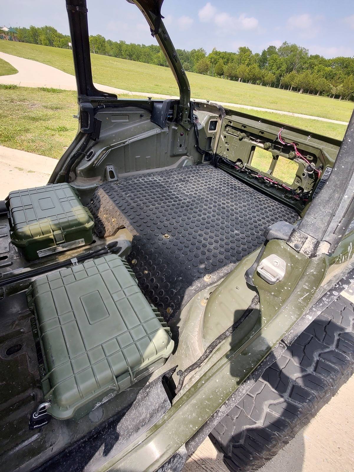

Jeep Wrangler JL First regen today. 35k miles. IMG_20240430_160916116_HDR
At this point I have the horse stall mat installed along with a aluminum sheet underneath it and it does it pretty damn good job of keeping the ammonium out of the cabin. You'd think at some point I would add a extension and a downpipe on the exhaust, but I actually have other plans for the exhaust pipe in the future. So for now, I just know enough not to die. ;) ?
