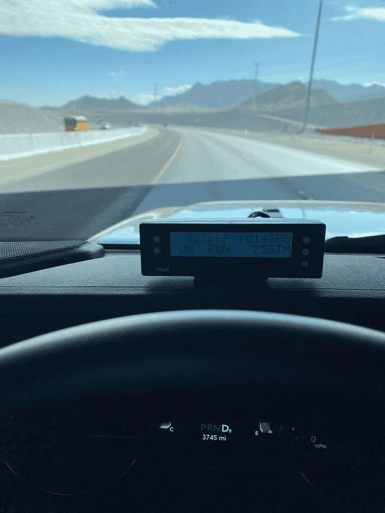

I’ve got a Banks iDash and intentionally watch soot load on long road trips. At least twice I’ve seen it get into single digits then start a regen.
I figured their programming didn’t know what to do when it hit zero and just defaulted to regen. ?
Your explanation sounds better though. Is the ~750 mile regen just an observation or did you find it documented somewhere?
My observation using Scangauge with Ecodiesel JT and JL which I had for a year each. Since I have the same route and approximately same miles every week, and mostly highway, the soot level never reached 80%. So it could be either programmed to do every certain amount of miles or it calculated by engine hours. But always between 700-750 miles in my case on two different vehicles.

Not familiar with Scangauge 3 but in Scangauge 2:
STM is for soot level in the DPF.
You can also set an X-Gauge for history of regens (TNR) - that is, how many regens it had since birth.

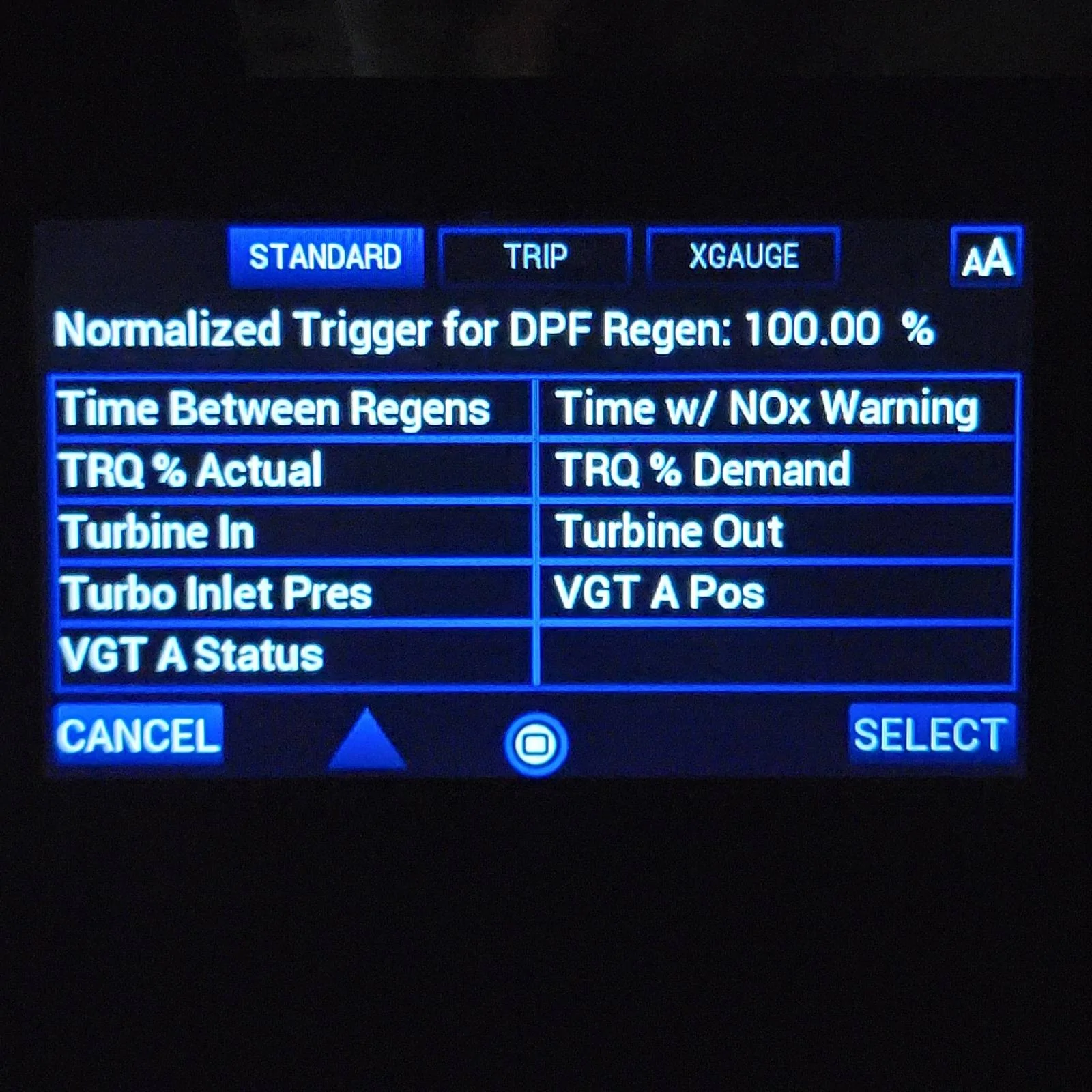

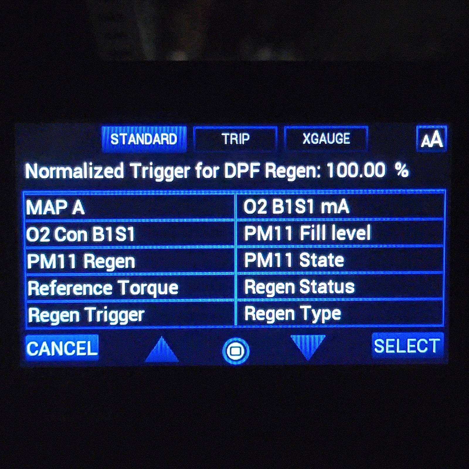

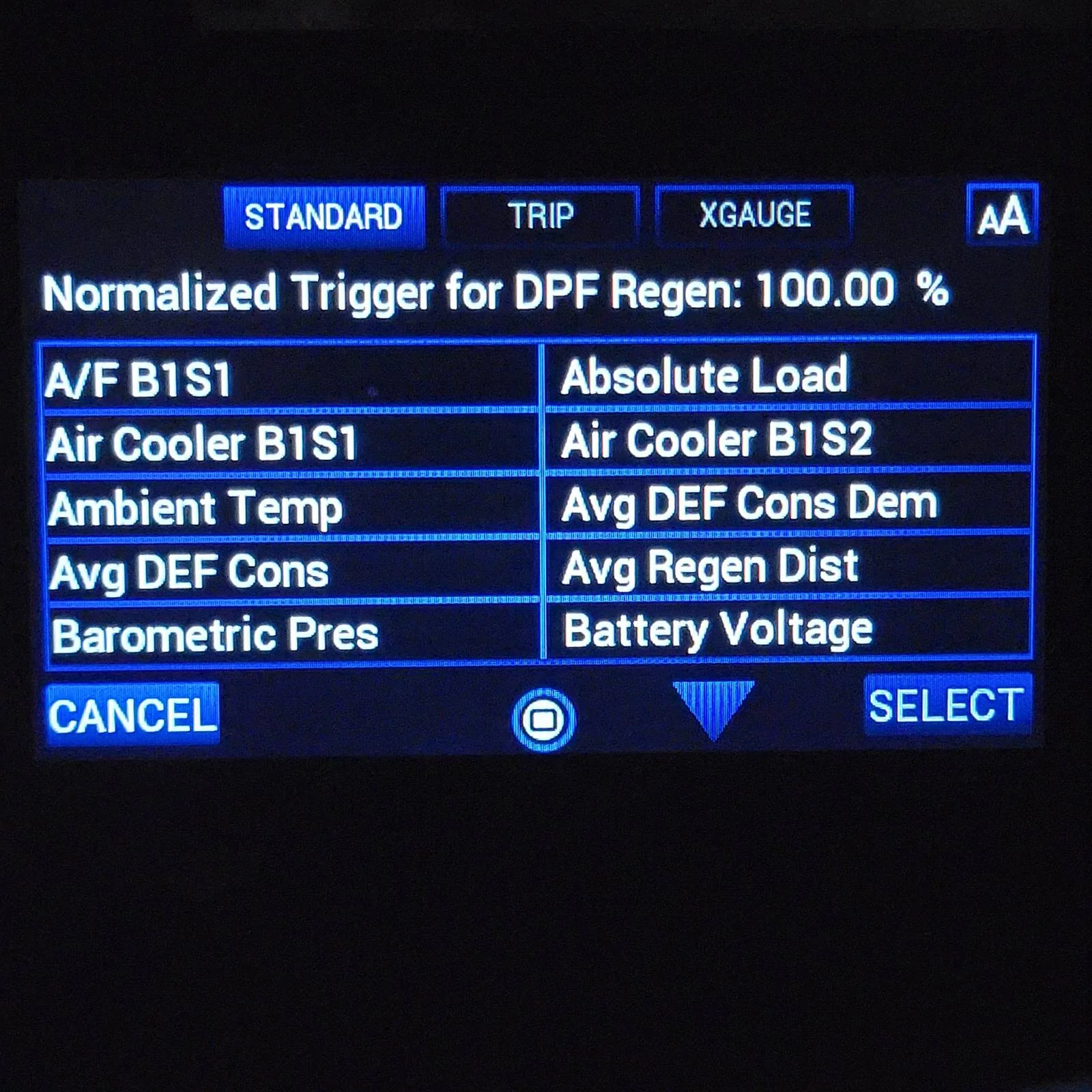

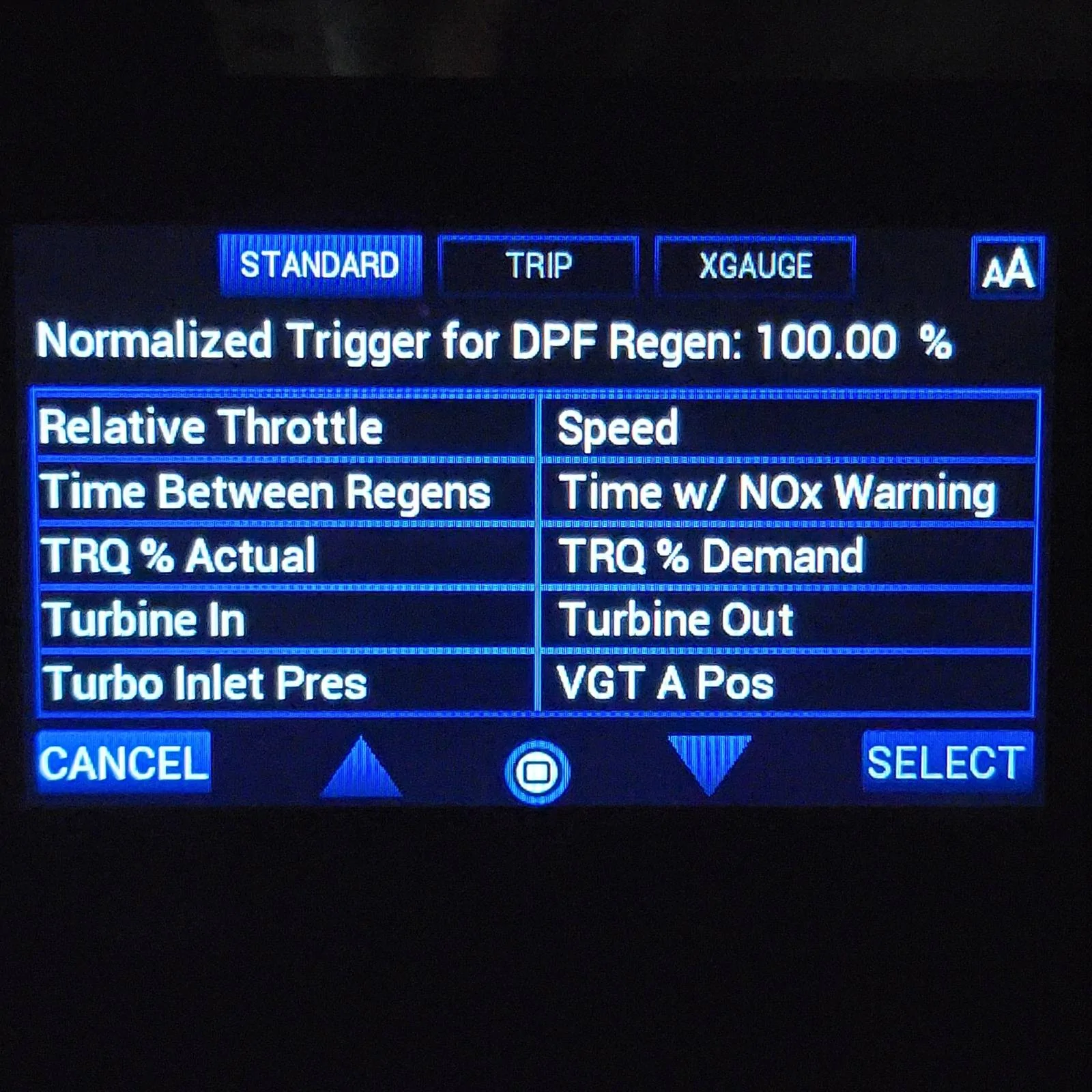

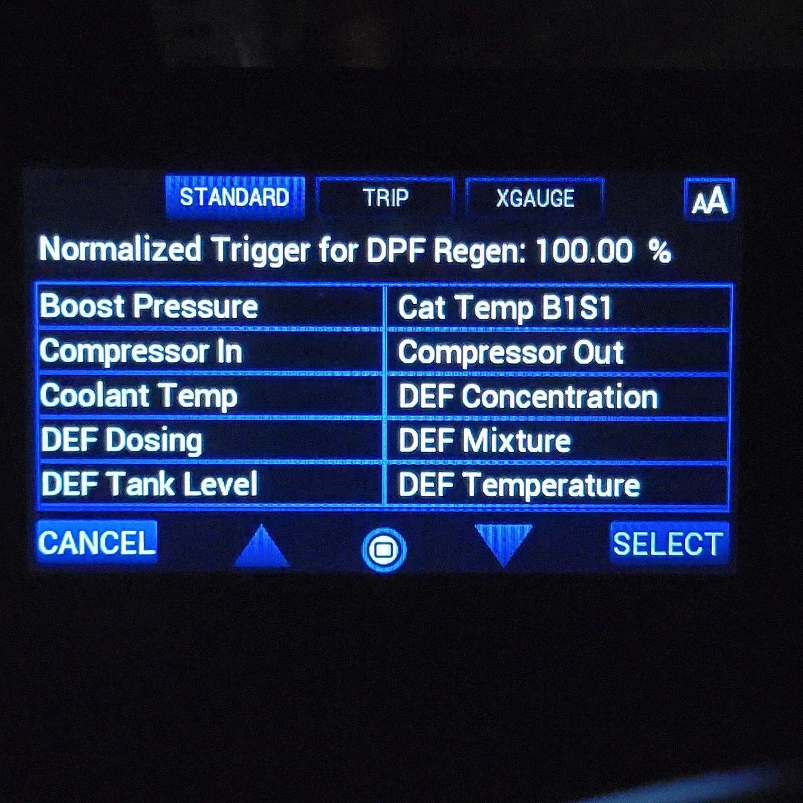

Thanks, is the dpf showing the % trying to figure the 822.
These are some of the available screens that seem to deal with the DPF. I will have to look at the X-Gauges again.
Im just not sure what all the abbreviations mean.. time for some research.

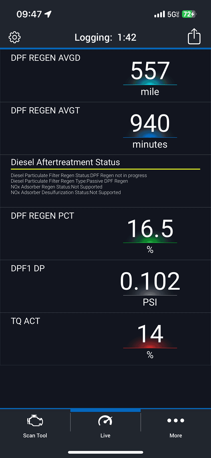

Actually forgot that I had a BlueDriver scan tool, updated and got it set up for diesel. Lots of good info on there for sure! Now I am amazed that I have never had the regen warning pop up, guess I never went more than 557 miles with out some highway miles! Now that I know I can monitor it I will keep and eye on it! Thanks to everyone for educating me on this!!!

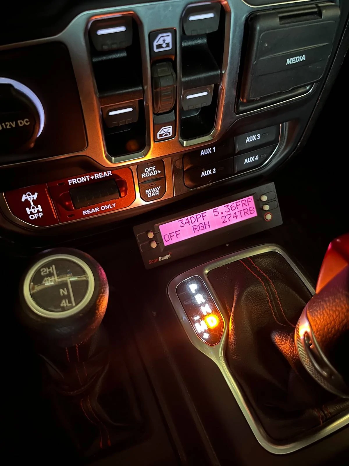

On my picture of Scangauge 2, 822F is the DPF temperature. STM or soot mass in DPF is 75%. TRB or Turbo temperature is 1014F. Turbo temperature is actually temperature of Exhaust Gas Temp 1 sensor reading which is the closest to how you gauge the turbo temp. When I shut down the Jeep, I used to make sure the TRB temp was 350F-400F. Usually it takes 30 seconds of idling to get down to below 400F before I shut the engine off to prolong the turbo life.

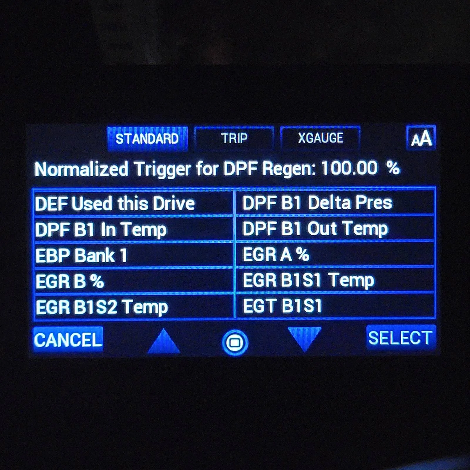

This is screen 1 on mine.
As I recall I loaded the DPF Load manually as an x gauge. Or maybe it was something else, something was missing and I only got it adding the x gauge manually.
