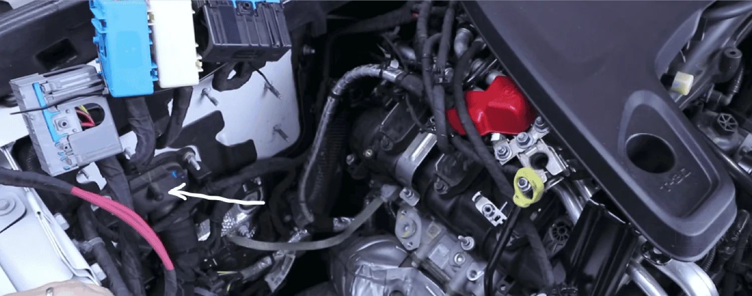

Couldn’t you route under passenger cowl, temporarily drop windshield (have friend hold it so you don’t have to pull wipers off) run wire into passenger side under trim then down to floor trim and then back?
this is how sPod reccos running into jeep. They have an install video I think. Couldn’t the same method be done on passenger side?

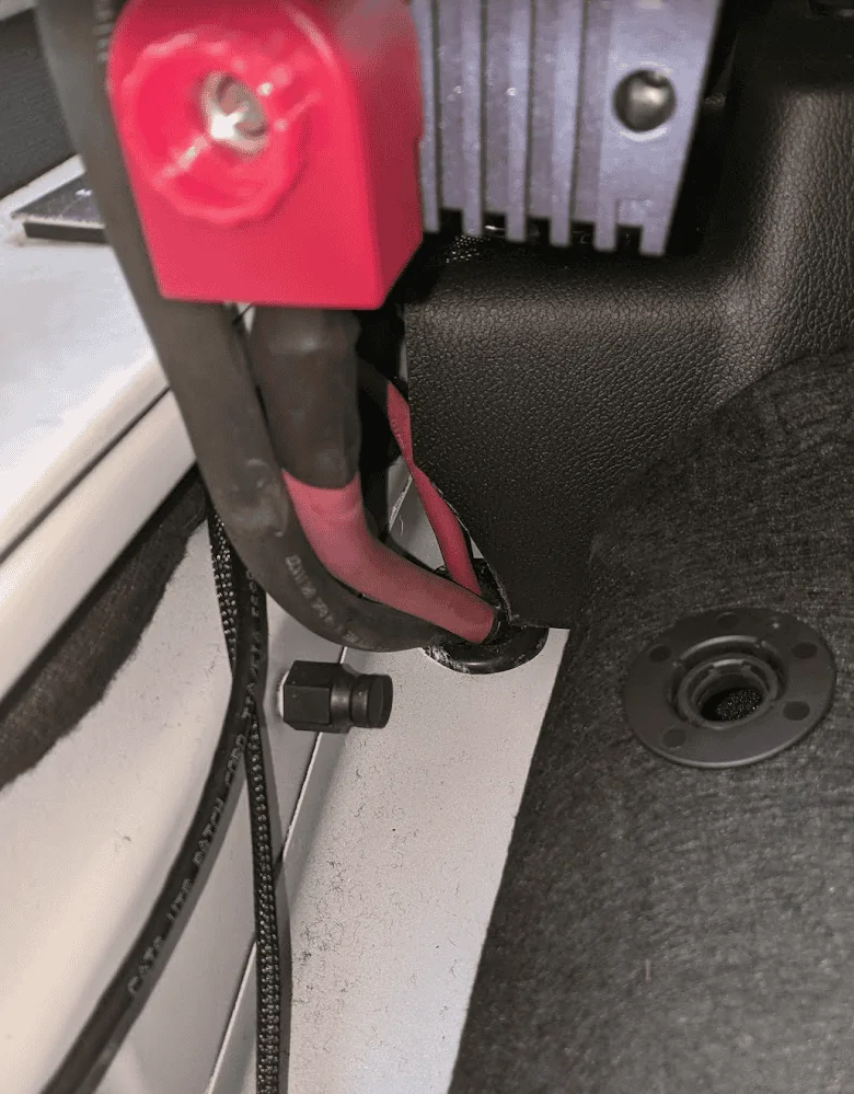

Here's a pic where I run large conductors through the top of the wheel well to feed an inverter:
Jeep Wrangler JL Firewall wiring: driver vs. passenger side? 1654187917768

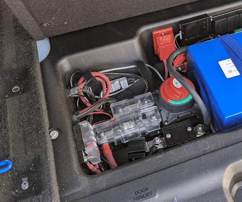

And here's what the cable glands look like from the inside of the cubby (left side):
Jeep Wrangler JL Firewall wiring: driver vs. passenger side? 1654188040379

Thanks for this. Very similar to my project so I am impressed with your approach of routing the cables in the fender well so they don't come across on top of the cubby.
I am going to be installing American Adventure Labs' M.A.S.S. platform on top of the rear floor once I'm done with this auxiliary battery install. My impression is that this platform will be elevated a bit above where the OEM floor & hook strips used to be, so my inclination was just to come into the cubby from above. But would you twist my arm into trying this more discrete route? Not sure what kind of cable gland I would need for the cubby or whether there are any other tricks here that I would need to worry about (e.g. rear fender liner finagling, etc.). Thanks!
To add: I am also using AAL's remote bracket that mounts above the rear driver's side wheel well to include things like remote compressor access, a fuse box, and the like. This probably makes it even more complex to hide all of this and run lines between the cubby and that bracket behind the fender liner & out of sight.
I do this for small cables like an antenna or signal wires from my switches, but would not run power. It is too big, and has the potential to cause noise through induction to the tweeter.

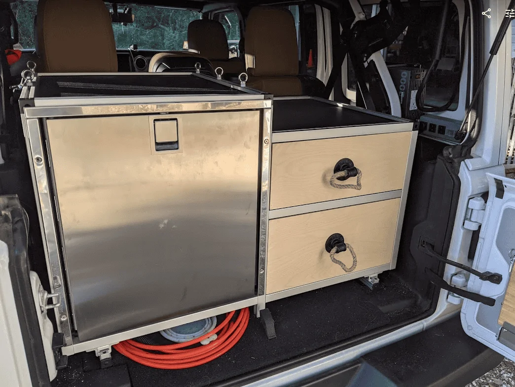

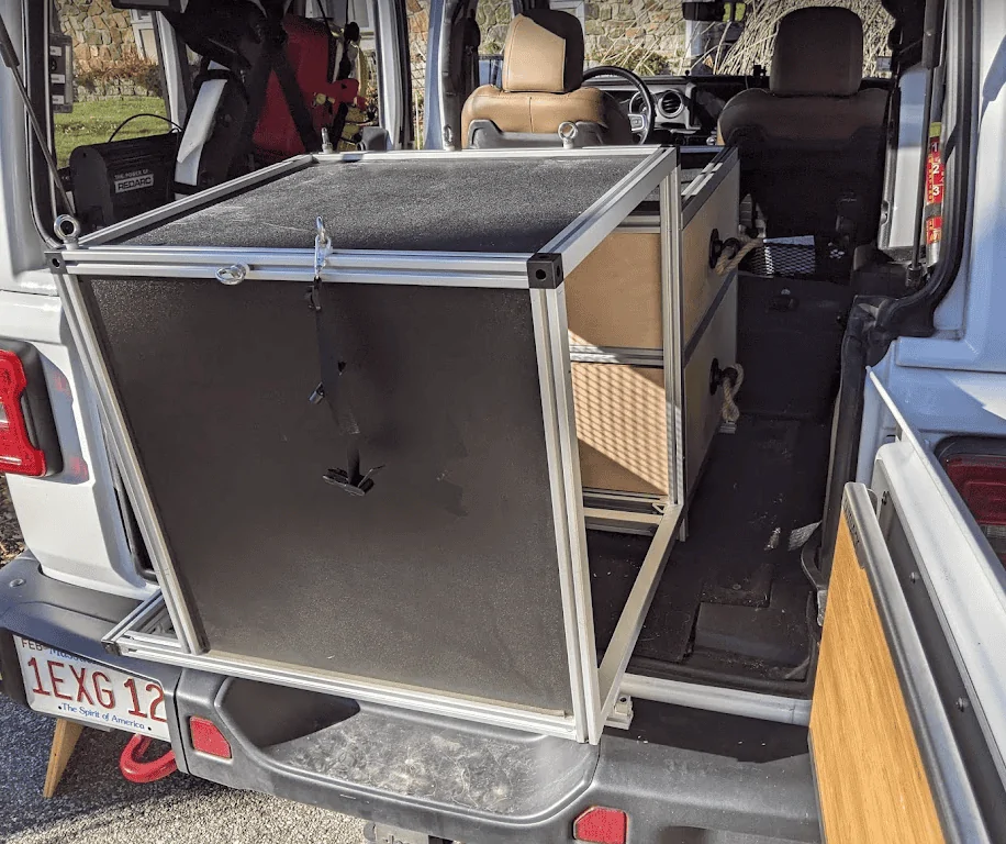

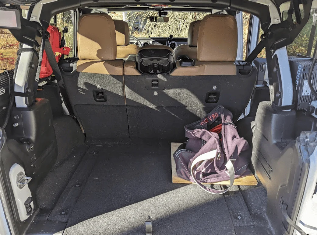

I have a storage system I built in the back of mine with some 80/20 extrusions but it comes out in the winter and so my motivation was keeping the cargo area uncluttered so my wife doesn't have to deal with avoiding putting stuff 'on the wires'.
Just let me know if you have any questions, looks like very similar build concepts!
