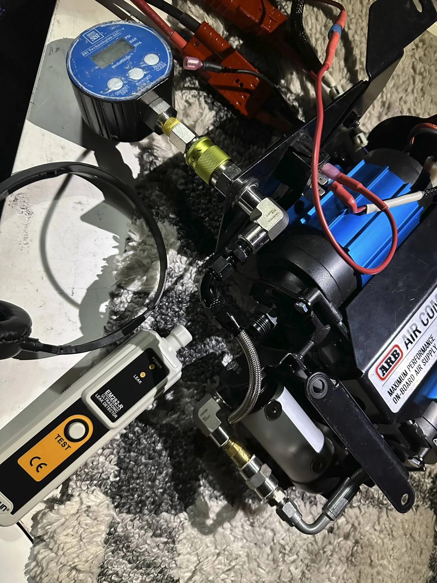

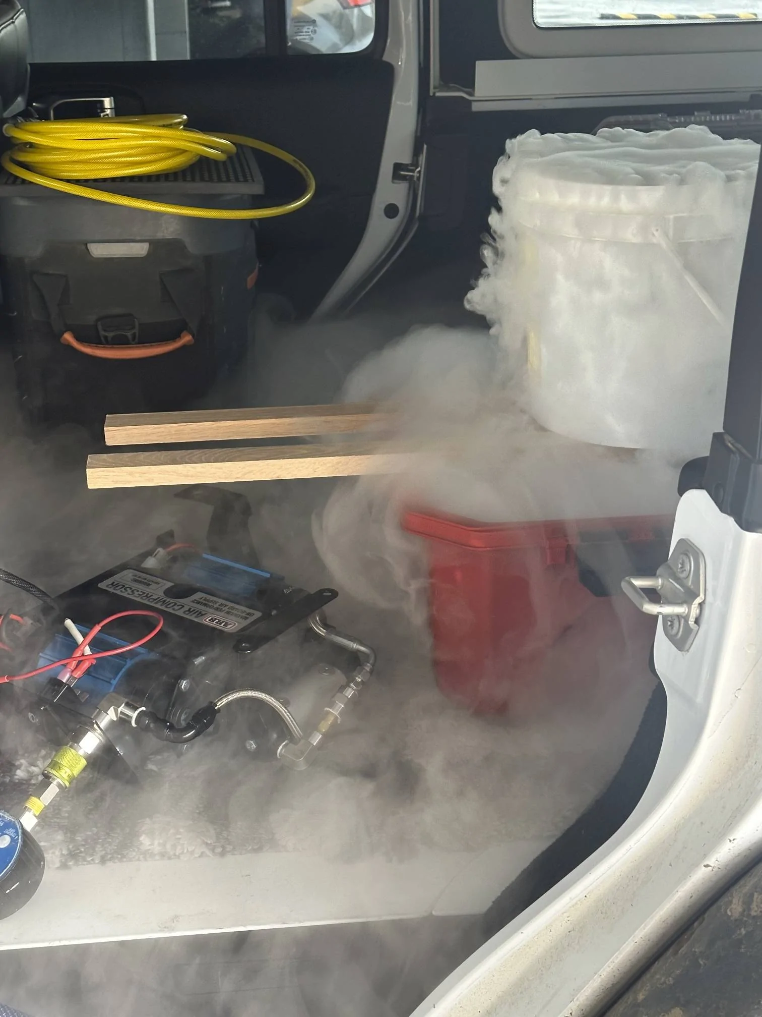

Any advice on how to find a small air leak?
Ive tried soapy water, an incense stick, dry ice, and a $50 Chinese ultrasonic leak detector.
None of the above have been able to find the leak.
When I pressurize the system and plug in a digital pressure gauge, I still see the pressure slowly dropping.
There's a check valve installed so the air shouldn't be going back into the compressor.

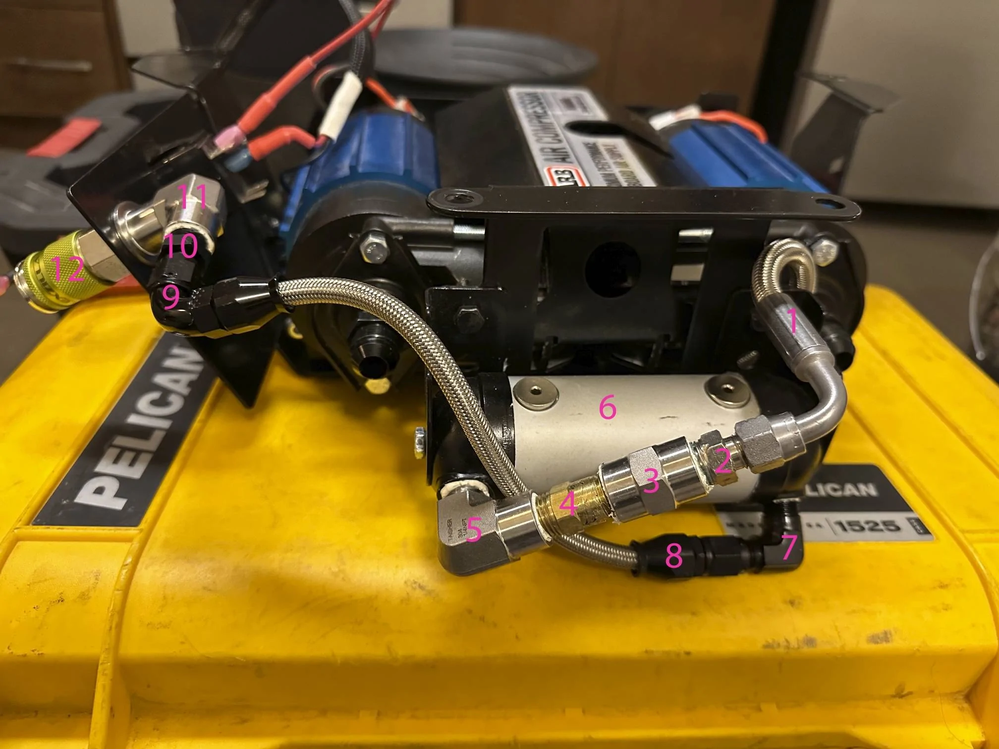

It should not be backflowing through the compressor, I am using a one way check valve (#4 in the pic below)
The leak is somewhere between #4 and #12
Yes it will kick back on after a couple hours. What I do verify is attach a digital pressure gauge to #12 in the photo. Its slow but you can see the pressure going down.

Kicks back on "after a couple of hours?" That is one tiny leak. Your expectations may be too high.
Also, you have an awful lot of faith in that backflow preventer valve. Seems to me that it's just as likely to be bleeding this miniuscule amount of air as anything else you've shown us in the system.

I would isolate pump and all the valves first, verify that whole system does not leak back.
I have a HF pressure gauge looks like yours, i know that leaks a little, and I know quick disconnect fittings leak.

I did not consider the possibility of the gauge leaking.
I get it that tires are quick and done but I intend to install other components that would use compressed air. Some I assume very little, others not so much.
I don’t have a storage tank installed yet, but my goal is if I filled a 2 gallon tank up to 150 PSI, I could leave it sit and come back a week later and it’s still at 130 or better. Is that an unrealistic expectation?
