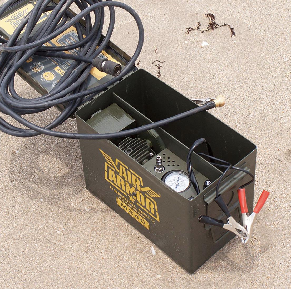

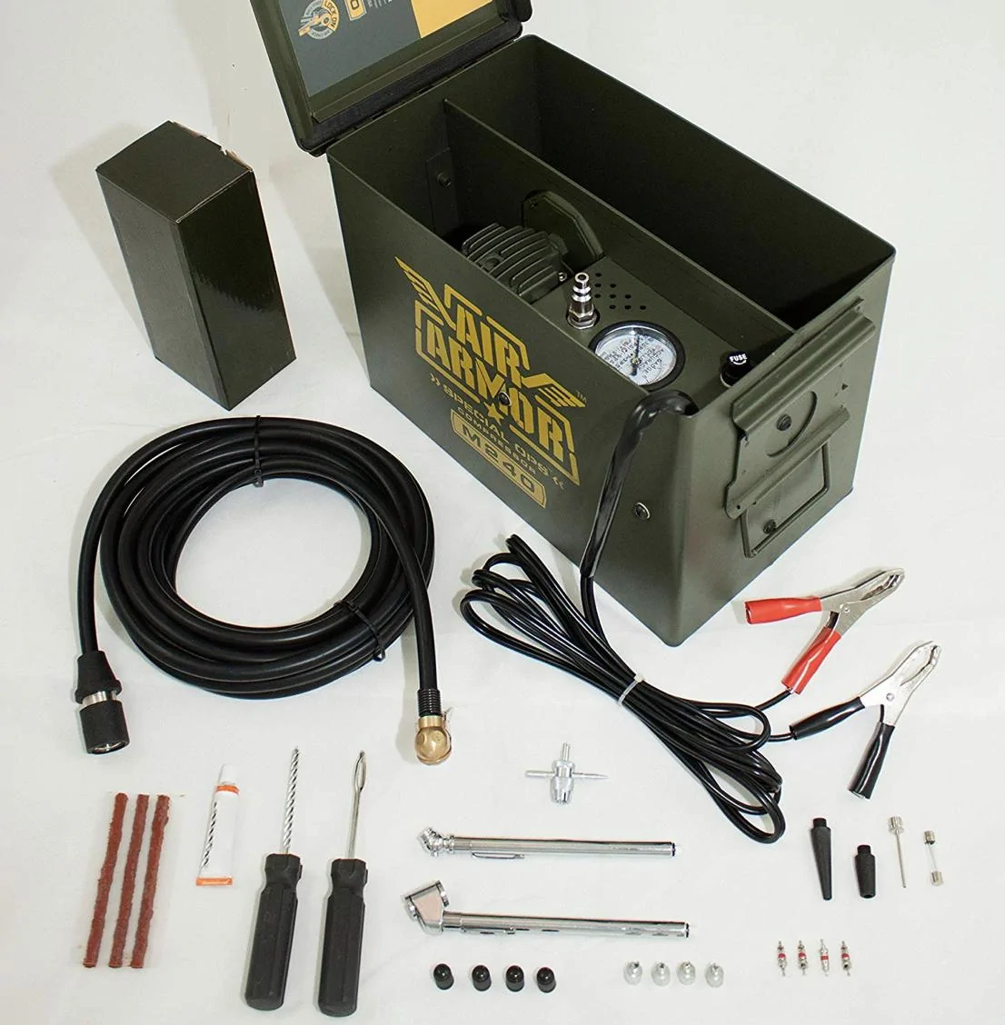

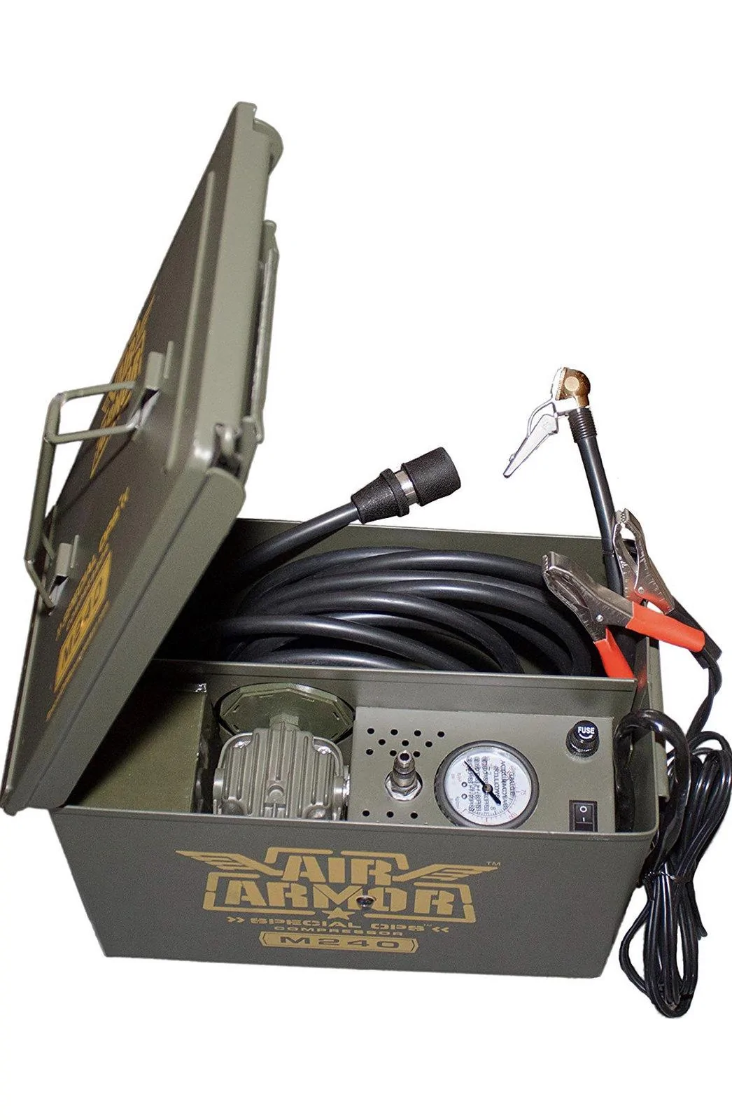

That looks like a modified and dressed up MV-50. Which happens to be THE best compressor under $500. Super cheap and great performance. I would just buy this version and you’ll love me forever.
https://www.ebay.com/p/1142310155

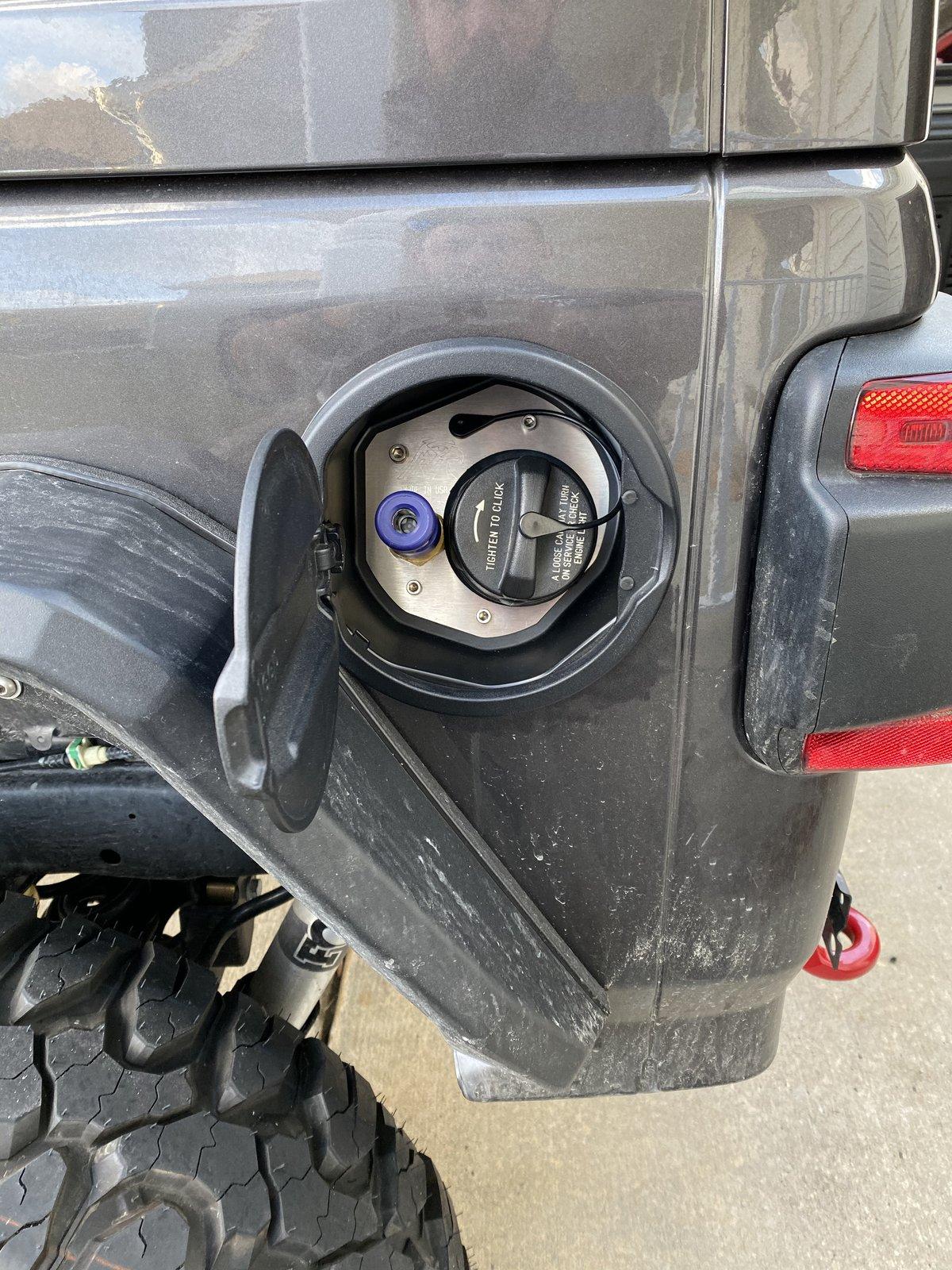

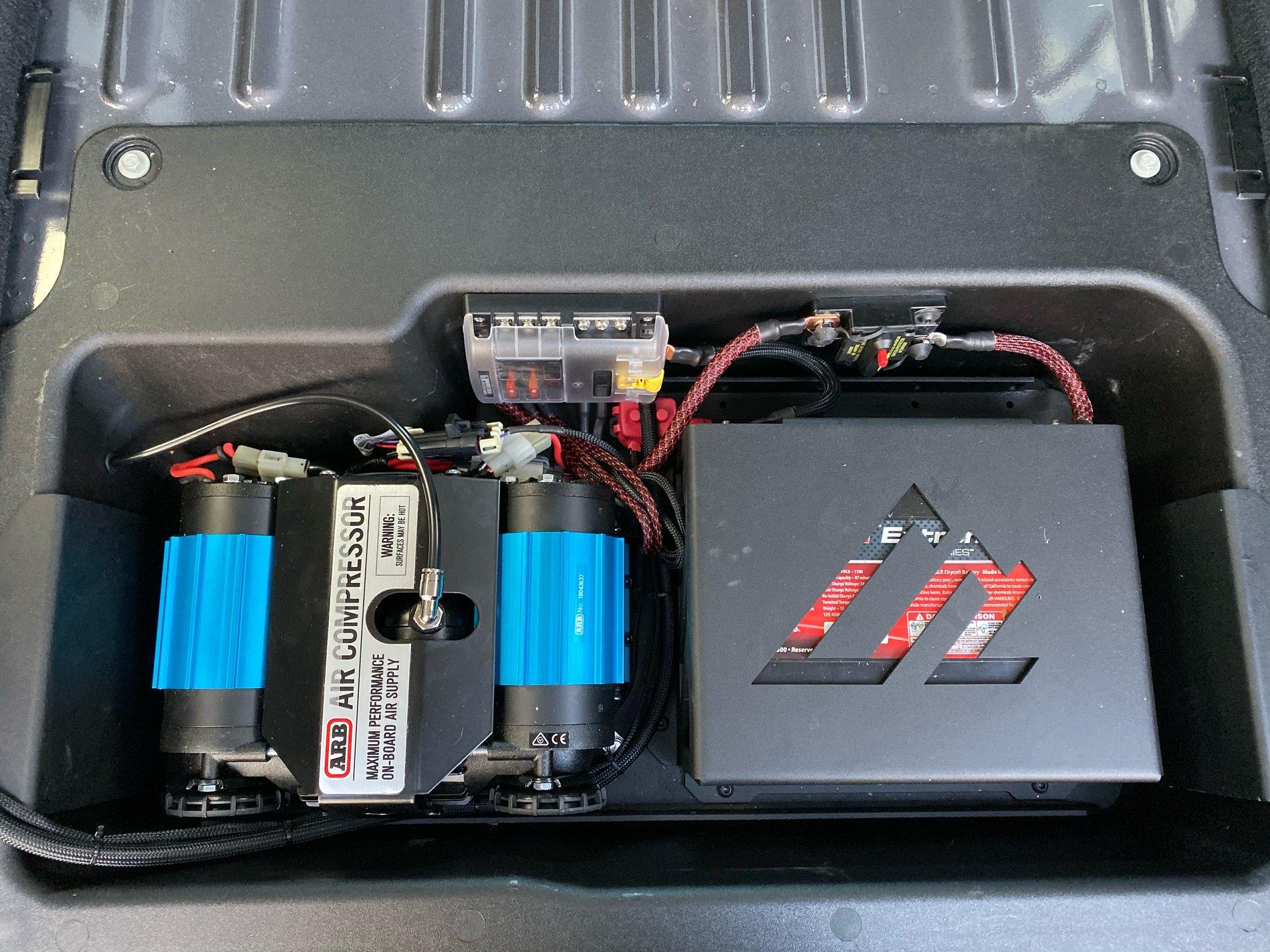

Just completed this install
After a couple minutes of use, the air coming out of the compressor is very hot. You're likely to melt that line where it comes off the compressor. Ideally, you should at least have the first foot or so to be a braided stainless steel line, or some other line that can resist high temperatures.

I went this route. Kinda pain to run the power wire but for me it’s the best place. I got it really hot the other day and it’s just fine. No issues with heat and gets fresh air. Obviously, I keep the cover open while in use. I aired up my neighbors Super Duty tires from 40 psi to 80. Took like maybe 8-10 minute for all 4. These things are super fast , but the downside is the expense.
Much better than under the hood. I had it under the hood of my JK and talk about heat soaking before even using it.
Any installation instructions to follow? :)

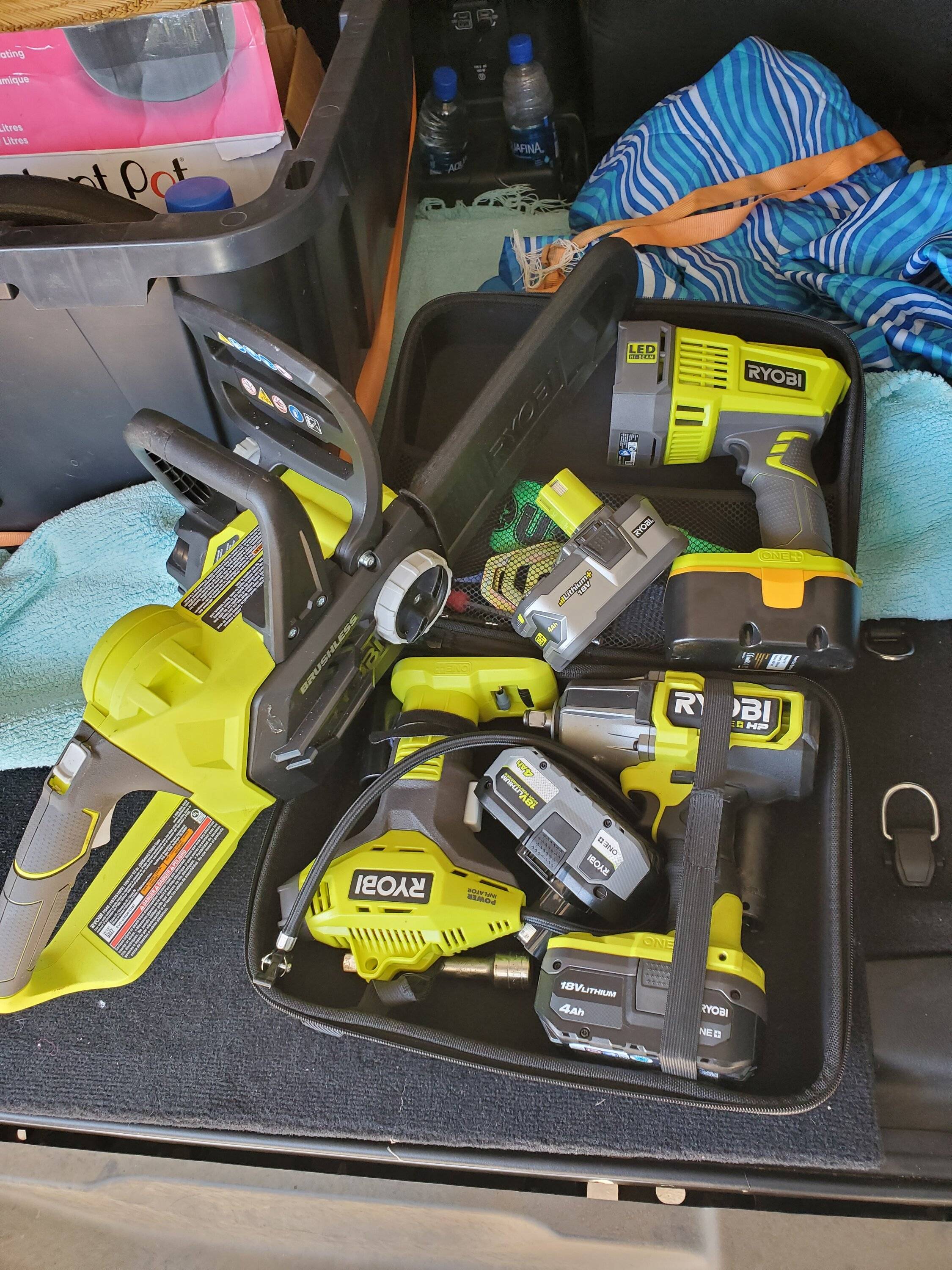

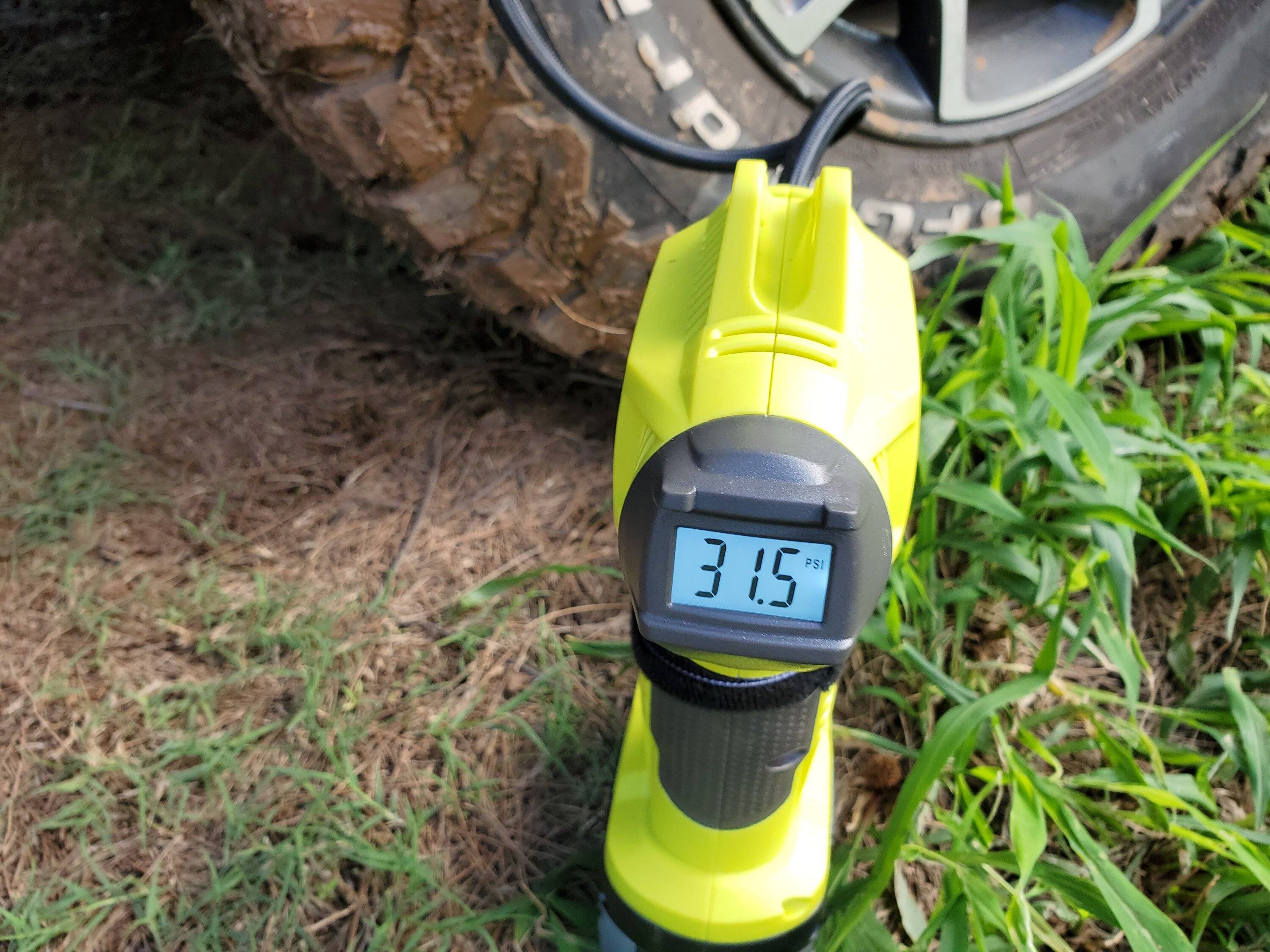

This from a Viair engineer in response to my question:
Why is the CFM so much lower than the much cheaper Viair 00088 88P Portable Air Compressor? 1.47CFM Free Flow @ 0 PSI.Max. Amp Draw: 20
Ricky E: we dont list parts on amazon but we will try and reach out to the seller and have them fix that info.
Ricky E: the 450p rv is a 100% duty cycle compressor. the 88p is a 33% duty cycle compressor. the 450p rv auto will take a little longer to get to the desired psi, but can run longer once there. the 88p will get to the desired psi but wont be able to run as long. same concept for the 400p compared to the 450p rv automatic
Until I get my ARB twin, I'm using a quad Ryobi (4 compressors).

I overheated my ryobi inflater like that. Now it no work. I replaced it with the smittybilt.

What pressure? How many tires? What size battery? If the battery is not a voltage source, that is, it voltage drop, current goes up. That's one way to burn up an electric motor. I've noticed with mine, the best 4 Ah batteries inflate 20% faster than the cheaper Ryobi 18 V 4Ah battery. I've used mine at least once a week for a year with no failures yet.
