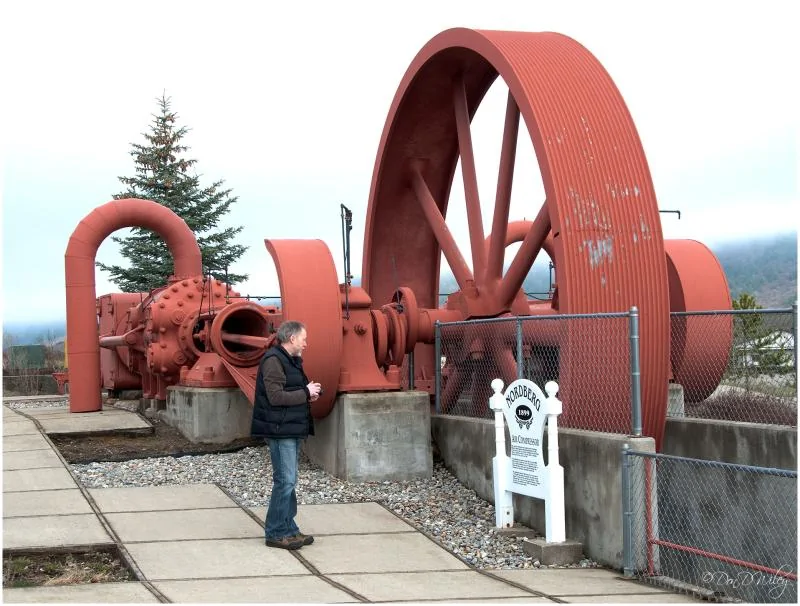

For a fast re fill,, Powertank. It will even re-seat a bead. No wires, easily portable, no real moving parts. Yes, you have to get it refilled with CO2.
Didn't you see Jaws when they shot the scuba tank? Shark guts everywhere.
My new compressor is much faster and safer.

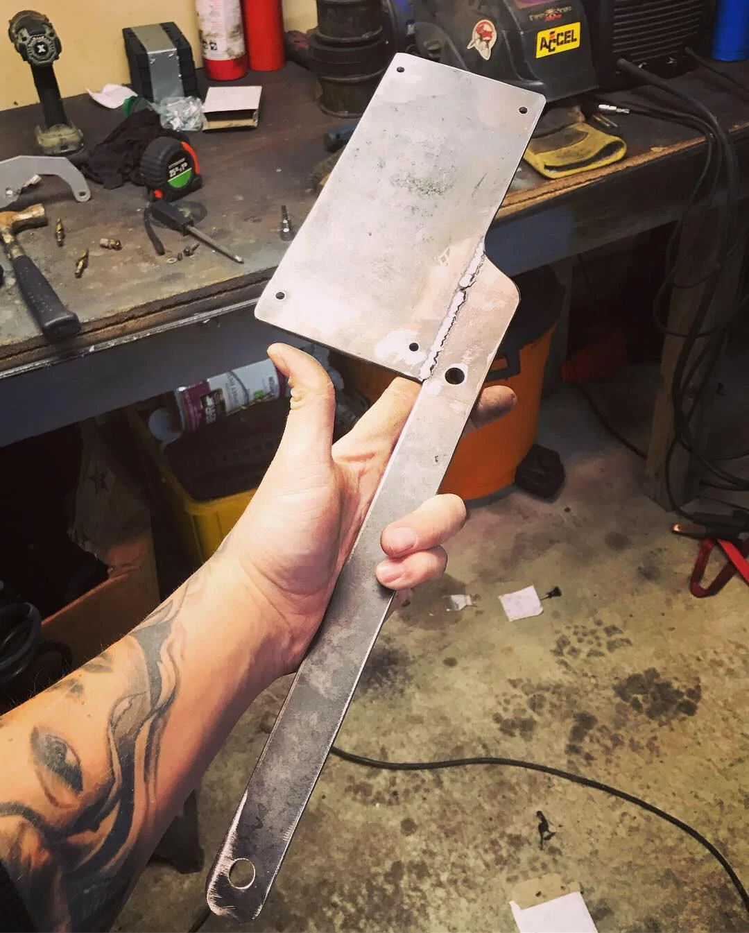

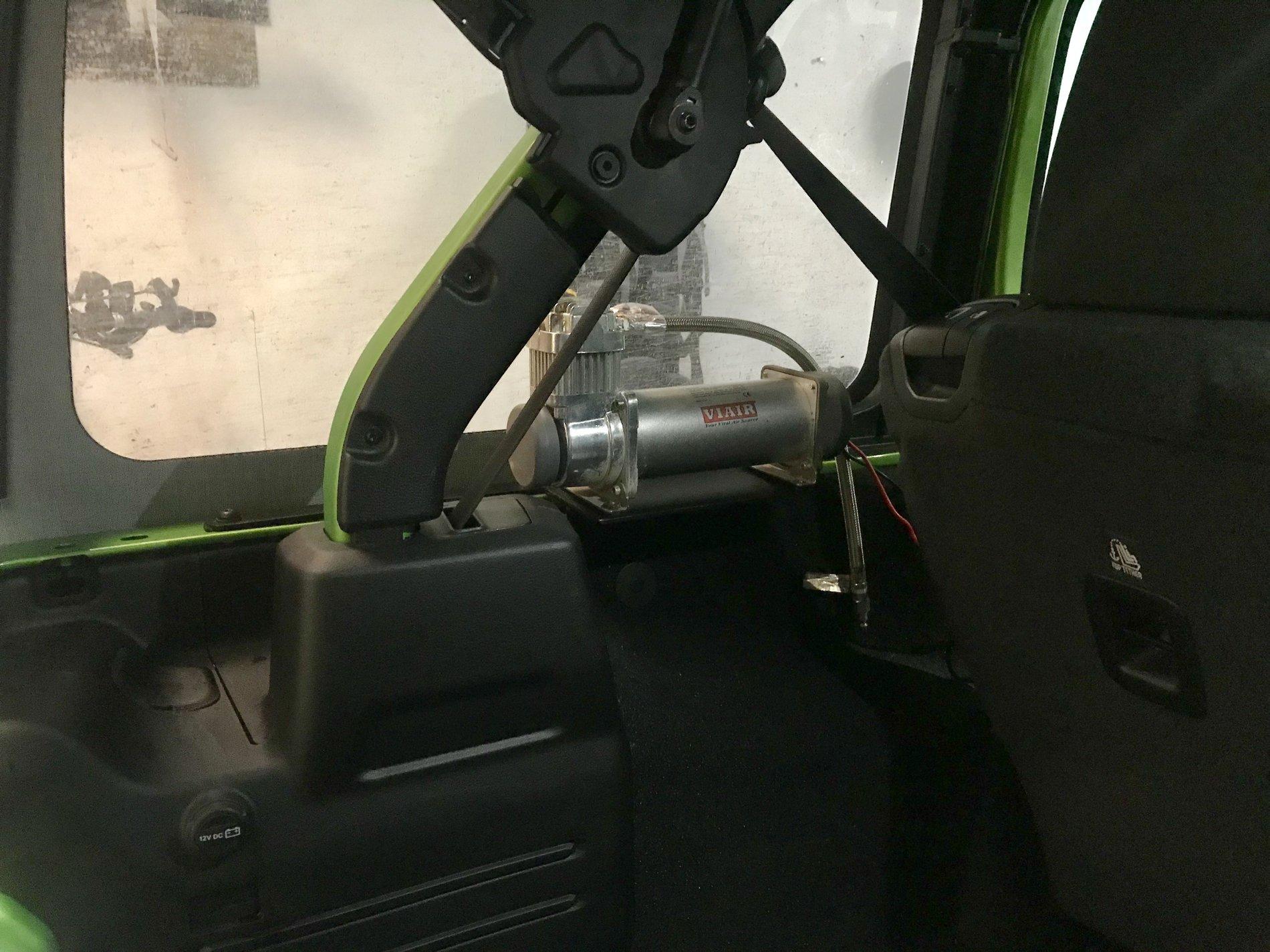

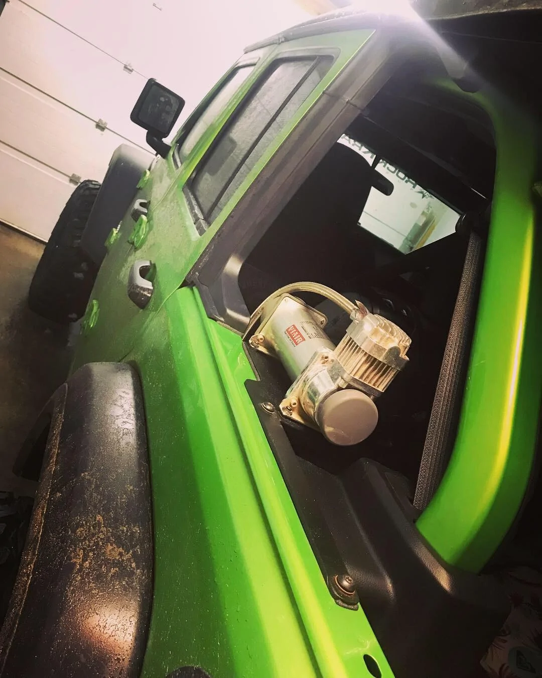

Made up a little bracket for my 450H. Had the pump mounted under the hood of my JK and worked very well. It’s only 1.8 cfm but at 100% duty cycle. I made a 4 tire inflation hose and will inflate my 35’s from 10 to 34 in about 12-13 minutes

I've been contemplating doing something similar to what you did on my junk in that same location. My only concern would be the tub supporting that much leveraged weight (figure most are around 10-12lbs) without any vertical support underneath the bracket to the wheel well hump.
Have you noticed any issues with it bouncing around or the tub flexing as you're rolling down the road with that set up?

I was concerned with that too, but so far so good. The tub definitely seems stronger than the JK along the rail, and there is also a anchor point for the carpet underneath the pump I could tie into if need be
I don’t hear it at all and haven’t seen any signs of movement. Maybe on my days off I’ll mount the GoPro back there and go for a drive see if it moves at all
