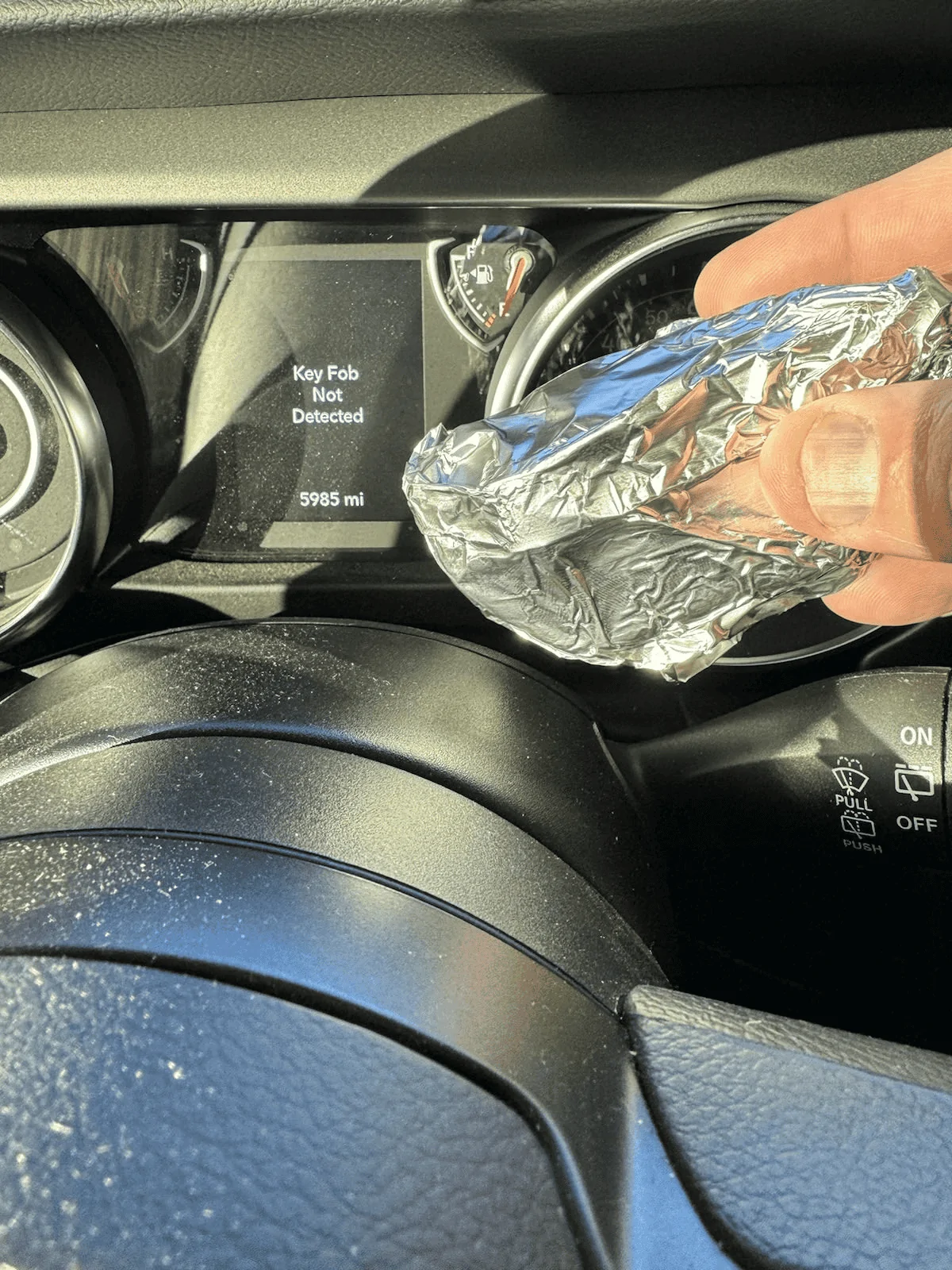

We tested two different Faraday containers over the weekend. They were a wallet and a purse my wife had purchased. We put her key fob in either of them and closed them up tight. Then we tried to start her Jeep with her key fob inside the vehicle, but inside the Faraday container. The Jeep started right up with both of them. Then we wrapped her Key fob in aluminum foil and tried again. The Jeep wouldn't start with the key fob wrapped in aluminum foil. The dash displayed "Key fob not in vehicle" when she tried to start it.
So, be sure and test the Faraday container you buy. Just because it says it is a Faraday container doesn't mean it actually works. I suspect there are a fair amount of scam artist selling "Faraday containers".

This is not rocket science. Stop paying for bags on Amazon that don't even work. Put your key in a METAL box, or even tin foil. (see below) Even an Altoids box works. It's not magic. Metal blocks the signal.
Jeep Wrangler JL Faraday Box, for the Key Fobs 1699908151059
Jeep Wrangler JL Faraday Box, for the Key Fobs 1699908211001
