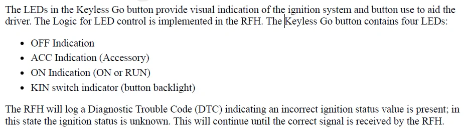

Any DTC's
Jeep Wrangler JL Key FOBs not present 1757167068253-lh
Roadkingfl
Dec 18, 2023
2024 Wrangler Sport S
No DTCs. I between the selections on the keyless go button using the FOB, not without it.
