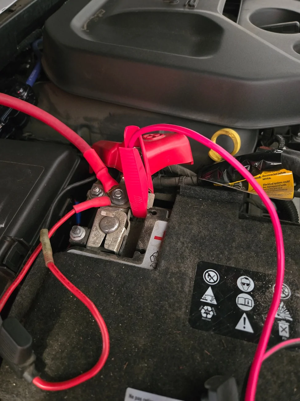

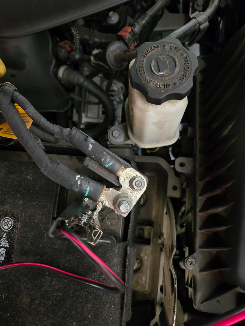

Ok, the auxiliary battery sits under the the fuse box, correct? OK, I just saw the aux battery is there for the auto start/stop, I definitely do then.
I'll take a pic of terminal when I can and post.
Yes most easily and safely accessible through the passenger side inner fender liner.

OK, that sounds good. I'd hate have to remove the fuse box.
Thank you.

FFS Disable the aux battery - it takes sub 5 mins and the procedure is all over this forum - and see if that helps the problem. If not you have still done yourself a favor by getting rid of the aux battery which will fail on you and will drag your main battery down with it .
