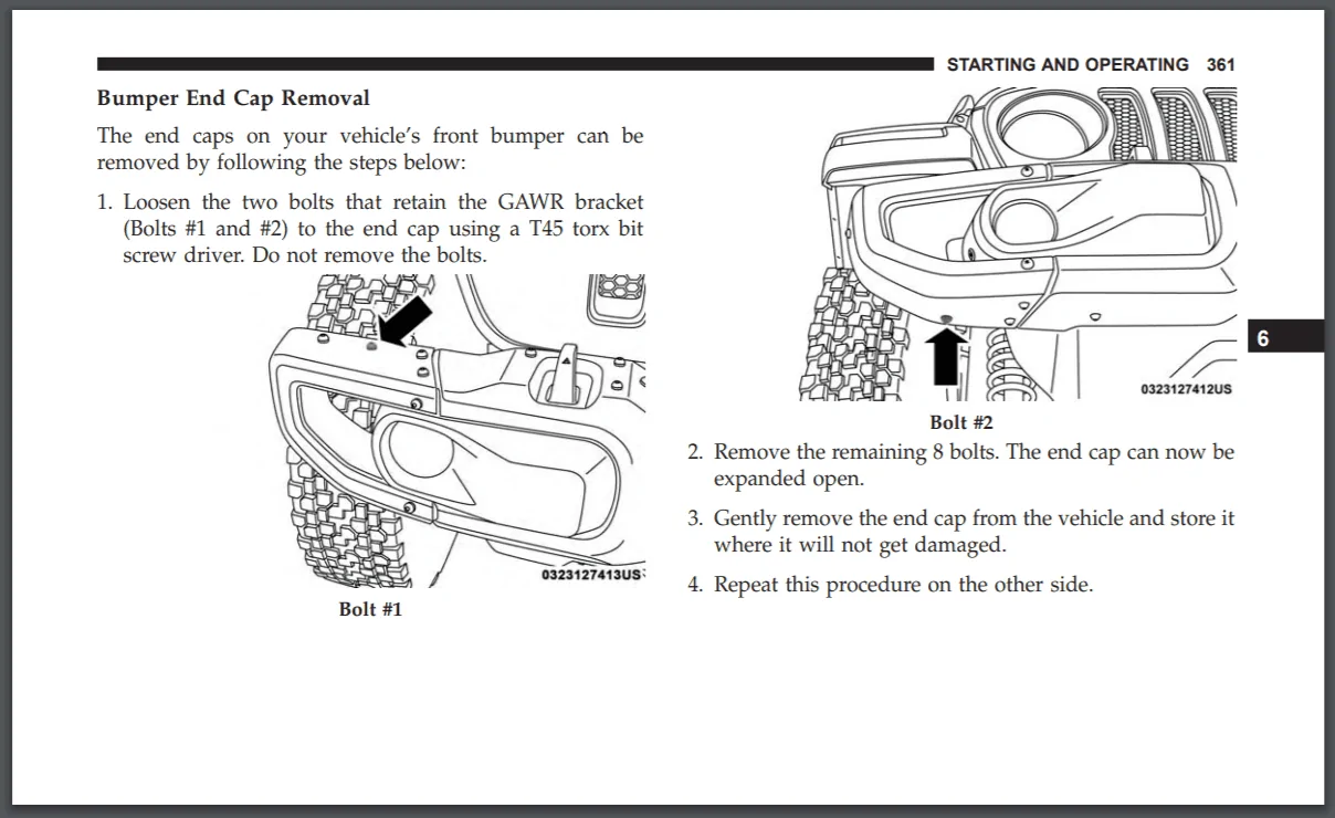

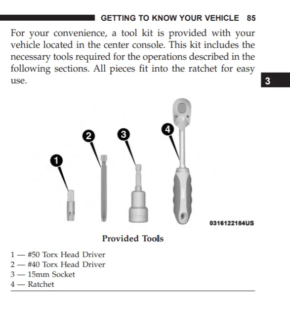

That's silly. Find another dealer. That's like saying, freedom tops are only to be removed by the dealer. Those end caps are meant to be removed by the owner. That's why they used the same size bolts that fit the INCLUDED tool kit.
Not trying to be "that person", but just a cautionary note that the supplied tool kit does not come with the necessary size torx bit to remove the end caps. I am only bringing it up because I did try to remove my end caps (without reading the manual ... because who reads the manual) with the supplied tool kit and stripped one of the bolts ... which was super fun to rectify.
The end caps require a T45 and the tool kit comes with T40 and T50.

that’s strange. I’ve removed mine multiple times with the bit from my tool kit and I don’t remember it not fitting correctly. I’ll check again tonight. Now I gotta know.

And as tight as the bumper bolts are I wouldn't use that little ratchet.

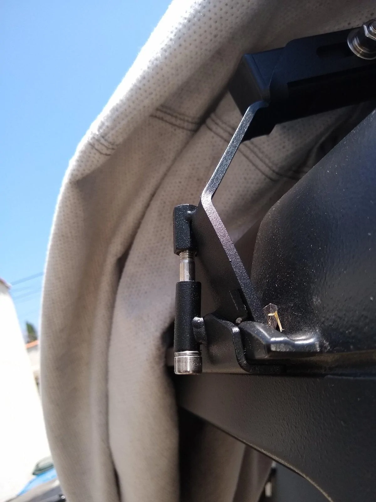

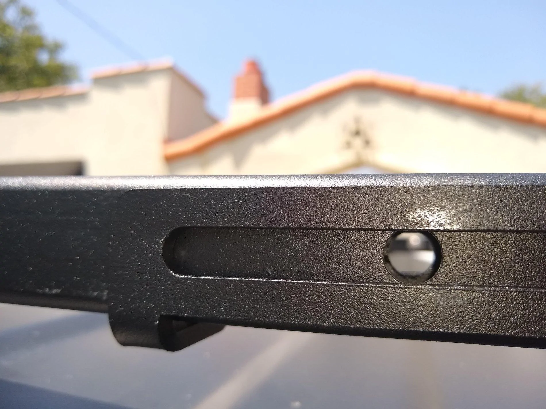

So the bolts that connect hardtop brackets to the bars. there is very small if any clearance between the hole in the bar and bracket. I think what happened is that the thread of one of my bolts was touching the bar which is made of harder steel, so it ruined the thread. When I went to pull out the bolt I couldn't. It only happened to one though. So you have to be very careful when puting the bolts in or out and make 100% sure they do not touch the rack bars. Is there a proper direction to install them? lol
I am more worried about the small lower bracket with the angled screw. That screw did not go in effortlesly, I do not want to touch that. I was very careful when installing those cause I noticed the design is just a recipe for disaster if those are not aligned. I was less careful about the other ones.
I was intending to use this with top off sometimes, but I think I am gonna pass and just leave it on the hardtop.
These I am more worried about

I used the factory bit with a bigger ratchet. That little one wasn’t even enough to break them loose originally.

Yes, I had the same problem but I did not strip the bolts, and the side pieces were a little hard to screw in as you mentioned. As far as the "right "way, I'm not sure but the picture pictured the bolt head towards the front of the Jeep. So I changed them, its a better look anyway.

I just removed my end caps last night and several of the bolts were incredibly difficult. Someone several posts up did post images about loosening bolts 1&2... I was unaware because of course I didn’t read the manual.. wondering if that would have somehow made the tight bolts easier?
