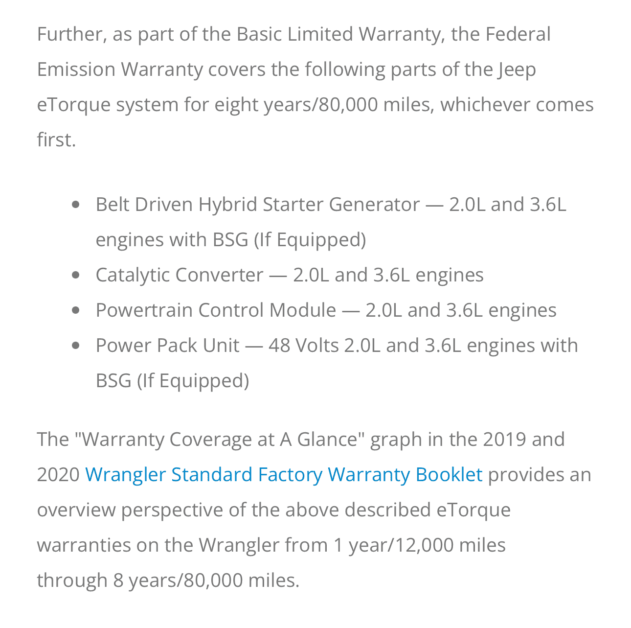

eTorque has an 8/80k warranty. Dealer shouldn’t be charging you jack shit to diagnose it.
That would be great! Where did you read that? I can't find any mention of eTorque-specific coverage at mopar.com.

Thanks ... but that link doesn't work because you took a screenshot of it. I ended up finding this coverage myself in the "Warranty - Gas" booklet at the Mopar.com site. It's great to know that I have warranty time left here, so I'll get in touch with the dealer if I can't diagnose the issue myself.
