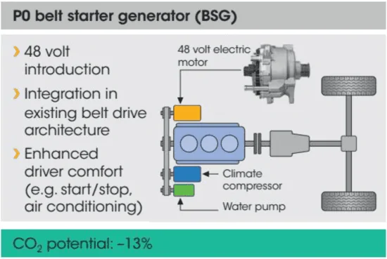

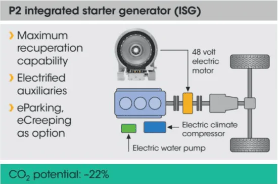

BTW, the reason it’s a BSG and not just an MGU is because it also takes care of re-starting duties (S-tarter portion) and is (B-elt driven), an MGU doesn’t necessarily re-start a combustion engine, it may be pure electric, and obviously there are other micro/mild/etc hybrids that do not use belts and are instead intergrated at the wheel or in the transmission for examples.
