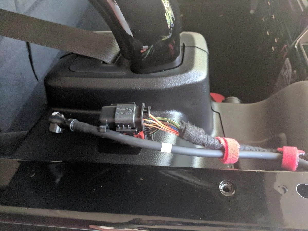

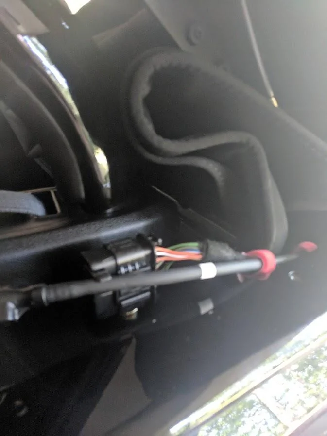

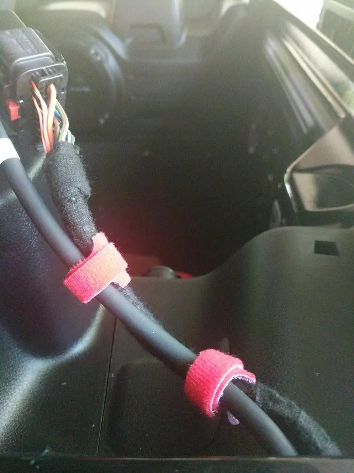

Not a perfect solution but it works for now.
Wrapped the cables together with velcro straps

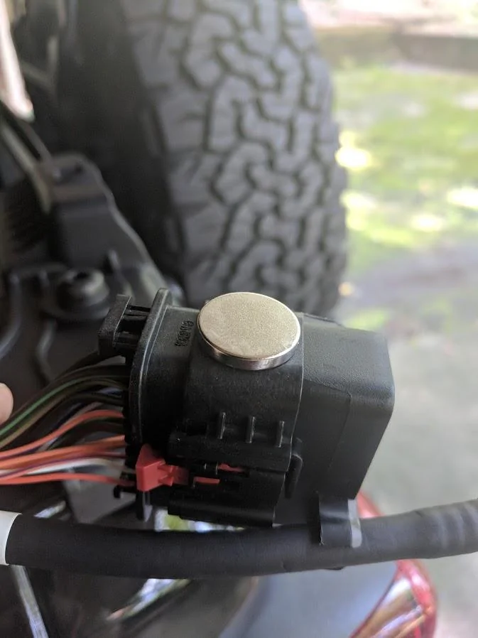

Added a drop of superglue and a neodymium magnet (Home Depot) to the harness
Jeep Wrangler JL Dual Top Design FLAW IMG_20180623_111347
Stuck a metal plate from a generic magnetic cellphone mount to the molding. Probably something steel would have been better.
Jeep Wrangler JL Dual Top Design FLAW IMG_20180623_111417
Stuck magnet to metal.
Jeep Wrangler JL Dual Top Design FLAW IMG_20180623_111426
Jeep Wrangler JL Dual Top Design FLAW IMG_20180623_111501
