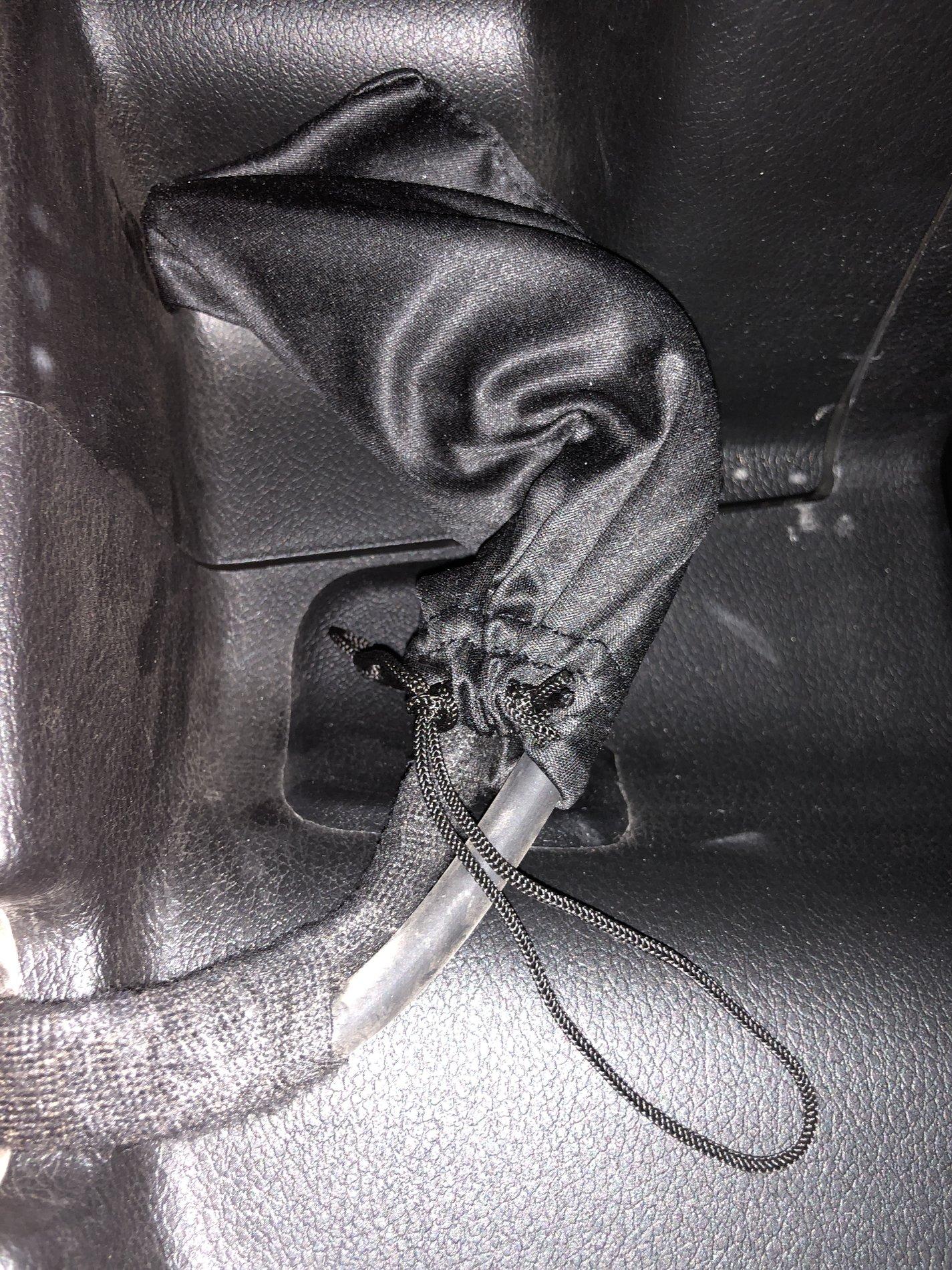

Found a solution to not damage my top and not scratch up the back.
A sunglasses case with drawstrings.
Thank you for posting. This is good stuff. Going to look for something like this for mine as well.
Genius man. I have done the same thing after switching tops and am thankful for seeing this.
