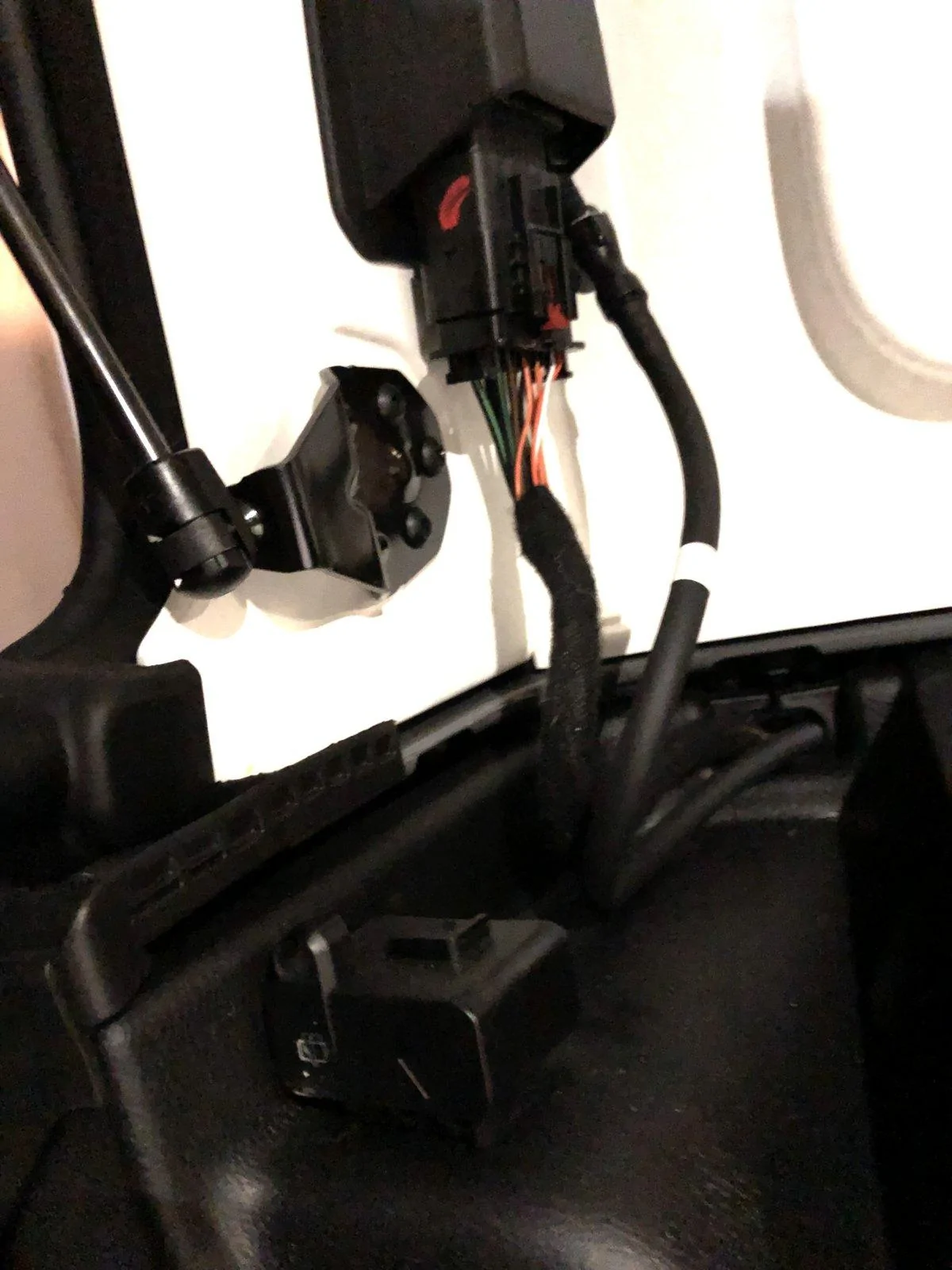

After swapping the hard top for the soft top I noticed a design flaw. The little holder for the hard top wire harness and washer fluid line completely obstructs the top from being able to lift up. In fact one of the tabs broke off of mine when I was trying to lift it. Whether mine is broke or not it cannot be there to operate the soft top. It's a hole in my Wrangler that can take on water now. I don't like that.
I suppose Jeep could say that I need to remove it and place it back each time I put the top up or own. Either way, I think someone owes me a new clip.
I'll update with pictures tomorrow.
He is absolutely right mine does the exact same thing! I was able to carefully unsnap it in order to raise my soft top, and then snap the clip back in. But I can tell by the quality of the retainer it will only be capable of doing that once or twice more. I, also broke the female clip located at the rear of the hardtop when I unsnapped it. I will talk to Jeep about both issues when I take it in someday soon.

That would be great. The issue arises after you put the soft top down. When you lift it back up it gets caught under the plastic connector you plugged in to store the hardtop wire assembly.

You should have put the word addressed in sarcastic air-quotes. They definitely "addressed" it by telling you to make sure it's not tangled before lifting it.
My little plastic piece broke and I still have not been able to get a replacement. Dealership says they can't order that piece by itself.
